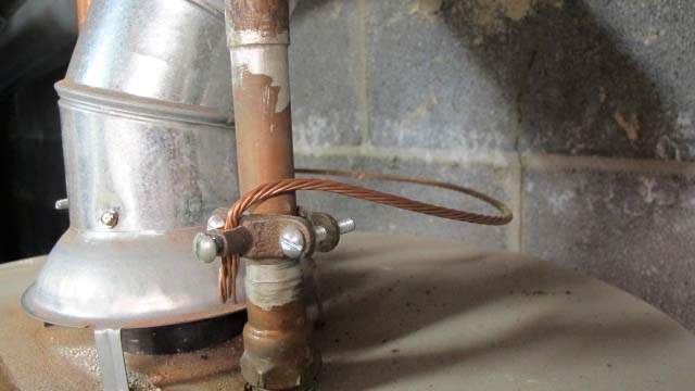

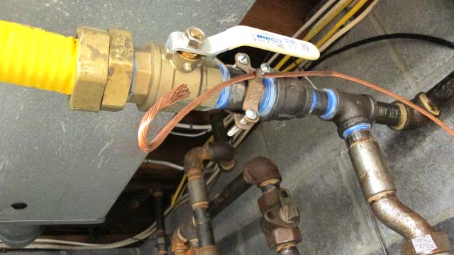

Decades ago we had a new water meter installed by NJAWC, the old one was brass, the new one was some high-tech engineering resin and could be read from the outside. While there was a stout stranded copper cable from the cold water intake to the panel, they bridged the water meter with clamps and copper cable.
With some home improvement work done recently and a back-up generator installed, the electrician and plumber had a lot more grounding work to do to bring it to code:
