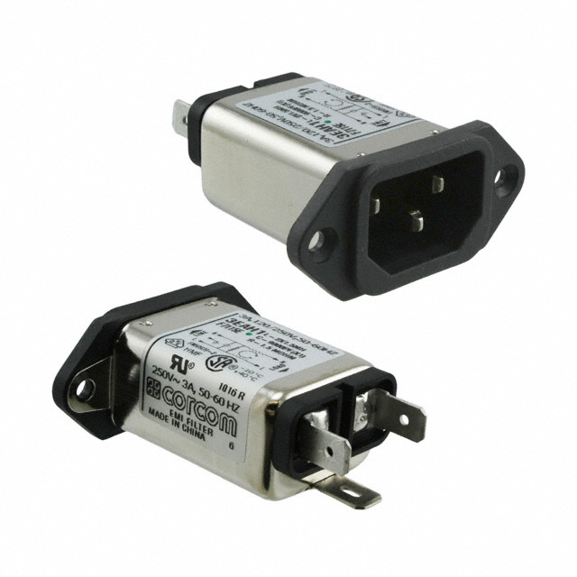

AC Line Filter

Corcom was used in a lot of industrial machinery (Woodman bagging machines) and test equipment, so unless the brand name has new owners after a fast buck, they should be industrial strength.

What are the disadvantages of this device ?
The disadvantage is that it is physically larger than an IEC connector without the filter. In a tight box, that could be a problem.
Does it degrade the sound ?
The power-line filter itself should have no direct effect on the sound. As pointed out up-thread, the power transformer is a magnificent filter on conducted noise (which the Corcomm filter is also designed to block).
What are the benefits of this device ?
The benefit is that it will keep high-frequency energy from entering your amplifier box. If you are using a metal chassis with a metal bottom plate, you have a good shielded enclosure that prevents stray radiation from getting into your circuitry.
However, if RF energy is conducted into the amplifier chassis enclosure on the power lines, it can (and likely will) re-radiate into other wires inside the box and cause mischief. Remember, many of the tubes used in audio amplifiers have gain well into the VHF and UHF spectrum, and RF energy (from a local radio station, for instance) can easily create intermodulation noise or (worse) be detected. AM radio stations are particularly nasty, if you live in the vicinity of the transmitter...
In general, the Corcomm will help block RF energy (>1MHz) from getting into your box on the power-main lines. Same idea with putting small capacitors directly to the chassis on the input/output audio lines to keep unwanted RF energy from getting into the enclosure.
You may not need a filtered power-entry module, but on the other hand if you have room for it it will certainly keep unwanted high-frequency noise out of your box.

BTW - for the case of a switching power supply, especially the offline switchers used in computer power supplies, the filtered IEC connector keeps noise from getting out of the enclosure!
This is important to keep radiation from a device from interfering with other pieces of equipment, and is usually required to secure government agency approval of a particular device.
Since we don't worry about government approval of our DIY amps (well, usually 😀), this isn't an argument for using the filtered connectors. And for the tube amplifiers in particular, switching power supplies are not common (although they are showing up with greater frequency in new designs).
But if your amplifier is messing with TV programs your significant-other is trying to watch, maybe it's cheap insurance to maintain a peaceful home? 🙂
