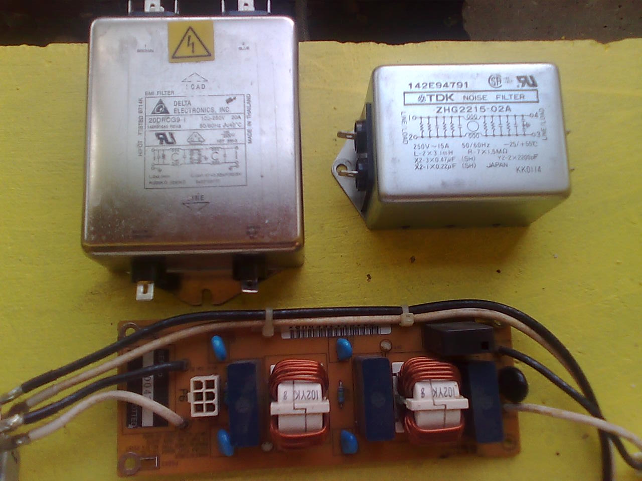

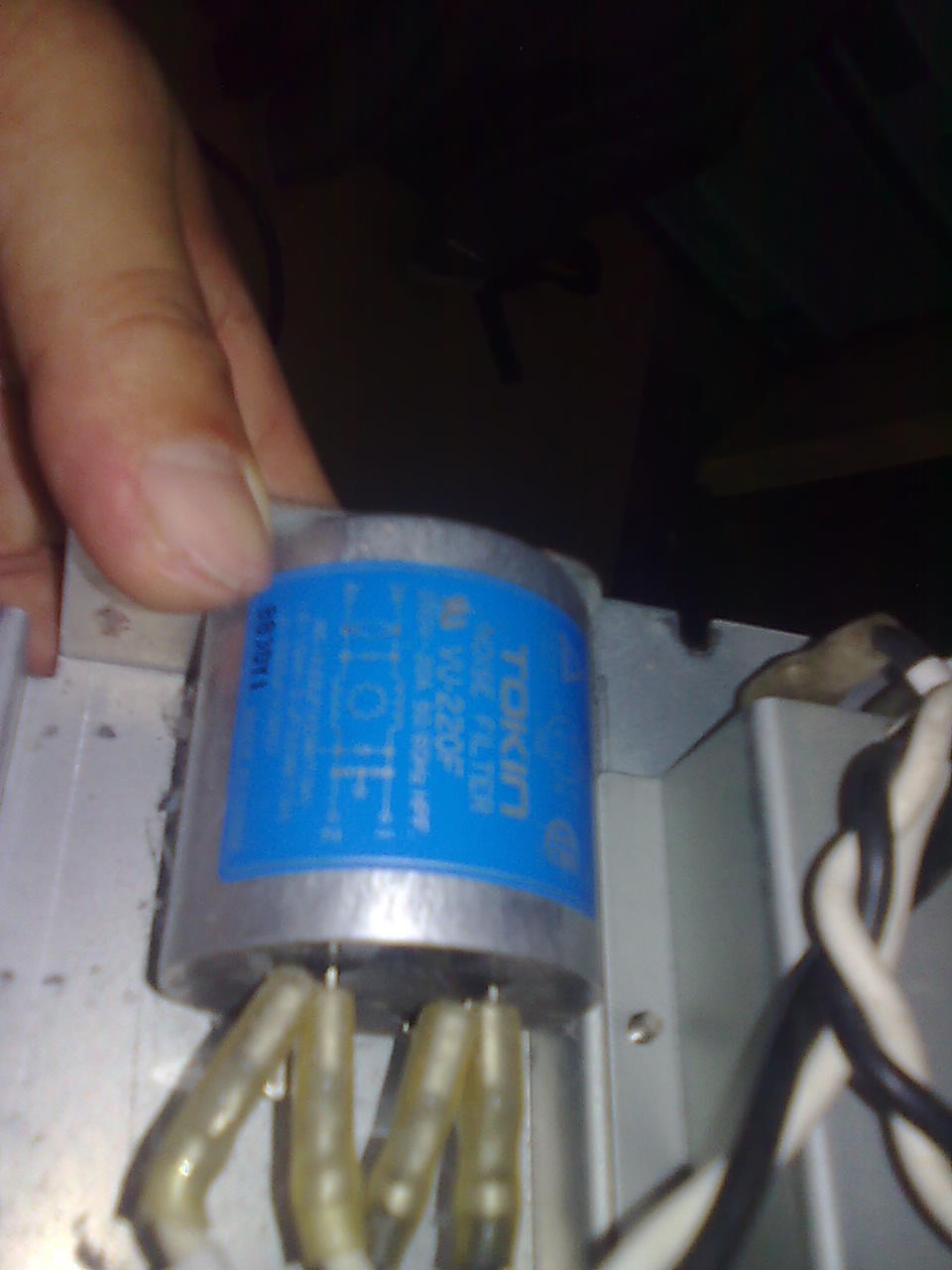

the pics in post1 and post24 show filters designed to be fitted through a hole in the enclosure.
Both have a recess in the plastic moulding to allow a neat hole for back of panel fitting.
Most Builders will mount these filters on the back of panel since clearly that plastic moulding is designed for that purpose.
BUT !
separating the filter metal case from the hole through which it should pass allows interference to pass through that hole.
And worse the interference filter takes the cable interference to the enclosing metal can with no where for that interference to go, except via the PE connection via a long wire.
For best RF attenuation the metal can should be in contact with the enclosure hole all around the perimeter. No gaps equals no leaks of GHz interference through the hole.
This requires the filter to be inserted through the hole from the outside and then bolted in position with electrical contact from can to chassis to conduct interference direct to enclosure without having to pass along the inductive impedance of the long PE wire.
We are not done yet.
The can to enclosure connection requires good electrical contact to be effective in taking interference to the enclosure.
That requires the electrical contact to be maintained over years of operation. The contact needs a non corroding electrical gasket of protection using some air excluding jointing grease/vaseline/or All Aluminium, or All Steel connections clamped airtight.
Is the can steel or aluminium?
If the can to enclosure contact were to corrode all around, then we are left with capacitive conduction of interference. All is not lost. The frequencies are often so high that quite small capacitances will still allow the filters to work. The area around the hole and corrosion filled gap give more than a few pF, possibly hundreds of pF.
The filters shown in pics 6 & 7 requires the cans to be bolted to the enclosure and preferably near where the cable enters the enclosure.
The cable between the enclosure entry hole and the can terminals requires to be screened and both ends of the screen need to be connected by low impedance methods to the enclosure. This means very short pigtails, or much better: a metal clamp to pull the exposed screen into contact with the enclosure wall.
