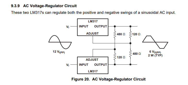

I've seen my homes power fluctuate down to 118v and up to 125v. I want to use AC heaters on 8BQ5, 6BQ5 or 10BQ5 with a lock key switch to select what voltage tube you are installing. (doing this because I own a lot of 8 and 10 volt BQ5's). I can experimentally come up with the right resistor(s) to switch, but its not regulated. What about AC regulation using LM1084? It would make voltage selection easy peasy.
But would the clipped waveform present noise or power loss issues to make it not worth even considering for AC heaters?
This application but using a beefier 5A regulator not a 317.
I think you'll also need reverse protection diodes across each regulator - circuit may be intended for low levels only. Heater is insulated from cathode and it's a high level stage so noise won't be a problem. You'll need to experiment with resistor values since the RMS (heating) value is what's important and the trapezoidal waveform you'll have will not measure correctly with an average-responding DMM. You could also use a dual 1k pot and measure with an RMS meter when you change it. Regulators will need heatsinks; lotsa watts with 6BQ5s.
