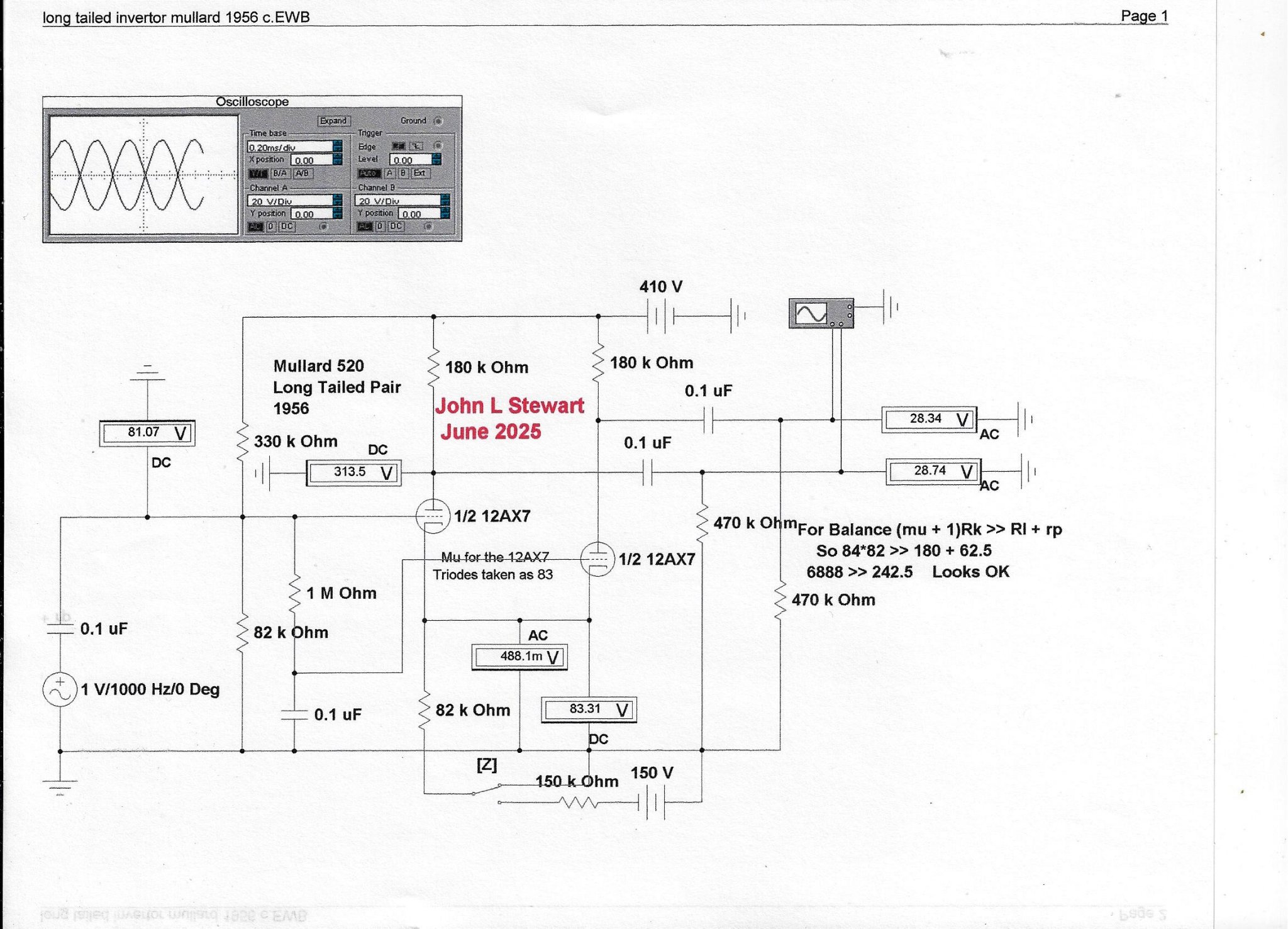

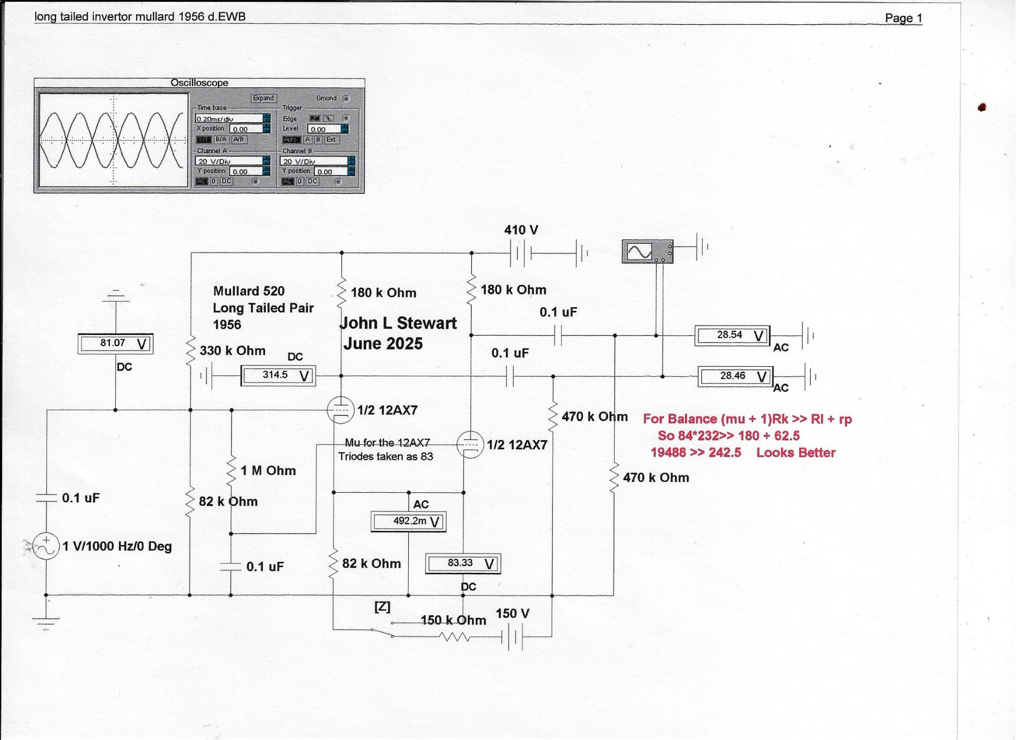

My answer is a diversion. Instead I will show why getting perfect balance is a waste of time.
Here are two simulations of the ordinary Mullard circuit, one the normal & another with a longer tail.
The longer tail makes an improvement that may be worth doing. It uses a negative power
supply, something I've done on all my PP builds for the last 30 yrs. Negative PS is very easy to do,
I'm surprised more people don't try it.
The usual fixes are a current mirror or an MJE340 transistor for the tail. So balance is very good.
But then we find the tubes in the power stage are often not matched well.
So back to driving the output stage with unequal drive, And a circuit to do that.
