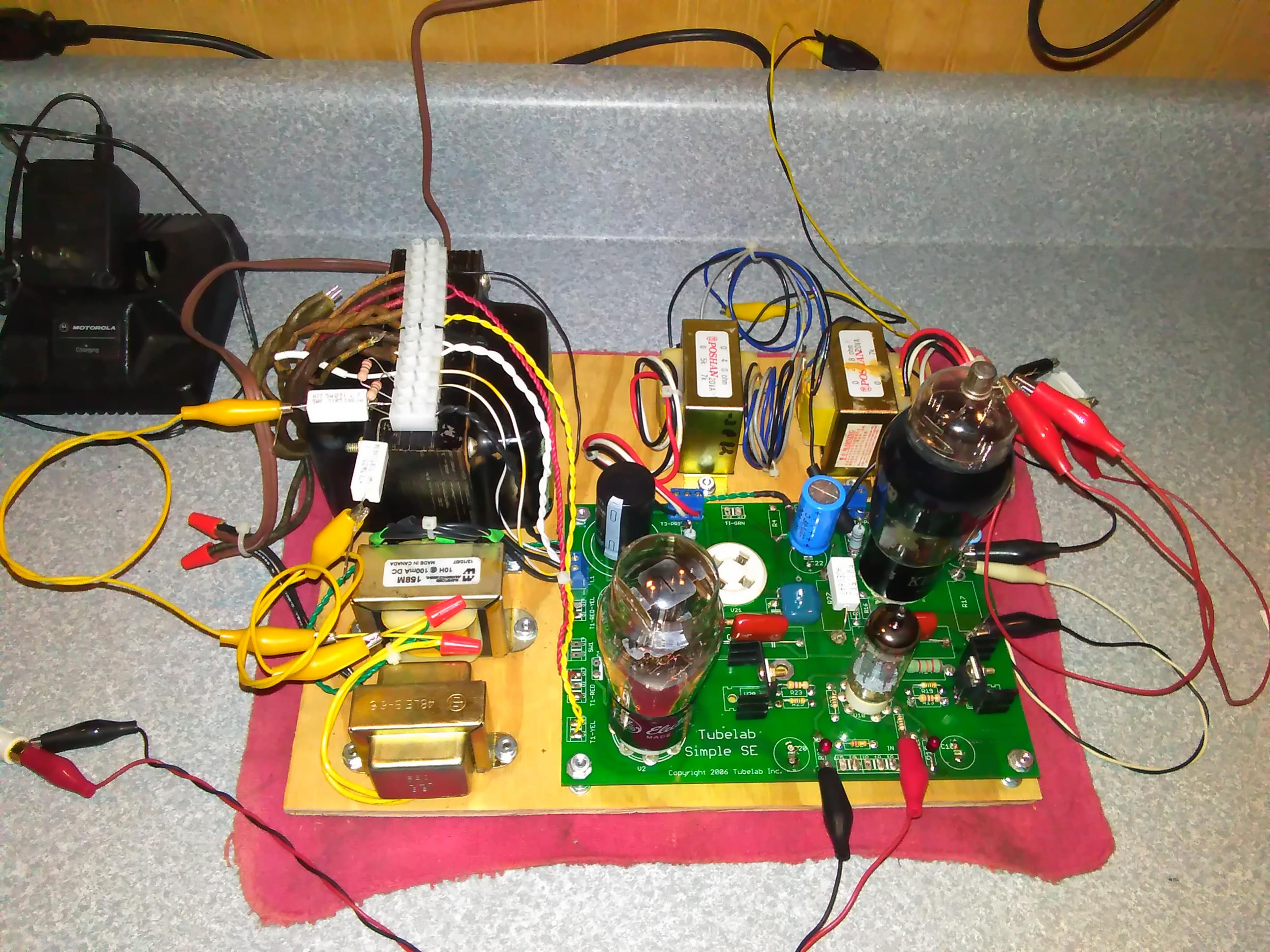

Here is a poor picture of my dual primary OPT's; apparently a bit different than the OP's, as mine lack a 16 ohm secondary.
Looks like I also ( tried to ) measure the primary inductance, but I can't read my crappy handwriting in the picture ( 3.0 H ? 10 H ? ) and I am at our lake house today, so I can't just go look at them.
5V4, 307A/VT-225, probably a 12BH7 - hard to tell from the angle.
I usually lay down lay down power transformers, but in this case, I didn't ... This hefty old timer has dual 2.5 VCT secondaries, but 307A is 5.5 volts, so some improvisation was required. So far as I can tell, I've never had magnetic coupling problems at AF, regardless of transformer orientation.
edit: the breadboard actually simulates the interior dimensions of a Hammond 12 x 10 inch chassis, in case I wanted to drop it into an existing chassis I had. It's still running on the same breadbord with the same OPT's, although the output tubes are now some CBS 2A3's.
