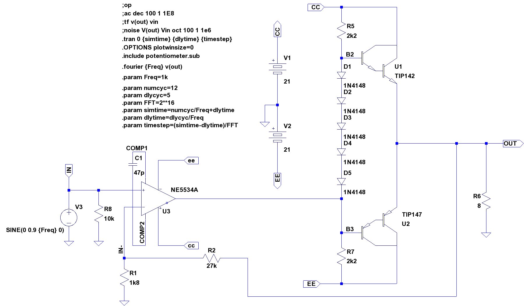

Here is an amplifier circuit that is as simple as I can think of right now that actually works.
It can be thought of as two halves, i.e. on both sides of the power supply (batteries) in the drawing.The left hand side, i.e. the opamp, amplifies the voltage. The right hand side amplifies the current. I used Darling transistors to keep it simple.
LTspice shows that the thing works, with 15W output power into 8 ohm with THD at 0,008% for a 1kHz input. Sadly, THD rises rapidly with frequency, reaching 0,4% at 20 kHz. The circuit has many other shortcomings but is presented in the hope that it will give some insight into how an amplifier works.

I'm curious why is there 5 diode, is it necessity to have so much diodes ?

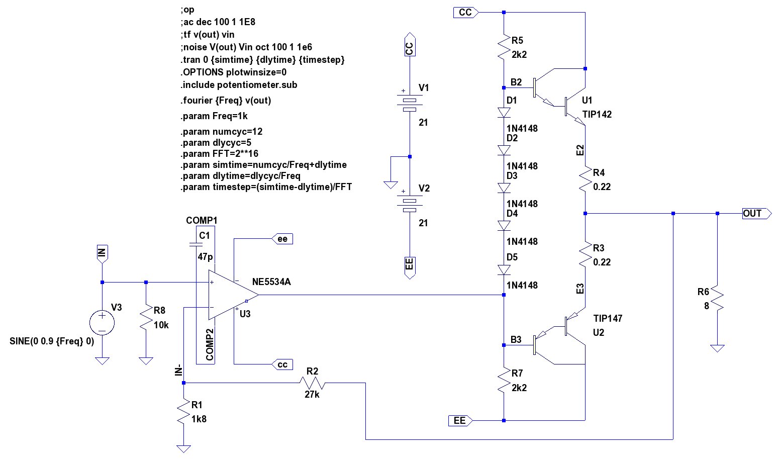

I can see that my previous design lack of emitter resistor, it is a necessity, but forgot why it is needed, anyone could help out ? (something like prevent direct connecting the output transistor)
The five diodes are there to bias the base-emitter junctions in the two Darlington transistors. There are four of them. The "on" voltage for the diodes are not quite same as that of the transistors, therefore an extra one is added to make sure that there is no crossover distortion.
As for those emitter resistors, they can in fact be left out. The circuit will work without them. Performance is degraded a little, but as we are trying to get away with the minimum number of components we can do that.

I'm looking at that R7 between the opamp output and the minus supply - it doesn't look needed to me. And the thing looks scary without the emitter resistors. They at least partly reduce the chance of thermal runaway in the output devices. Being darlingtons (two transistors in each case), both the driver's and output's Vbe's will drop as they heat up.

Most opamps can source current, but they can't sink it very well.
I would probably use an emitter resistor, and a base resistor too.
The diode string needs to be on the heatsink, and I would put a pot in parallel with one of those diodes.
On my idea, I would use a 2K input resistor, and a 20K dfeedback resistor. I would also include a pot to inject some current to the input summing node for a DC balance.

What does the R6 do, which is nearby the output.
I'm agree that adding emitter resistor would be better, but it 'CAN' be removed, but less add it on ^^I'm looking at that R7 between the opamp output and the minus supply - it doesn't look needed to me. And the thing looks scary without the emitter resistors. They at least partly reduce the chance of thermal runaway in the output devices. Being darlingtons (two transistors in each case), both the driver's and output's Vbe's will drop as they heat up......
If you remove the R7, you also need to remove R5 above, if not will effect the symmetry performance ? (I still have no idea what are they doing, possibly bias, but not sure)
Adding a pot parallel to those diode for adjust DC offset or bias ? why not remove one of the diode, and place a pot in the middle of those diode (2 diode each side), thus making adjustment easy ? (i'm very unsure what am I talking about, just sixth sense)

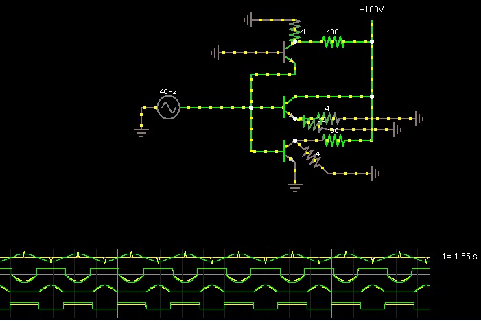

Although it seems weird to ask here, but I still going to ask anyway.
By using the simplest form of BJT arrangement (common-emitter/base/collector), I have simulated using a JAVA applet.
But the results are unexpected, can anyway explain to me ?
The top circuit is a common-base, then common-collector, followed by common-emitter. all using NPN BJT
And the simulation (wave viewer) show in this order :
Input generator
Common-base circuit's 4ohm load
Common-collector circuit's 4ohm load
Common-emitter circuit's 4ohm load
Only common-collector's circuit seems normal for audio usage ? (trapped inside the mist !) according to the book/web, only common-emitter circuit should invert the signal, but seems different than saying... (common-collector's signal is inverted)

One extra thing found out is although the common-collector have nice sine wave, but the voltage and current is way too small. (in pico)Only common-collector's circuit seems normal for audio usage ? (trapped inside the mist !) according to the book/web, only common-emitter circuit should invert the signal, but seems different than saying... (common-collector's signal is inverted)
I found out that the Rc and Re of respective circuit need to be tweak, but only differnet in output signal is common-base arrangement, which makes the circuit have making only halfwave, but it only have 5v, which is same as input.
Increase resistance also help common-base&emitter from shorting power supply.
By changing their gain, there are no difference except for common-emitter arrangement.
