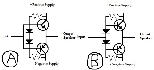

I have attached the redrawn diagram, adding 2 diodes there. (should it be thermally coupled like NJL3281 pair ?)
The direction of diode can be change ? or this is wrong setup (I have the feel of that)
(A) configuration seem no different, also shorting.
(B) configuration seem no shorting, but no signal conduction. (maybe should reverse the direction.
Additional question : Does the 'usual' amplifier have bias current go through to input/VAS driver transistor ?
I am also very naive to the function of all the parts of an amplifier circuit. I have built a few kits, but to be quite honest I did not understand the function of each part. I think this is a great idea for a thread and I will be following it closely and I have my iron ready and my Radio Shack board ready to learn along with you.
B is correct. The signal will travel through the diodes, but you can also add capacitors in parallel with them. The diodes should be thermally coupled to the BJT.
The standard amplifier arrangement has output base bias current going through the VAS collector circuit. The output base voltage is set by a Vbe multiplier circuit, rather than a pair of diodes.

hm.... really ? it seems that positive halfwave 'should' go through the top transistor, but it seems the diode is in reverse bias, thus no positive signal allow to go there.B is correct. The signal will travel through the diodes, but you can also add capacitors in parallel with them. The diodes should be thermally coupled to the BJT.
The opposite also same, the negative portion of signal can't go to the bottom transistor.

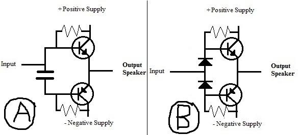

About the capacitor's function ? (block DC ?) why not we eliminate the diodes and put capacitor in between ? this will block biasing DC and allow signal to flow freely.
Based on your answer, i assume that Iq only apply to VAS and output transistor ?
I have attached another schematic, with also have (A) and (B).
(A) - Using Capacitor at value which allow AC signal to pass, but block bias DC.
(B) - Bias DC are block by diodes (reverse bias) and AC signal are allow to pass through diodes (forward bias)
Your new A would work, with the output devices now receiving current bias rather than voltage bias.
Your new B would only provide any output with a big input signal, and would suffer from serious crossover distortion. Essentially, it would only respond to inputs with an amplitude greater that about 1.2-1.4V and would delete the central part of the waveform near the zero crossing.

Ok, since the newer B was not good, then just avoid it for now (until i understand whats happening).
About (A), what value should the capacitor be (roughly) ? I don't think alone would make the amplifier work safely, what could still be add in ?
SO I attached the previous diagram, with capacitor parallel to those diode, is it correct ? What is its purpose ?B is correct. The signal will travel through the diodes, but you can also add capacitors in parallel with them. The diodes should be thermally coupled to the BJT.

Old (B) already was quite close to what one might find as a buffer in a headphone amplifier. Only the emitter resistors are still missing, which are used to swamp part variances and counteract thermal runaway.

A capacitor across each diode would be better than one joining the bases. The cap value depends on lowest frequency to be amplified and diode dynamic impedance, which in turn depends on current. Current will be somewhat greater than BJT base current, but difficult to calculate due to production spreads.
