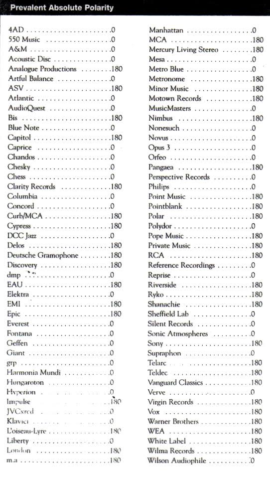

In the end it makes no difference.
If you are concerned about absolute polarity, you have to realize that most recordings pay little attention to it, and those that do are randomly one way and the other. One has to have a switch and somehow note the correct polarity for that soon (if any)

I'm not. I merely repeated what it said in their blurb.In the end it makes no difference.
