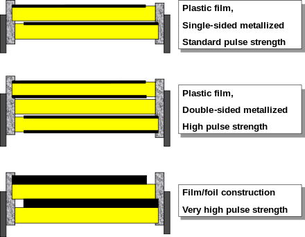

They have different MKP series that are single-sided metalized polypro (e.g., MKP4) vs double-sided (stacked?) metalized polypro (MKP10).
I recently left Vishay after 5 years as their product marketing manager for film capacitors in the Americas region. We offered similar products to Wima. I know people get heated if I were to comment on which may be better for audio and I don't have expertise to comment, so I'll just mention the construction styles below....
The double metallized is not stacked film but refers to the fact that the film itself has double metallization (both sides) as opposed to one side.
Vishay followed similar nomenclature for their products
