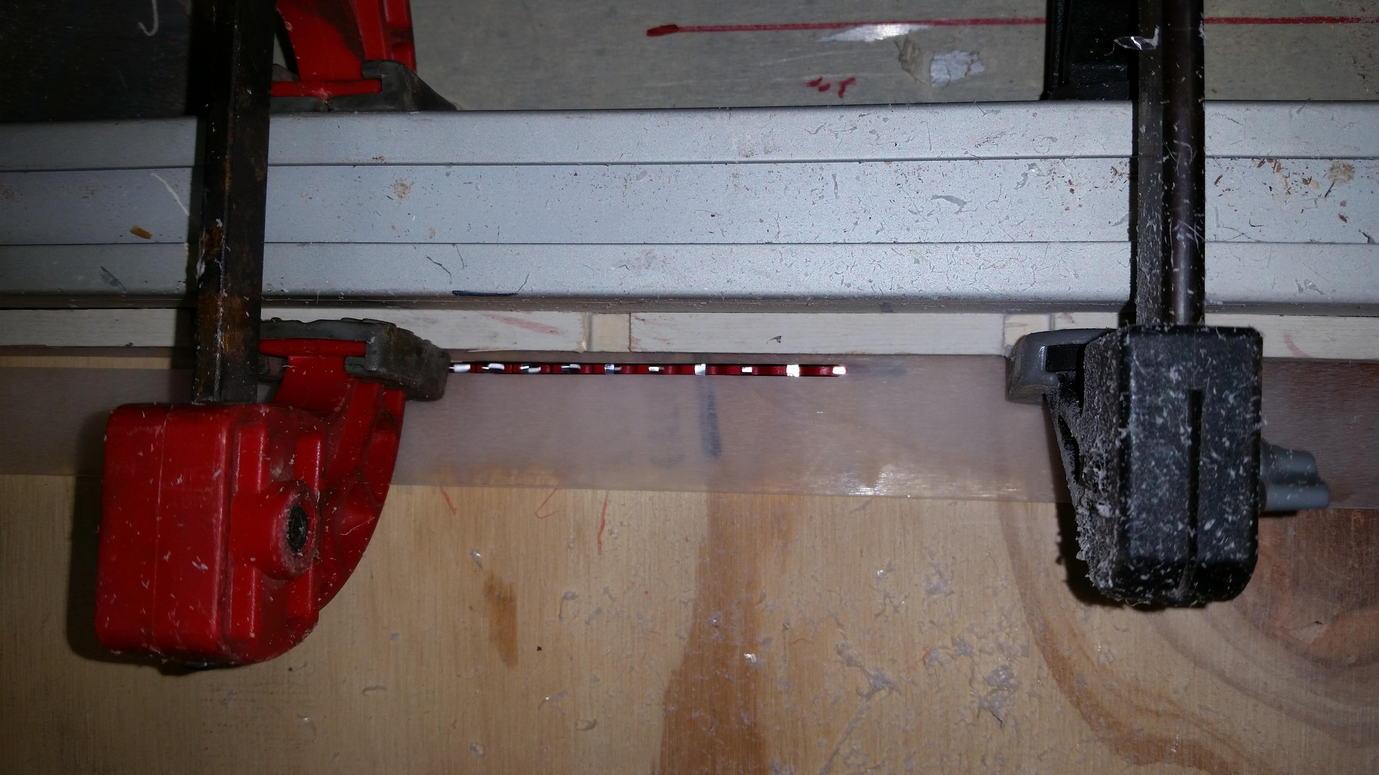

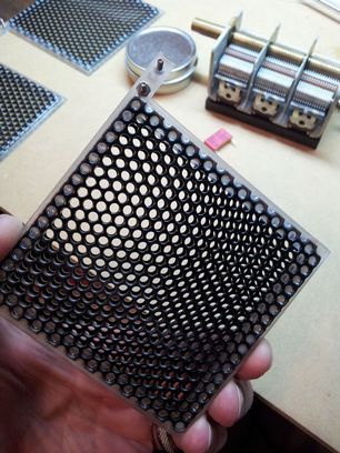

I need to cut 1/2" wide polycarbonate spacers for the grid part of my panels.
Any recommendations on how to cut it? So far, tin snips seems to be the "best" way but not ideal.
Tried, my tablesaw, a diamond blade wet saw and just scoring with razor and snapping it off..... none of that worked well 🙂

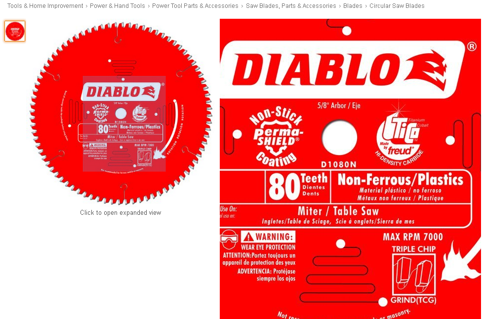

I usually use a table saw with blade designed for cutting non-ferrous metals & plastics sheets.
Most hardware stores will carry at least one blade of this type, or you can order online.
The Freud D1080N blade is an example.

...when I try to feed it in it just broke/shattered the PC. It is only about .07" thick.
Hmmmm...I have cut up very narrow strips of similar thickness PC without issue.
It's possible the particular shape of the teeth on the blades made for cutting plastic made the difference, I'm not sure.
You might also try using a sheet of MDF on top of the PC to help stabilize, setting the blade height to only cut a few mm into the MDF.

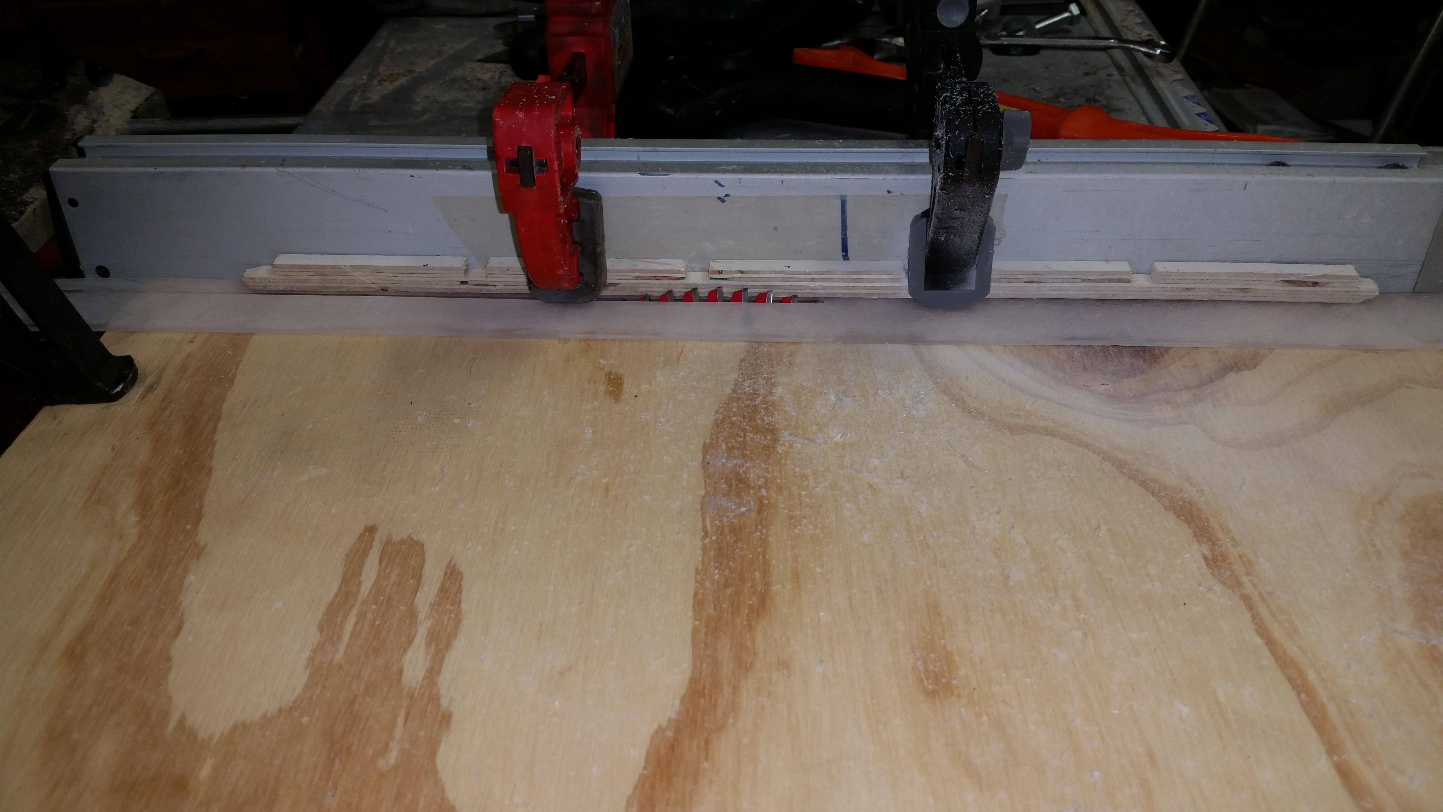

Also note I am trying to cut 1/4" strips from a 1.5" wide strip versus a big sheet.[/QUOTE]
That sounds a little scary, even if you have a SawStop. You might try using a good double sided tape(such as scor-tape) to stick the 1.5" strips to a smooth faced MDF piece that is large enough to give you plenty of space between the blade and your fingers. Once the strips are cut, carefully peel the poly off the tape.
On my particular table saw, the gap between the tabletop insert opening and the saw blade is around 1/4", so there's a tendency for the blade to enjoy adding short thin ripped strips to the pile of sawdust underneath. You may have the same problem. One of these days I might try building a plywood insert with little to no gap to see if it helps with thin strips and lessens splintering when cutting sheet plastics. We'll see.
...One of these days I might try building a plywood insert with little to no gap to see if it helps with thin strips and lessens splintering when cutting sheet plastics. We'll see.
Thanks for the memory jog, this is exactly what I do....just forgot to mention it. I clamp a sheet of 3/8" MDF to the table with the fence set to the desired width. Then turn on the saw and raise the blade thru the MDF sheet just enough to cut the thickness of plastic I need.
Another thing that is useful is a small ~6" piece of MDF clamped to the fence over top of the blade leaving a gap between it and the lower MDF sheet just thicker than the plastic. That way the thin strips don't try and ride up the blade as they are pushed thru.
Thanks for the tip on clamping a block of wood to the fence over the top of the blade. Cutting my next plastic sheet will now be much easier and safer. Previously, I'd been raising the blade too high just so the the plastic wouldn't start 'riding up'.
Yeah, I had the same issue.... I think the problem I had is when the blade is high it rides up the blade and then at some point gets "slammed" back down....then it breaks/shatters.
