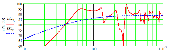

Is the Monacor SPH-165
This one?
Or this one? *hmm, i have a single that looks an awful lot like this one)
From this image i know GM has done a Voigt for the latter, what you are tunign is the elimination of the 2 big suck-outs with damping..
attachment.php
I will leave it to the experts but u suspect the former not all that suited to a Voigt.

I took a closer look on that Monacor SPH-165 driver (the one with black cone and bigger magnet) and I think its a good fit for that Voigt.
SPL response has a 2-3db bump around 300Hz which is good beacuse pipe have a big hole at that frequency, so it will help to smooth things up.
LF rollof starts little before 100Hz which is also good beacuse it will reduce response bump at pipe resonating freq. around 60Hz.
Qts is low, and Fs/Qts ratio is above 100, so TS parameters are suitable for Voigt pipes.
165 mm driver is not too small for this pipe, they were used before and they worked. The pipe internal volume is only around 32 liters so I think 165mm/6.5in driver is actually more suitable than 200mm/8in.
You know this is midbass driver so you need additional tweeter and some crossover.
SPL response is smooth all the way to 5khz, with gentle rollof after that, so you can use natural rollof of the midbass (no crossover) and switch the tweeter in at 5khz with simple capacitor in series with it. Youll have to experiment with capacitor value and tweeter phase in order to get optimal result.
If you dont mind 2-way system that might be simplier solution compared to full-range drivers which usually need inductor-resistor-capacitor filter to get smooth HF response.
Tweeter should have same impedance as midbass, Fs below 2khz and 89-91db efficiency.
