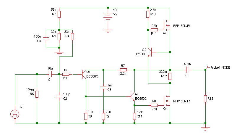

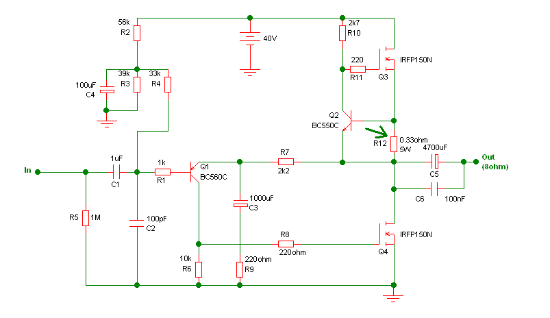

I recently assembled this amp and it is running good.

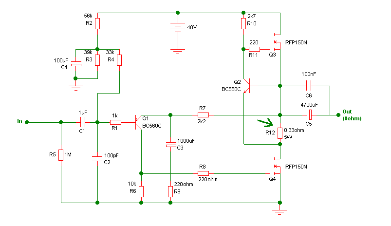

For the place of the CCS load resistor (R12) I have tried both the configs shown in the two pictures and both simulate and work fine with the distortion figures being identical at 1kHz@10V P-P into 8ohm.
My questions are:-
What are the advantages/disadvantages of the two CCS configs?
How can I reduce THD without adding more gain stages?
Thanks.

Hi shaan, i can't help you with the CCs
I have a possible suggestion to get the THD lower though 😉 Try substituting R6 (10k) on the collector of the input transistor & put a simple constant current in it's place. This should increase open loop gain & thus with feedback lower the overall THD..
I reckon 😀
I see Nelson Pass Zen in this - you could do worse than review those designs.
I don't like that you have the small output bypass capacitor on a different side of the resistor than the main output capacitor - easthetically speaking.
The first circuit is not a CCS, but closer to SRPP with Q2 monitoring current flow through R12 that is flowing through output device Q4 and therefore is modulated by the signal. Look at Zen version 4 for an example.
The second circuit is a CCS load since Q2 monitors current flowing through R12 which sees only the current through output device Q3. Look at Zen version 1 to learn about this one.
Why do you want to reduce THD further - these designs (Zen amps) are known to sound wonderful. It usually helps to push more current through the output devices but you already have 2 Amps bias current.
I nearly missed it - add a bootstrap capacitor from the output to the junctions of R10 and R11, this will provide a much better current supply for Q2. You might like to reduce R10 to around 1k.
Are you sure about this? I'm only asking as the upper mosfet gate won't be driven linearly. It's gate voltage is controlled by the transistor that's effectively turning it into a constant current. Bootstrap to that & the CC is no longer a CC but a very modulated one.
You did give me a good idea on how to make the amp swing right to the positive rail though (or damn near). Split R10 into two resistors & then use a bootstrap from the output & connect it to the junction of the two new resistors replacing R10. If you don't do this you'll not get enough gate voltage on the upper mosfet to get right close to the rail.
You could try something else to lower THD as well. Whether you adopt a constant current instead of R6 on the collector of the input transistor or not, there would be a distinct advantage to placing a simple emitter follower where the lower power mosfet is connected.
Right now the input transistor is dealing with the current accross R6 & the current needed to charge the gate of the mosfet. If you can get rid of the gate charging from the input transistor (whilst increasing the current available to charge the gate) the whole thing will speed up & again you should see a lowering of THD.

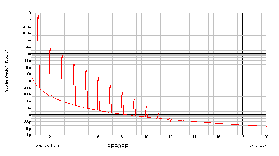

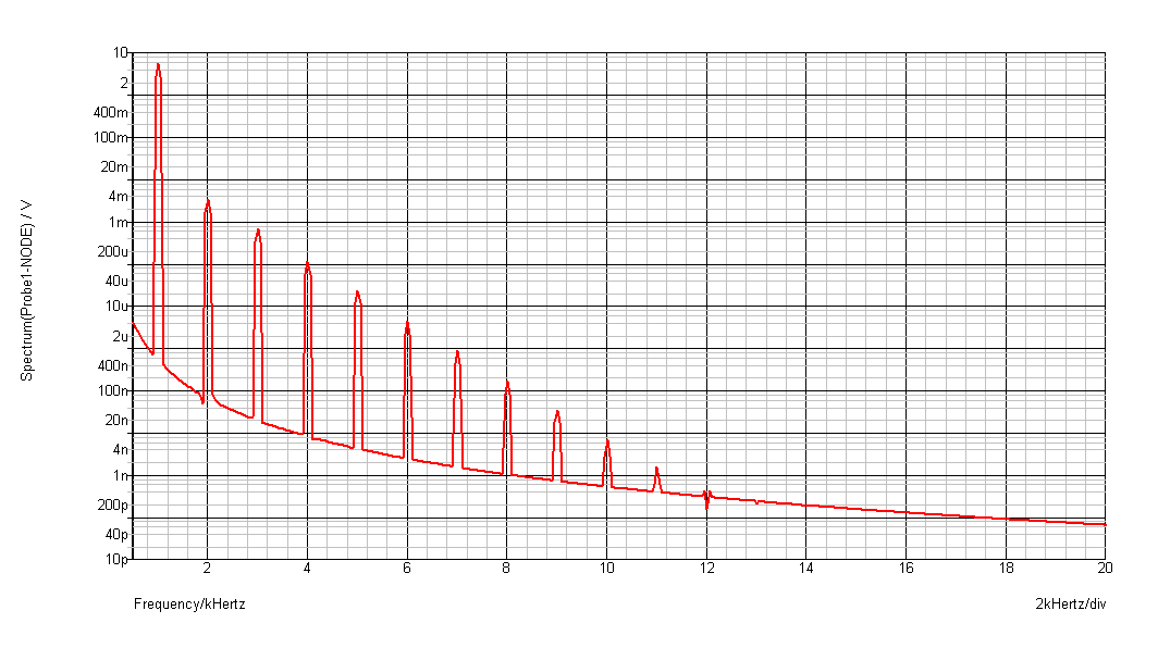

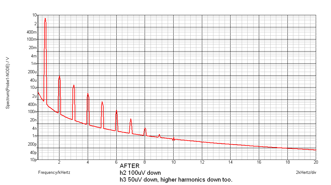

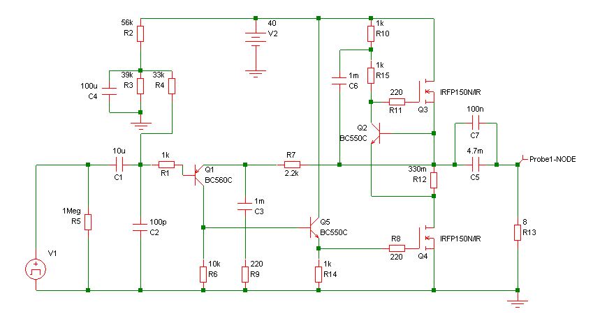

I'm having fun for sure. Your suggested additions showed very good improvements of the THD figures. Sim result below. I am going to try this tonight. 😀
Please tell me on the value of the emitter resistor for Q5.
Thanks.

It needs to be fairly low, i'd suggest 680R, don't forget that this is the only thing that will be discharging the gate. By the way, don't connect the emitter follower collector to the output or you'll restrict the voltage swing of the amplifier. Don't forget that to get near to the negative rail the mosfet will need up to 6V or more to get close 😉 Connect the collector to the positive rail. If you find dissipation an issue i'd suggest something like a zener diode in between the collector & the +ve rail to lower dissipation of the transistor. Noise shouldn't be an issue as it'll be on the collector 😀
E2A:- You could make a 12V rail from the ground of the amplifier. Again a simple zener & capacitor fed by a resistor from the positive rail. Not much current will be consumed as it'll only be used to charge the mosfet gate & this will increase at high frequencies. It still won't be a lot though... Food for thought.

Hi Shaan
I'm surprised they measure the same.
In your second pic (with R12 above), R12 and Q2 measure the current through Q3 and try to keep it constant, so Q2 and Q3 form a constant current source and Q4 delivers the signal current to the load.
The circuit in the first pic (with R12 below) works differently, though. Now R12 and Q2 measure the current through Q4. Q2 tries to keep the current through Q4 constant by changing the current through Q3. So Q3 ends up delivering most of the signal current to the load, with Q4 only contributing a little.
If you split R12, half above and half below, you can turn it into a push-pull amp, where Q3 and Q4 each deliver about half the signal current to the load. That way you should be able to get about double the peak output current for the same idling current.
I'm not 100% sure of all that, but the sim should be able to tell you what currents are flowing in Q3 and Q4 for each configuration.
Also - if you bootstrap R10, you should be able to get more voltage swing on the output.
It's probably worth having a look at overload behavior as well - voltage clipping with a high impedance load and also current limiting with a low impedance load.
For distortion, you could try reduce R7 and R9 by half and see what happens. Maybe you could try reducing R6 by half as well. I don't know what that will do to the overall distortion, but it should improve the speed and maybe give better performance at high frequencies.

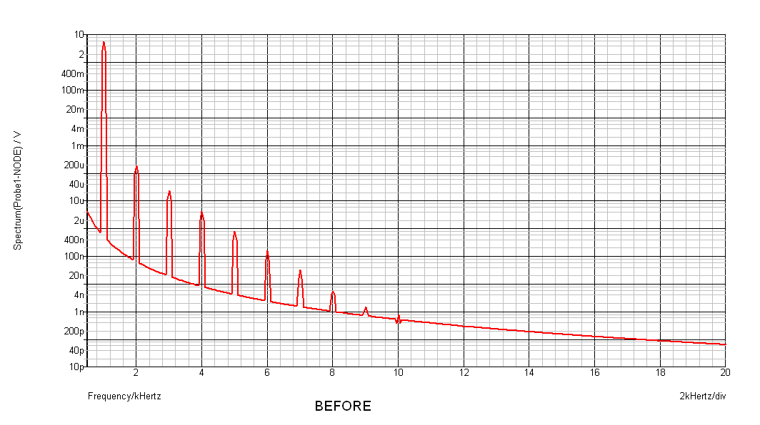

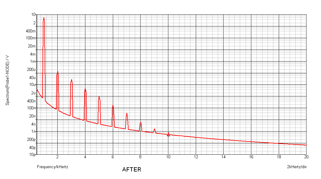

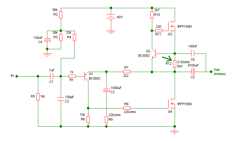

Quick sims show some more improvement of the harmonic content with Q5 collector at +ve and 1k emitter load. 2nd and 3rd harmonic about 100uV lower and higher harmonics are a bit lower too.

Thanks for info on the CCS.
I don't want to run it as a push-pull. 10 watts will be enough for me with this circuit. thanks for the suggestion though.
I think I will use the bootstrap for better +ve swing.
I should imagine that's simply down to the lower resistance value.
Now try replacing R6 with a simple constant current. An NPN transistor, two diodes & a resistor will give you a good idea to see if it's worth persuing. again connect from the base of the transistor to the +ve rail. I'd suggest a resistor of about 270R to set the CC. This will result in about 2.7mA continuous through the input transistor collector.
It should speed things up & result in lower distortion yet again.
