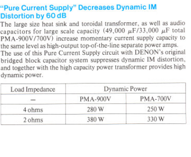

I don't understand exactly the theory of operation of this power amp circuit from DENON - especially those of the OP-Amps.
In order to the front-end there is a certain similarity to Electrocompaniet's Ampliwire AW-100 go to post #3 (first PDF file) under
Electrocompaniet Ampliwire 100 (AW 100 AW100) different Versions
But what are the aim of the operational amplifiers IC511 and both halves of IC711 in detail ? - go to the attachment in post 12 and also to the attachment in post #2 under
Denon PMA-900V lowering gain/opamp swap
for PMA900V.
Are this an invention from DENON or is there a well-known naming for this topology ?
Thank you very much for some advices.

  • 1611674669_2020-04-2412_00_53-hfe_denon_pma-300v_500v_700v_900v_brochure_en(1).pdfGoogleChrome.p.png
