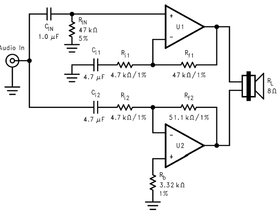

Is there some sonic quality diffrerences between the LM3886 alone and the bridge version of the LM3886 (100 watt) ?
In the AN-1192 aplication note we can see that the bridge version of the LM3886 do have lower distortion at very low level output and at high frequency compared to a LM3886 alone.
