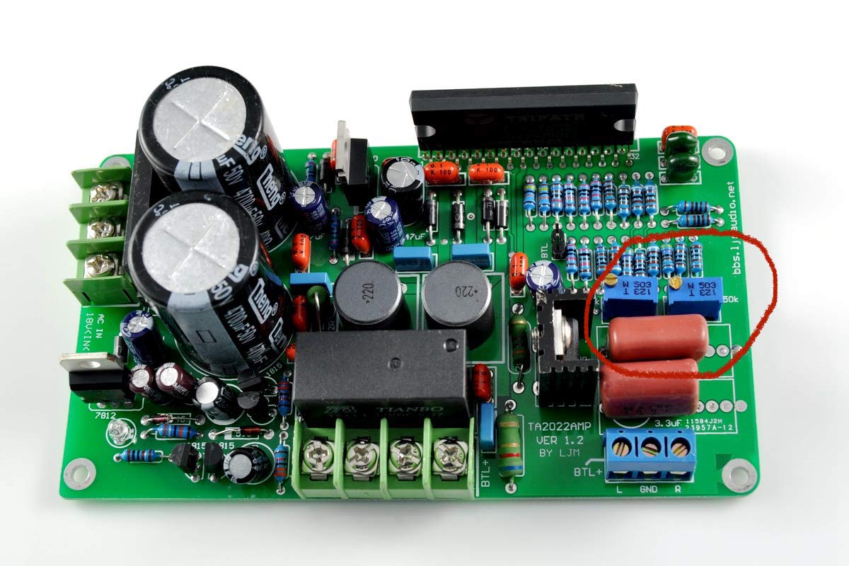

I recently bought this board and I see 50k trim pots. Does anyone know what these are for?
Thanks.
99% sure they must be to set output offset voltage (DC)
like in the case of all ta2020 muse, topping etc.
In case of the topping tp20 I measured 170 mV on one output channel and -26 mV offset on the other. I managed to adjust this to +/-1mV with the amp ON while connected to speakers (using a simple dc voltmeter connected to the output). After this I don't hear any dc click from the speakers when powering up. I also have a muse m20: the offset was already < 20 mV but still I adjusted to +/- 1 mV.

I bought LJM TA2022 class T Power amplifier board kit.
i am having a problem maybe someone can help? When the amp turns on the relay does not click and no sound is heard, If the relay is jumped the amp is working.
B: yes. 'm sorry I didn't see your question and answer time later.
Maybe you should be using the multimeter, measure OUT GND dc voltage.
Adjust the adjustable resistance make them close to 0 mv. Won't appear such relay protection

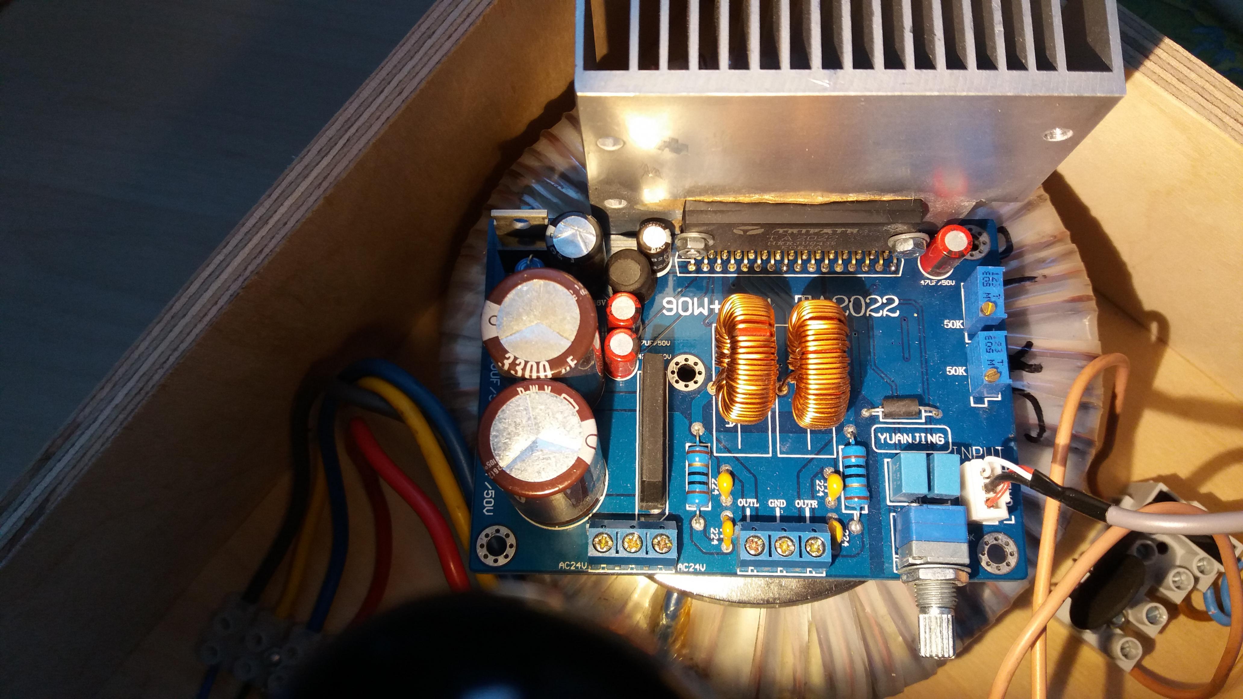

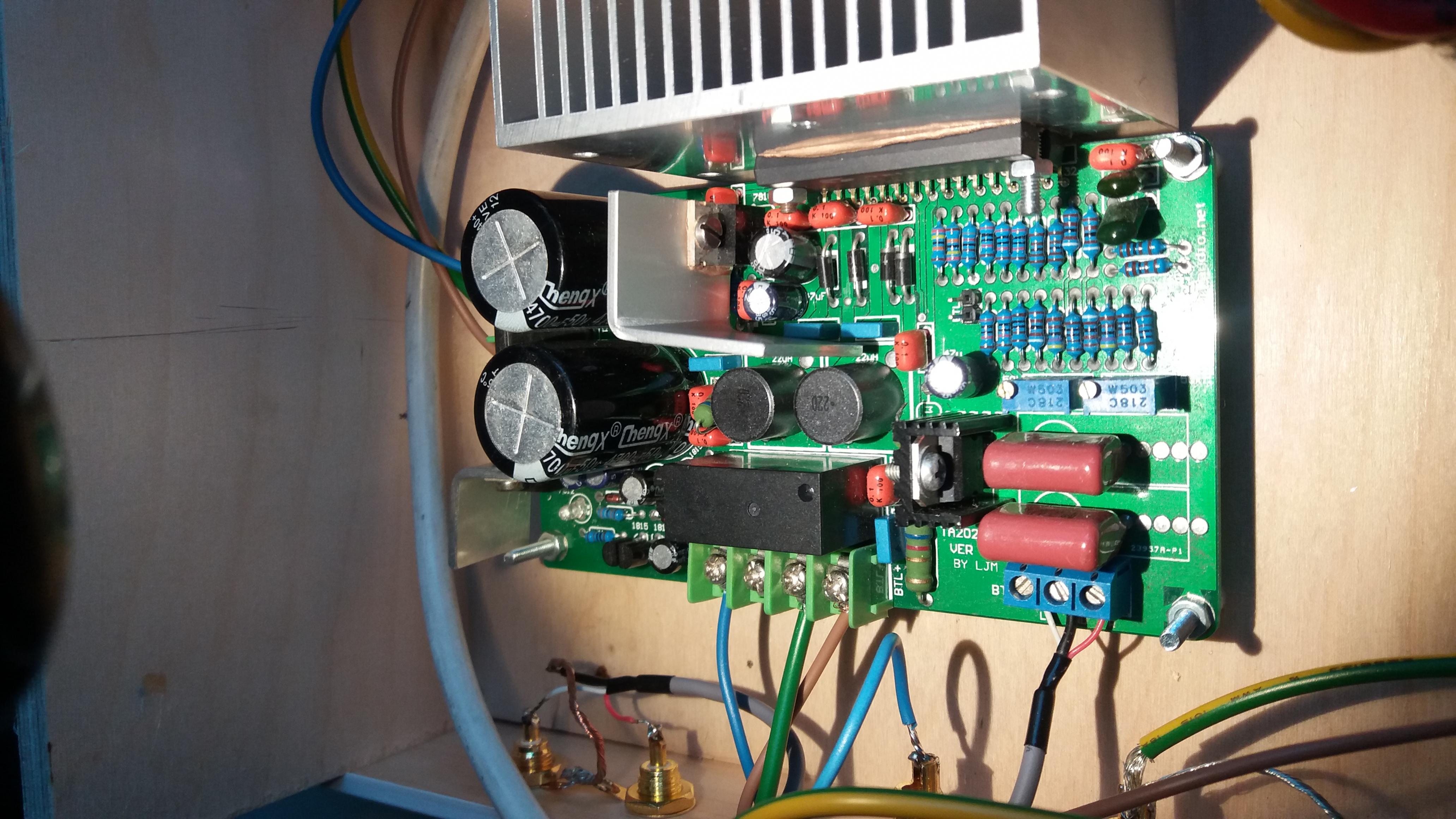

Hi ljm,
I have a similar problem with TA2022 ver 1.2 board: I hear the relay click after 4 seconds but no sound at all. Also no noise from the speaker whatsoever.
I also tried a very cheap yuanjing board: this does amplify but noisy if unshielded.
I think the I am dong something wrong with the ver 1.2 board: the bridge jumper is not installed and I want to use stereo.
Please advise.
Greetings from the Netherlands

found an error; now the ver 1.2 is up and runnng: fantastic
hi all, and especially ljm:
I found that resistor 200R, just behind the 7805+cooler was loosened. By the way in schematics this resistor is depicted as diode????
Now the ver 1.2 runs perfectly and even in a open wooden testcase the noise is very low.
Compared to my topping tp20 the extra power is clear, nice bass!
I think I have a new favourite.
