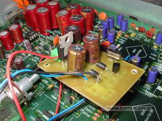

And I found picture of CD72.
CD72 has SMD(=QFP) version!!
http://www.webmedia.pl/maciejza/tuning/mar_72p2.htm
arniel, are you sure?
CD42,52,62,72 all seems QFP version saa7310.
SMD version = QFP.

I think you're right... I was getting confused with the digital filter!
The CD42 is very similar to the CD72 in most parts...
