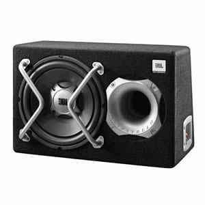

Inductor said:Hi,
you can look for the JBL GT5 for bass maybe in a (do you know how to use WinISD?) 4th order bandpass, and a Fostex (FF225-K) as main driver and also one Fostex as a tweeter/supertweeter or a ribbon. After you choose were to go, post your idea.
Yes, i used it but the small version. This is where i learn than i can't expect deep bass + high spl bass with my MTM configuration with a constant curve !
For your main driver and tweeter, i already have a floor-standing project.
I look for the JBL on WinISD.
