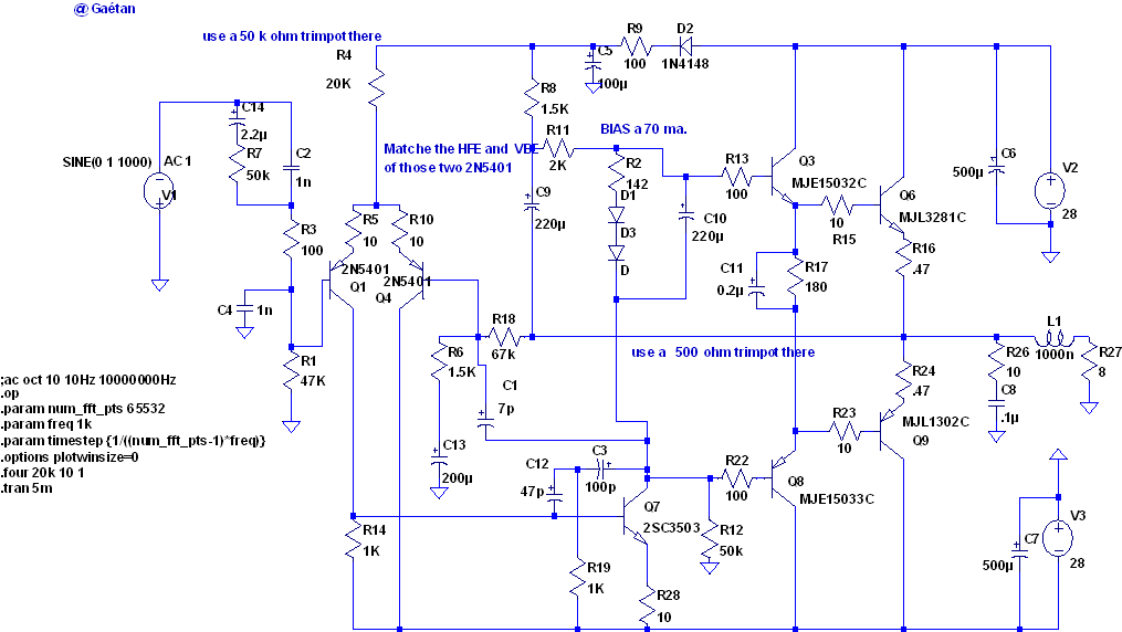

2 pole compensation allows high amounts of low frequency loop gain to be used in the global loop to correct "everything"
but a precondition is for the amp to actually have high open loop at low frequency - which your amp doesn't
triple output
lose the 50k VAS load R12
bootstrap VAS ccs may also limit gain
'beta enhanced' VAS and diff pair current mirror
actual diff pair tail ccs too if this is a noninverting amp
all the good things you'd find in Cordell's and Self's books
