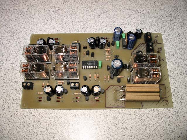

Startup module
Here is a picture of my startup/control module for my amp
I'll post schmatics later
\Jens
