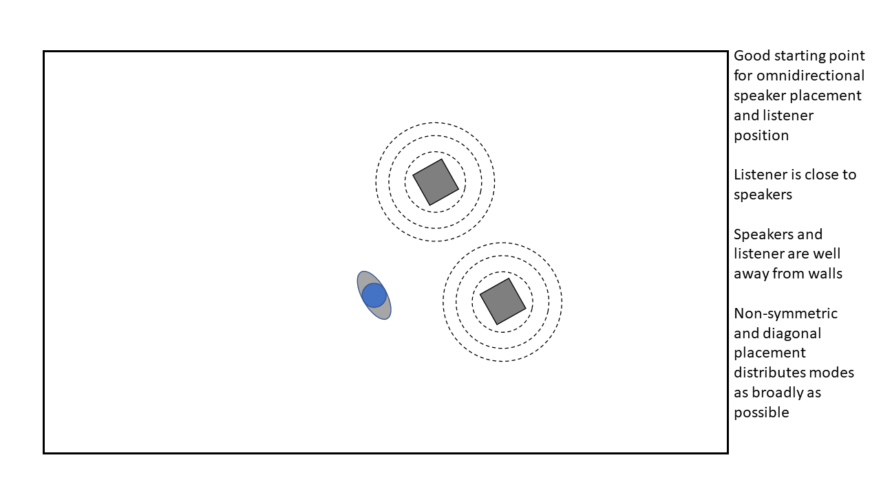

I once spent some time listening to a pair of Mirage M1 speakers, which are close to omnidirectional. They sounded best when pulled out into the middle of the room, set up on a diagonal, and the listening position was fairly close. The speakers were much closer to me than they were to any wall. They sounded best with classical music, but particularly with Telarc recordings. If you recall, Telarc used a microphone technique of a pair of widely spaced omnidirectional mics. I did not put the connection together back then, but it makes sense to me 30 years later. To me, Telarcs have always had good tonal balance, but I have always struggled to get good imaging and 3D sound from Telarcs. Those M1's did a really good job of it.

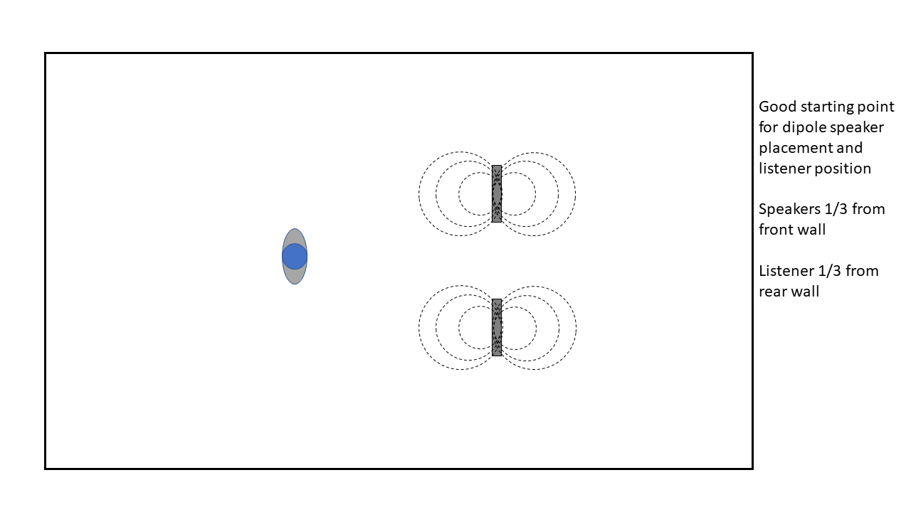

Another speaker which demands a unique placement is a dipole such as Magnepans. When set up right, a pair of big Maggies can be really special. The small maggies don't seem to have enough dynamics and SPL, in my opinion, but the big ones can do... But again, you have to position them properly in the room.

For the record, there is no way an omni speaker would work in my listening space. I suspect most people have a similar situation... we can be somewhat flexible about speaker and listener positioning, but the demands of an omni (or dipole) speaker are just too great.
I can certainly see the truth in this. An Omni speaker interacts with the room more, and creates more early reflections and late reflections. As @profiguy said, this can be a pleasant listening experience, but a sound professional needs a monitor to be an accurate tool to evaluate what is in the signal. My understanding is that most control rooms and mastering rooms try to minimize reflections, so an omni speaker would seem to be completely out of place.That being said, omni radiating speakers never work in the practical or theoretical world of live recording, as they add something not present when the recording was made to begin with.

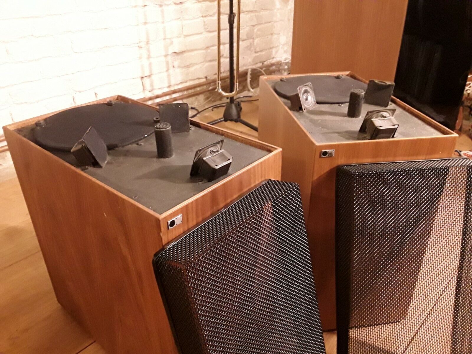

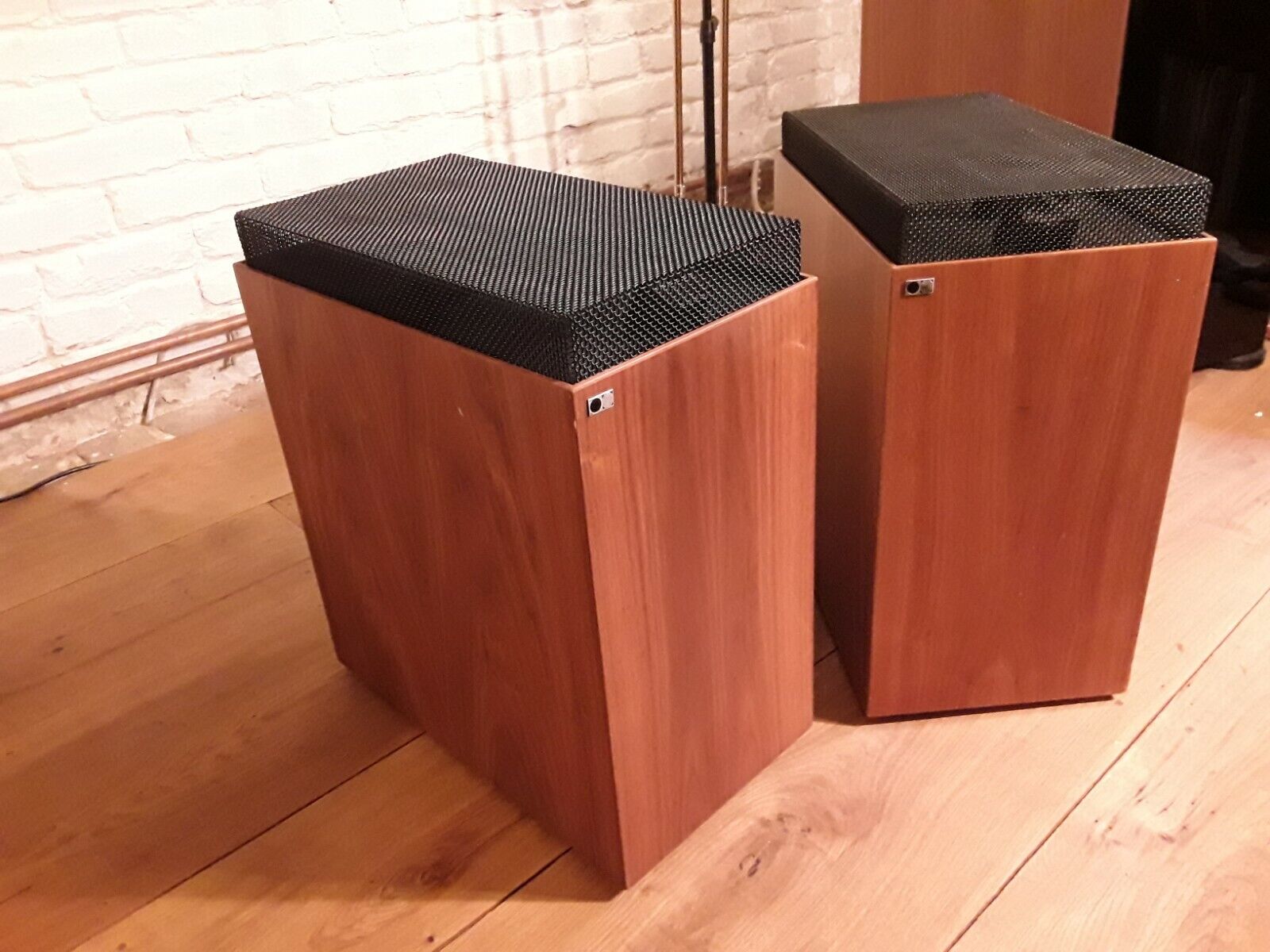

I did like the SONAB speakers of the 70s/80s. You could not spot a single instrument, but in a large room with high carpet the music was anywhere. Not for concentrated listening to details, but very nice for background music and civilised party's.

Think of a large lounge, where you want to produce decent ambient music whitout loud or silent spots. Many people in the room, in small groups, maybe.
4 omni speaker, one near each corner. As you move away from one, you get nearer to another speaker. Reflections over the ceiling and walls distribute sound. It works, very well. Not for you, probaply, but for the situation.

If the whole system or most of the midrange on up is open baffle, that's a different animal than just a tweeter firing backwards (in or out of phase). It the imbalance of treble shooting backwards that is a problem for me, in most cases being an afterthought of design. It never sounds acoustically right or correct in any room and is a novelty at most. Definitely not for serious music monitoring and falls into the Bose philosophy of designing something by accident and labeling it as something scientifically well though out.
I've heard open baffle systems with a tweeter wired out of phase taking over where the rear radiating mid leaves off to maintain a balanced FR going rearward, which made sort of sense. It sounded pretty nice, but there was still a veiled sound up top with that exaggerated stereo image. Still, it made more sense to make the same FR of audio go backwards and forwards instead of just having the mid open and no treble to complete the rearward out of phase signal itself. The mids of this setup did however sound very open and natural, likely also due to lack of rear enclosure. I'm a big fan of open baffle speakers when they're executed properly and set up in the right location. Its just the rear facing tweeter that bugs the crap out of me and it has no place in a speaker designed for critical listening or monitoring. I've listened to higher end designs like the MBL and Walsh, but those also can be great in the correct setting.

Walsh ! That was the other omni speaker I had heard once... It seemed very musical and natural, but again, with certain kinds of music, and with the right middle-of-the-room setup.I've listened to higher end designs like the MBL and Walsh, but those also can be great in the correct setting
