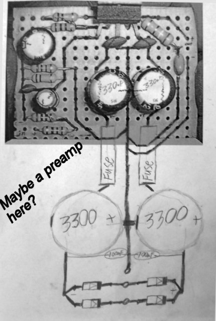

Ok forget about two speakers!
I want to drive just one speaker and i want watts between 2 to 10 watts!
So please suggest me any link or any e book or something like that so that i can build it at my home.
Here is a link to LM386:
http://cache.national.com/ds/LM/LM386.pdf
See page 5.
The LM386N-4 (handles up to 18v) can produce about 1 watt all by itself.
So, you don't need an additional power amplifier if you just want an intercom.
If that's not enough power, here's a power amplifier to boost it.
This photo attached is lm1875.
http://www.national.com/ds/LM/LM1875.pdf
For that 10w power output, it can use a very cheap 24vct (12+12 center tap transformer).
To also run the LM386 microphone amplifier from the same supply, LM386N-4 will work perfectly well; however you could run the others safely from a 5v power regulator chip.
This combo can probably make a karaoke appliance.
