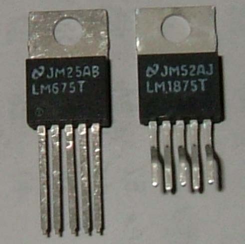

My LM675T's all 5 feet are derect, but its datasheet in NS web cite show that it is same to LM1875T in appearance,....Why?

the LM675T is in a NS TO5D case, where as the LM1875T is in an an NS package number TA05B case. These appear to be the same as far as the PCB is concerned, but the leads are "bent" 90 degrees on the 1875, making it more suitable to for a horizontal bolted-through-the-board heat sink, whereas the 675 looks like it'd be happier with the upright style, either bolted freely to the package (it doesn't look it'd much heatsinking), or to an off-PCB heatsink (e.g. chassis-mount).

but my 675's 5 leads are all in one plane! it's different with the NS datasheet, am i buy a fake?

It's tough to say whether you're buying a fake or not, but I don't see National listing a part with straight legs. Is it stamped as a National Semiconductor part?
It is certainly possible that there are unlicensed Chinese clones floating around out there. There are a lot of very clever people over there, I remember years ago finding out that I had bought a batch 486DX2-66 chips which were actually 486DX2-50s, with the tops "planed" and re-stamped in China (came through an HK supplier). Boy was I upset, those chips were $660 each back then.
I would test the chip, and if it works, use it. Would you mind posting a photo?

the left is LM675T, and the right is the LM1875T
LM675T's datasheet shows it should look like LM1875T(the right)

The LM 1875 does come in straight pin (page one of the data sheet) could it be that the 675 does as well but is not documented?
