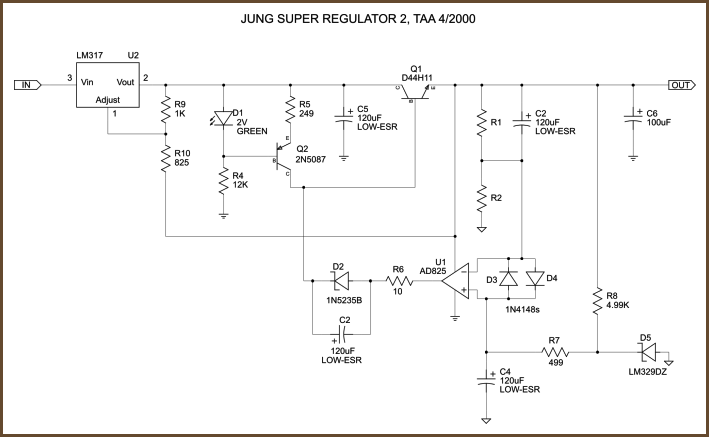

Hello,
i have a couple of questions regarding Jung super regulator - more specifically, the circuit attached, from this post:
1. I understand that zener D2 is there to keep the output of the opamp well below its positive supply, but is it necessary to use a voltage drop equal to the reference voltage? Wouldn't a LED (1.9 V drop) be sufficient and less noisy?
2. If the reference (D5) was biased with a CCS insted of R8, would this reduce noise level? Has anybody tried it?
Thanks...

Point 1: Yes, the zener is very useful as a level shift and allows the op amp to bias around mid-ways-to-the-rails, when selected properly. Other means of creating this level shift are possible, for example, one or more higher-forward-drop LEDs. I can recall doing this trick in the 1997: ‘Low Noise Power for Analog Circuits‘, a ‘Walt’s Tools and Tips’ column, within the ED Analog Applications Issue of June 23, 1997, pp. 65-68. This regulator article is available on my website (see the link in post 110, above).
That said, it isn't entirely straightforward as to what op amp will work (best) within this circuit. Why? Both the input as well as output CM ranges must be adequate. The mentioned article goes into this, and describes methods to test for proper behavior. Recommended reading for all the op amp swappers out there. One reason the AD825 is so useful in this circuit is that it is free from input stage CM quirks (unlike older parts like the TL07x series, unfortunately).
If all of this sounds a bit intimidating, just use the designer-recommended parts, and stay out of possible troubles.
I'll address Point 2 in another post.

Hello,
Point 1 SNIPPed from original quote here
Thanks...
The short answer is, no, CCS biasing will not reduce the noise.
The LM329, all by itself, generates around 75nV/Root-Hz
, and has a 1/f noise corner below 100Hz. See "Zener Noise Voltage" from the device data sheet. This is true whether or not it is driven from a resistor, or a JFET. This specified level of noise is equal to or better than any other reference now readily available. This point was/is a large part of why this part was originally chosen. And, it is still technically the best all around part in this application. Hand selection of more esoteric devices might possibly get noise down some, but that isn't for everyone.
I have seen numerous regulator schematics using JFETs (even cascoded JFETs!) to replace the simple 5k R4 from Fig. 1 of "Improved Pos/Neg Regulators". The PRO of this is that one then won't need to worry about changing a feed resistor for other output voltages. But, I don't know anyone who does such a thing, as the output voltage is set once, and once only. So, this is a moot point. The CON is that you are wasting money on unnecessary parts using a JFET, and even if you do insist on using one for this function, you will then likely need to select a current set resistor for the FET, to make it supply the desired 1-2mA.
The low pass filter R1-C7 provides good filtering of noise, for any type of reference device.
Hope this helps clarify how to bias an LM329 in this circuit.
Walt Jung
Walt, I've had several instances of the Super regulator (both positive and negative) which would regulate without load, but when loaded with 100 ma the output voltage would collapse. The solution turned out to be decreasing R8 to get 4 ma because of marginal gain in the particular D44/45 devices ( sourced from Digikey so hopefully the correct original devices).
I wouldn't expect a current source to lower the noise of the reference, but would it improve input rejection?
Are you *really sure* it is low pass transistor gain?
I just looked at the D44 series types as spec'd by Fairchild, and the low gain charge seems questionable to me. Yes, you can find grades with low gain at 2A, but at 100mA, it is higher. Look at the D44H11 for example. Did you *measure* the gain for a couple of parts, and find that they do have lower gain than typical at 100mA? The 5mA from the current source as configured will provide up to 200mA with a worst case gain of 40 with D44C8, even more with a D44H11. So, I don't agree that the current source needs to be changed to get 100mA. So long as the pass xstrs meet above specs, that is. I just had an exchange with a user on my blog (see link below), who was trying to get 360mA.
As for a current source feed to the ref diode improving input rejection, no it won't. It isn't connected to the input, it is connected to the output.
