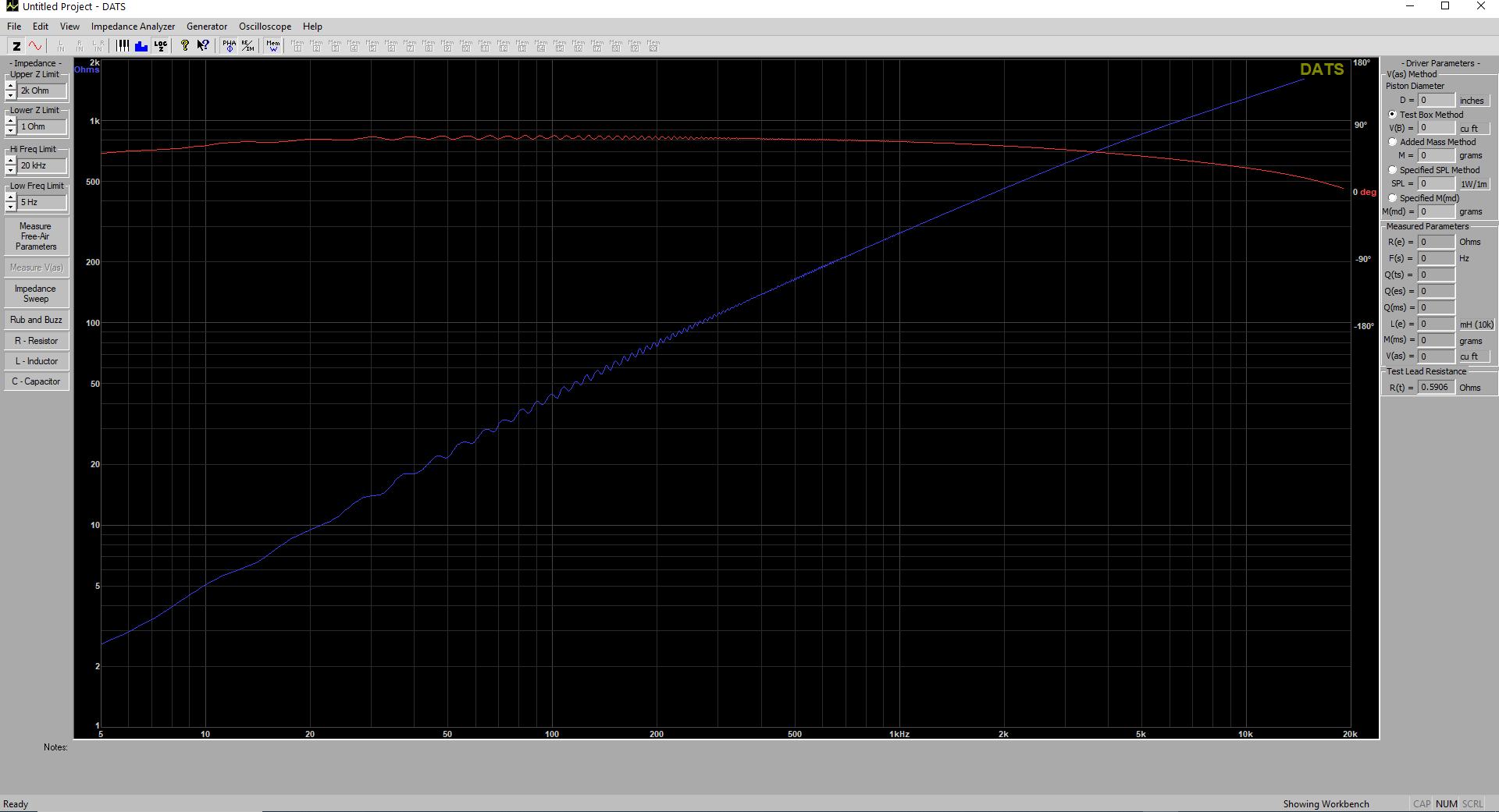

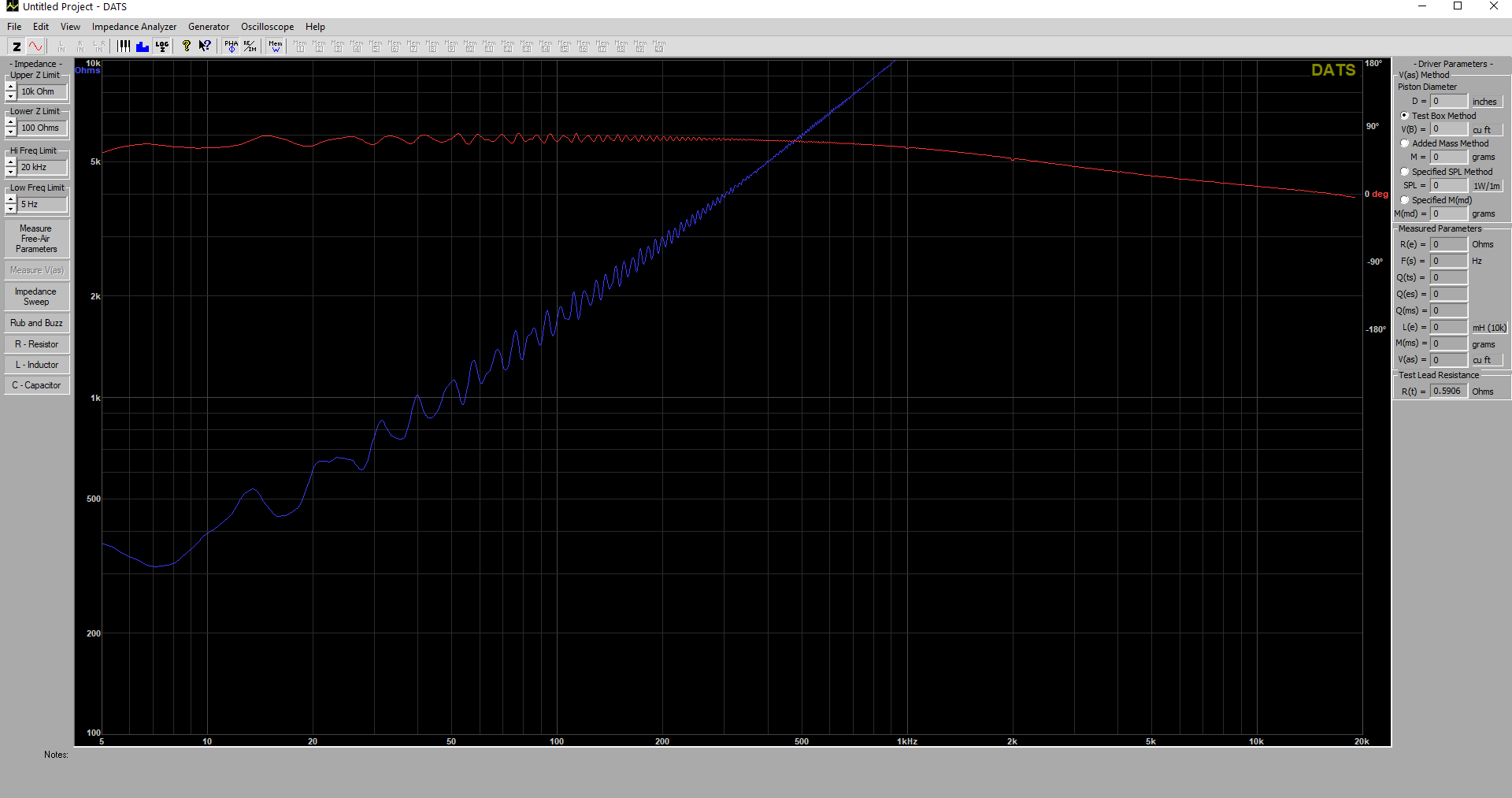

Hi thank you for the very valuable advice
I see that in the datasheets the secondaries DC resistance is mentioned
So I guess that is of some interest
Then I measured the impedance at 50Hz and I noticed that it can be quite higher than the DC resistance
And at higher frequencies even bigger
I wonder if this measure can tell anything about the quality of the transformer
