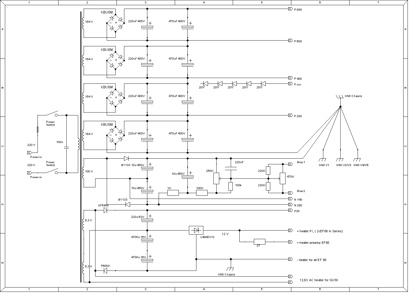

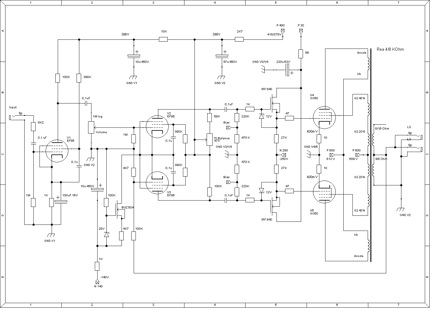

You will find the schematic of the evaluation hardware below. The power supply has a 4 rail structure (200V/400V/600V/800V)including a 5x20V 5W Zenerdiode group. This allows to change the screen voltage in steps of 100V.
The powerstage has a differential stage with EF86 and CCS enabling high peak to peak driver voltage The next stage is then a MOSFET follower to be able drive the power tubes into AB2.
