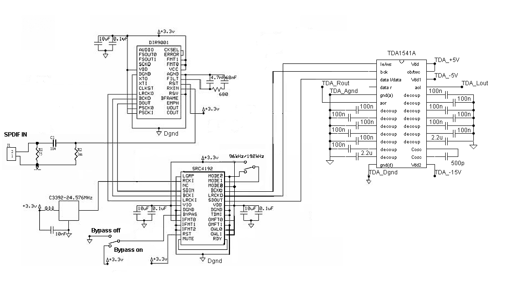

Hello
I would like to connect a TDA1541A to a SRC4192 and a DIR9001
I've done a schematic of it.
I did not include the I/V amp in the schematic but there would be a low pass filter in the I/V amp.
Is my schematic would work ok or do it have any errors ?
Any suggestions ?
Thank you
Bye
Gaetan

Hello
I was not sure if I did chose the right output mode for the SRC4192 to go in the TDA1541A .
For power amps I use LTspice, but for digital things, since I have some concentrations problems on small details and drawing, I alway ask guys to check my schematics, in case of errors.
Thank you

I'm not sure if practice deviates from theory with this chip. But you have your reset pin connected directly to +3.3V. You may need to check this.
The datasheet says:
"The SRC4192 and SRC4193 may be reset using the RST
input (pin 13). There is no internal power on reset, so the
user should force a reset sequence after power up in order
to initialize the device. In order to force a reset, the reference
clock input must be active, with an external clock source
supplying a valid reference clock signal (refer to Figure 2).
The user must assert RST low for a minimum of 500
nanoseconds and then bring RST high again to force a reset."

The SRC4192 seem, for me, the only way to use the TDA1541A at 96khz without oversampling,
The SRC4192 performs asynchronous sample rate conversion.
In principle this is very much the same fundamental process as oversampling, the main difference being that oversampling generally uses integer based math (whole numbers) and is simpler, while up-sampling uses non-integer math (fractions, floating point) and hence is more prone to errors.
So to say that the circuit you show allows the TDA1541 to be used without oversampling at 96KHz is literally true, as in "upsamplig is NOT oversampling", but it is severely misleading if what you want is to operate at 96KHz without digtal filter.
I use my TDA1541 DAC routinely at 96KHz (I have many recordings at that sample rate on my Media PC's harddrive) without a SRC4190 in there, just a CS8414 with a discrete frontend based on Pat "Jocko Homo" DiGiaccomo's SPDIF circuitry directly into the TDA1541 (CS8414 set to output 16 Bit I2S).
I will eventually update the fronend to a WM8805, which is the only receiver worth bothering with in this day and age and can also provide the TDA1541 with 176.4 & 192KHz 16 Bit I2S.
Ciao T

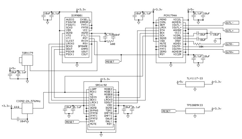

Hello Thorsten
My schematic are just a TDA1541A version of the Micro Dac schematic, that one use a PCM1794A dac chip, but I was presuming that the TDA1541A would sound much better than the PCM1794A. So I've adapted the Micro Dac schematic for a TDA1541A chip.
Here is the original schematic using a PCM1794A dac chip.
Btw, I've seen that the reset of the DIR and SRC chip need a delay of arround 200ms, it need to use a TPS3809K33.
You would need to make sure to set the output from the SRC4192 to the correct format required by the TDA1541. That would be 16-Bit IS2 with BCK = 32*Fs.
There are many ways to handle the reset requirements. It is best to really read the datasheets and all the qualifications about reset conditions (e.g. which clocks need to be present etc.).
