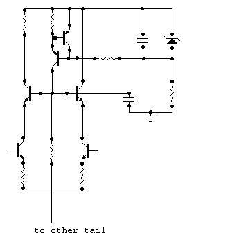

Hi John-china,
A 2BJT current source on each supply feeding a bypassed resistor for the cascode bias and tail currents is in my view preferable as it will improve PSRR and eliminate the zeners. The RC filters in the supply lines can then be removed as the PSRR will be good enough without them.
RC rail filters generally have a considerably higher impedance than the rails and can superimpose stage distortions on their impedance along with non-linear Vas input Z, which then feeds to later stages as signal.
Changing to my suggested configuration with 2 cascode BJTs per side allows the flexibility to try many different variations not permitted by the simple std arrangement, to home in on the best sound.
Greg

Hi John-china,
No not quite. You need to replace the resistive feed from the power supply with the CCS. The second cascode BJT is included as well and may or may not have a load R.
The zener here contributes to a very stable operating point without the noise getting through due to the NFB feedback pair. But the output Z of the CCs is orders of magnitude higher than the original R feed.
Much of the simplicity is lost though.
pic -
Greg

Hi Greg, lots of options, some "simpler" ones:
losing the feedback Q and moving the zener bypass C to the ccs Q base in your circuit will be quieter - it is really "inefficient" to try to filter Zener noise with a parallel cap due to the low dynamic Rz - using RC filtered Zener V as ccs ref lets you use a much larger ccs R, total noise should be smaller than 2 Q ccs shown, if not quite as high in Zout and psrr it is still very good
with the original Leach bias adding a bootstrap resistor to each tail from the amplifier output can hugely increase effective tail impedance if the existing bias R and the added bootstrap R ratio equals the feedback network ratio - won't work all the way to DC with feedback network AC grounded but should give ~50x (1% R's) tail impedance boost over most of the audio range really cheap
I like to see trim pots in schematics like this, manual trimming of diff pair Ic balance is required with single ended outputs - may require vas degen trim for complete circuit balance
JCX,
Another method of trimming the current balance in a diff pair is to either trim the load on the single ended output (normally a current mirror, so merely alter the CM degeneration), OR trim the base bias resistor on the input (with matched LTP of course). This avoids unbalancing the gain of the LTP outputs; an advantage for distortion cancellation even if the output is in SE.
cheers,
