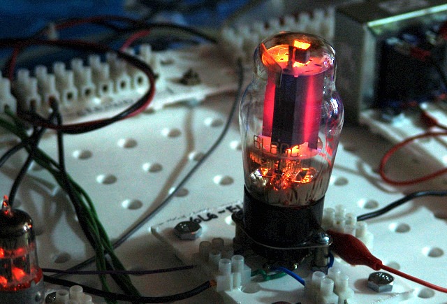

During the time that I transitioned back to tube guitar amp building from solid state I bought some Orion branded Russian tubes from a well known and recommended Ebay seller in Hong Kong. The "6L6GCs" were OK and survived my abuse. The EL34's were not so good. I got a bunch of each, but don't remember how many. I have 4 Orion 6L6GCs left and they have obviously been used. There are 2 of the EL34's left and they don't look used. I know I had issues with meltdown in the EL34's and sentenced a few to "death by power supply."
I got a pair of Chinese "Coke Bottle" shaped 6L6GCs from Antique Electronic Supply for about $10 each after they stated that "we couldn't blow these up no matter how much we tried." I took that challenge, and despite making them look like this a few times, I still have them, and they still work! The Coke Bottle 6L6GCs were discontinued and the straight sided version that took their place weren't so tolerant.
That was about the time that I found the 6AV5 and never looked back. You can squeeze them for 80 watts per pair and they just laugh it off. I kept pushing the sweep tube envelope higher and higher until I set an OPT on fire at somewhere beyond 700 volts and 150 watts with 6LW6s which just came out when I left the TV repair world. The fireball and permanent black mark on my workbench was due to my Radio Shack dummy load bank blowing open due to being fed far too much power. That's when I bought the pair of 8 ohm 500 watt resistors I have used for 20+ years. Unless proven otherwise I run any horizontal sweep (line output) tube at 150 volts on the screen. Very few need something different. Those are generally older tubes.
