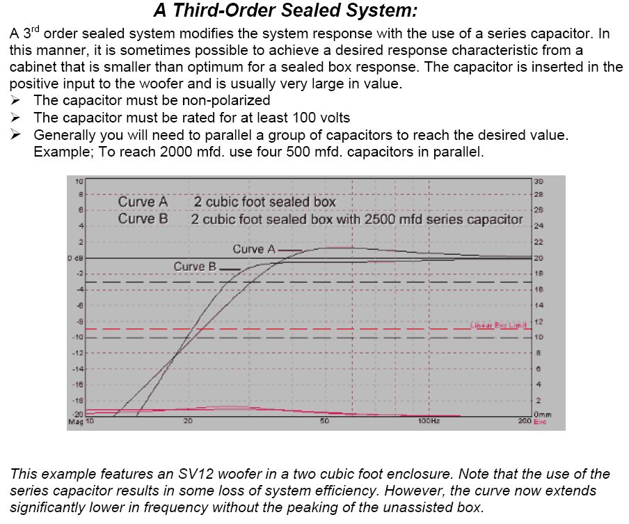

About a series capacitor with closed-box loudspeaker
hornresp and its passive filter utility sorts 3rd order boxes quickly. Here's an Eminence Omega Pro18A in 80 liters box- 56.6 liter might be better.
My soon to be run boombox has a GRS 10PT for its point on channel
