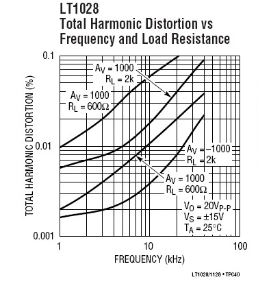

It's better to use a modern opamp. This technique was a sign of missing good low noise opamps. You may check for opamps with noise figures of 1 nV/Hz or so. AD797, LT1028, AD4898 etc.

you can take advantage of the fact that the transfer linearity in most op´s is much better
then the common mode case. that requires to use the 0p with phase inverting shunt feedback. you can see that the LT1028 distorts much less if you go for an inverter stage (see distortion at -1000)
there is another circuit that has no common mode distortion and high input impedance if the input impedance of the shunt stage is a problem.
