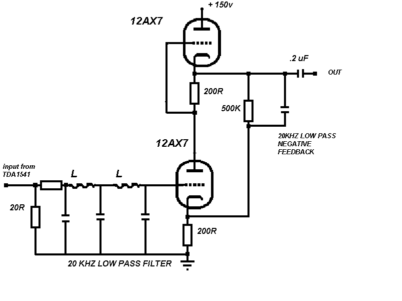

I have done a I/V tube ouput for a Nos TDA1541A dac, I use 12AX7 tube because I have many of this tube.
Any suggestions about my schematic ?
And I would need formulas or suggestions of L and C values, for the input 20khz low pass filter and also for C in the negative feedback 20khz low pass filter.
Is better a LC filter or a RC filter at the input ?
Thank you
Bye
Gaetan

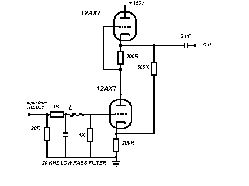

My first version of the the input 20khz low pass filter was to high order and would have a very bad phase response. So I have done a second version with a 2nd order Bessel filter.
I have taken out the negative feedback 20khz low pass input filter.
Thank
Bye
Gaetan
