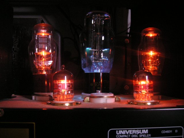

just a fast question about what to expect (visually) from an 83 rectifier
i found this pic googling around, now i'm building an aikido using the 83, but the blue glow is barely visible with lights off, and nothing anywhere near the below pic..
is just me that i'm expecting too much or it is right this way?

Ahh, mercury vapor rectifiers. I remember them from RCA TV transmitters. How much they glow is dependant on the current flow thru them. If they ever start turning green, its time to change them out or you will be off the air.

yeah... didn't tought about current flow, the above video told me why i don't see the nice glow i was expecting, the tube is working at more or less 30mA, not enough to make the vapour glow
And I remember Mercury Vapor rectifiers in AM transmitters too. You could watch the modulation in the brightness of the glow.
Just make sure the filaments are hot enough before you apply the high voltage!

I let my NOS 866's warm for 2 days when I first get a new set.
Arc over is a very real possibility with these type rectifier
I've never used a mercury vapor rectifier, myself, but I remember a couple things from USAF Ground Radio Tech School in '74/'75. Application of plate voltage to an insufficiently heated mercury vapor rectifier results in catastrophic arcing and Air Force equipment that used those rectifiers usually had a thermal time-delay relay in the plate transformer keying circuit to prevent pre-mature power-up.

The Aikido is a small signal amp that doesn't pull very much current. You won't get much glow out of an 83 that way. More current, more glow from MV power diodes.
