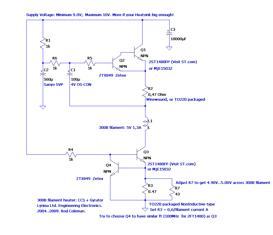

Hi guys:
Just started building a 300B SE, the original design connect +5VDC to one filament, and the other to ground.
I want to implement a Coleman regulator, apparently I can't connect one filament to GND, which shorts the CCS part of the regulator.
Can I just connect F+/F- to both sides of filament without grounding? or any filament resistor needed?

Oh, I build this TSE on my own, basically I experimentally separate them into PSU and Mainboard, so that won't be an issue.
After reading, I think what I meant is "bias resistor", the TSE put 5V into 300B then grounded.
What I want to ask, is that with Coleman's Reg, any filament resistor or cathode resistor needed? Like figure below?
Thank you,
erik

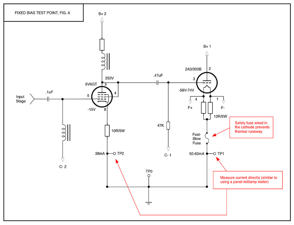

The TSE output stage is fixed bias.
Maybe questions about the specific implementation of that filament regulator would be better addressed to its vendor / designer?
I would strongly encourage you to get the TSE working in completely stock configuration before you attempt to modify it.
Win W5JAG
edit: most (all ? ) TSE builders use the 10 ohm resistor in the plate leads to measure current through the output tubes.
