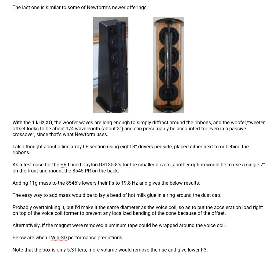

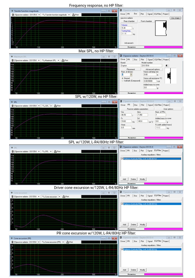

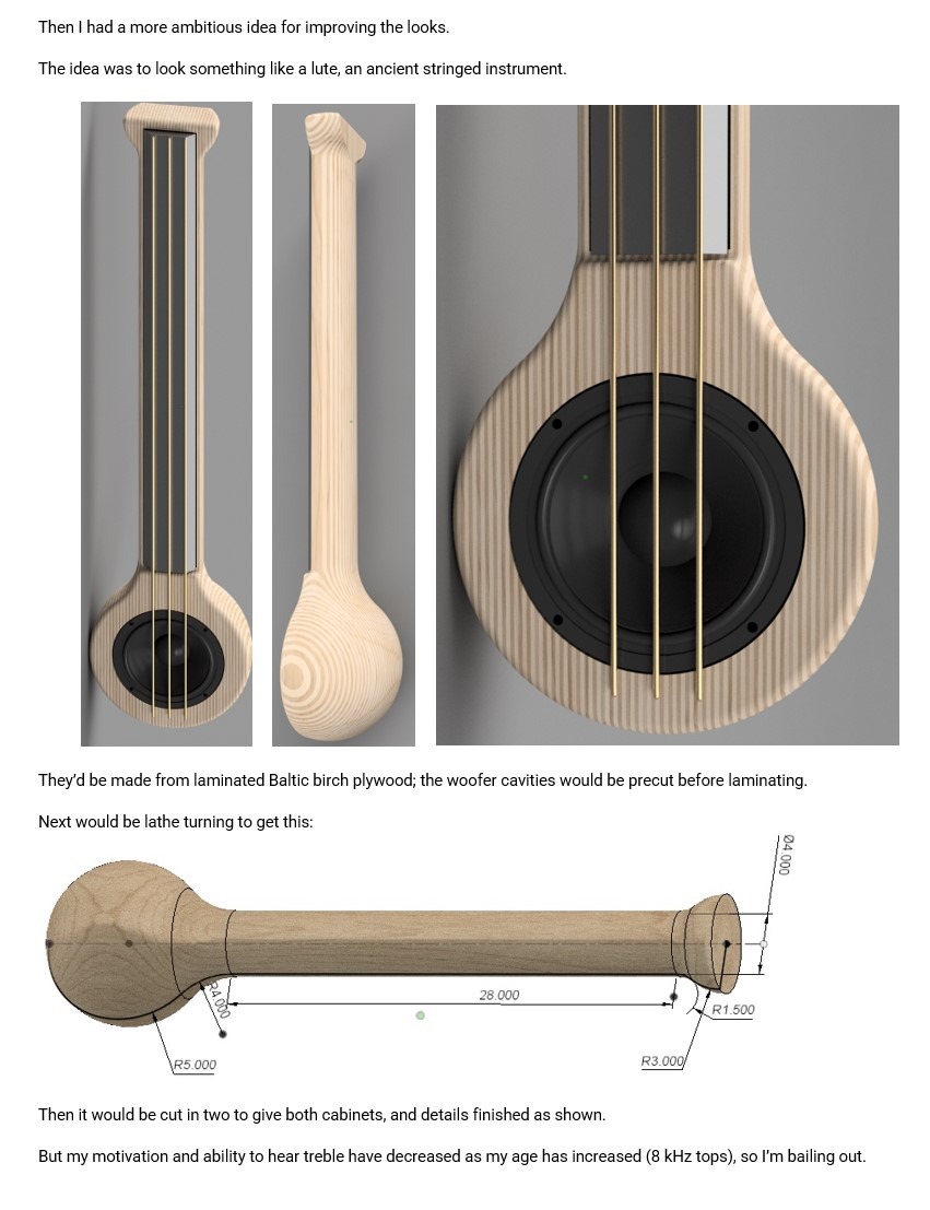

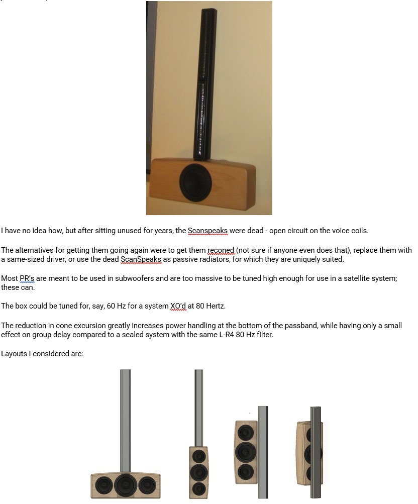

Originally, I built these using Newform Research R630 components: R30 ribbons and ScanSpeak 18W/8545K woofers, and Newform-built crossovers and put them in solid maple sealed boxes I made [I was having trouble inserting pictures within the text, so the rest is screen captures]
