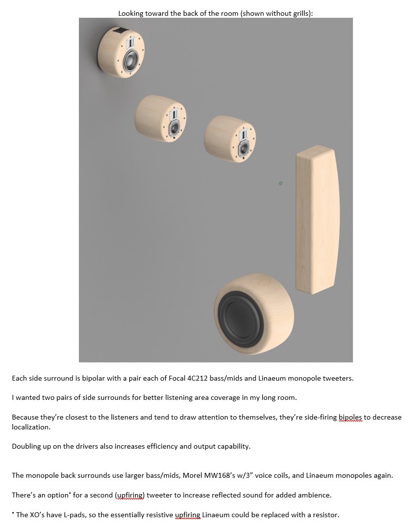

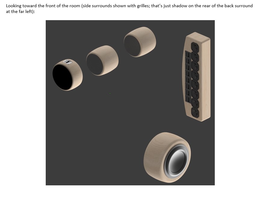

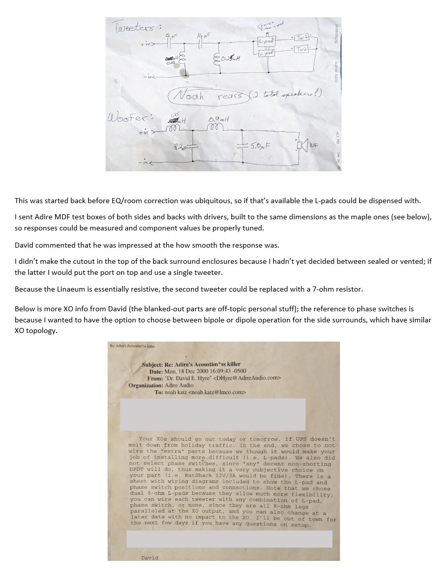

This project is/was line array fronts, bipolar side surrounds, monopole back surrounds, and a pair of subs (left side shown).

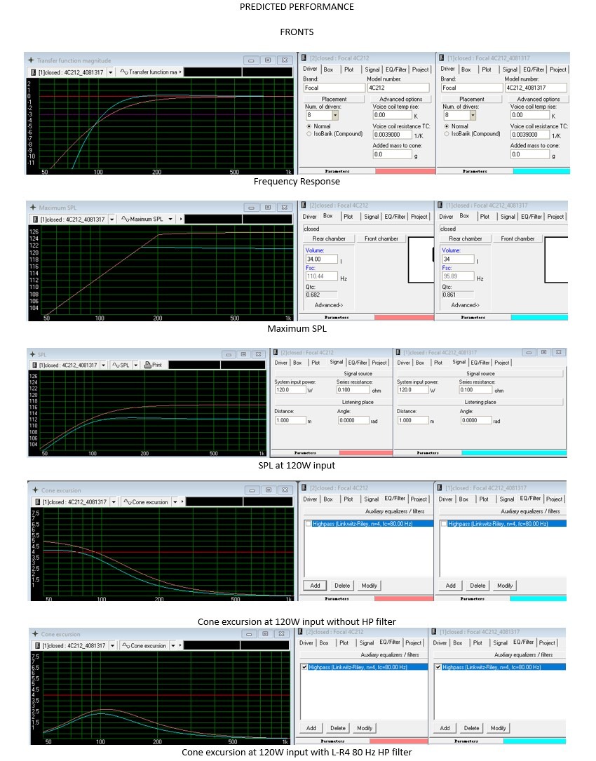

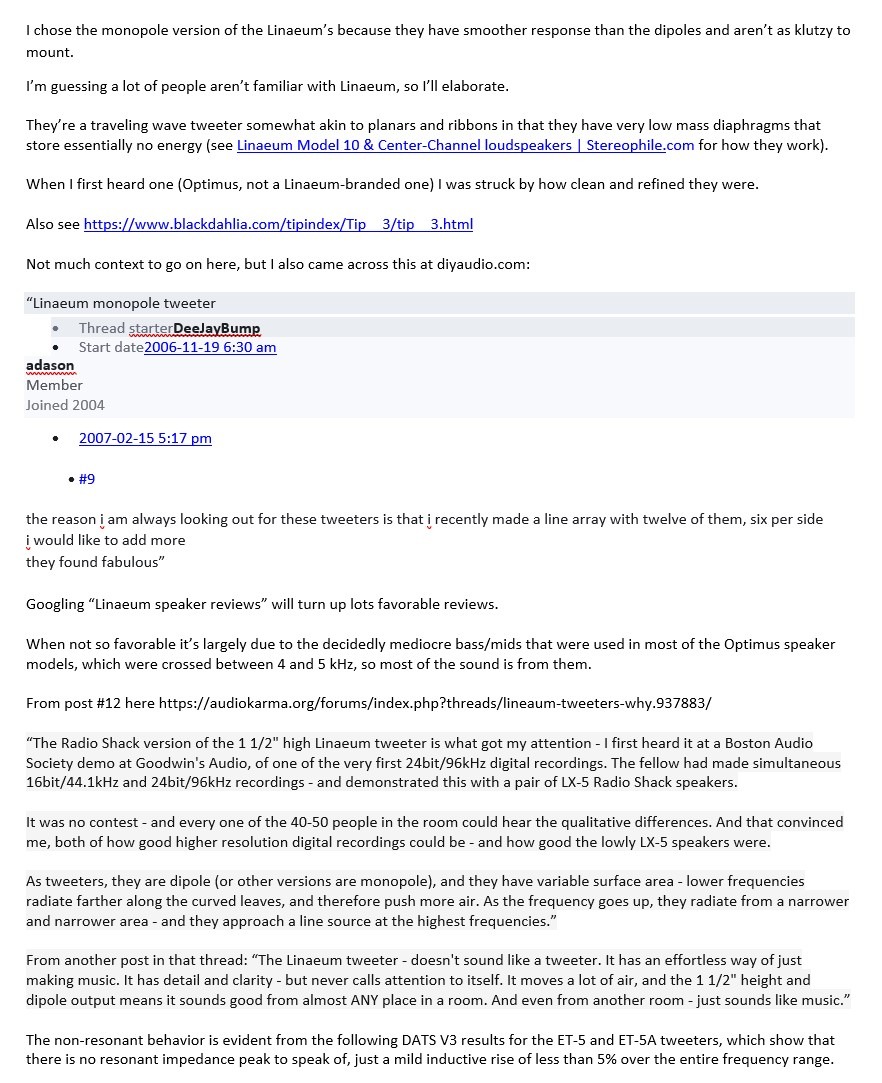

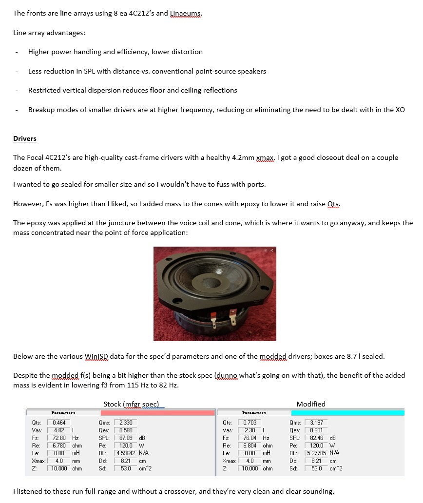

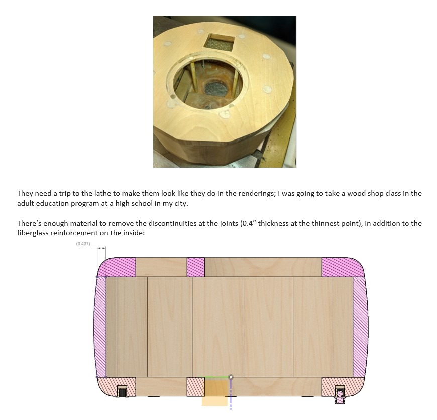

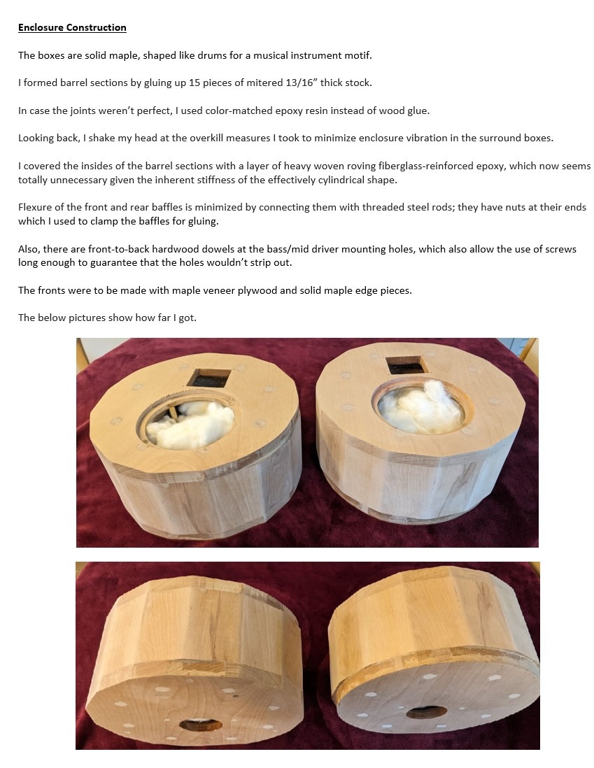

I was having trouble inserting pictures within the text, so the rest is screen captures.
