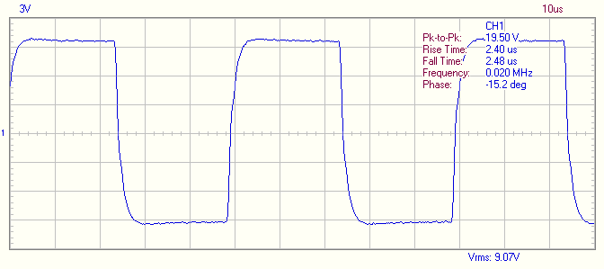

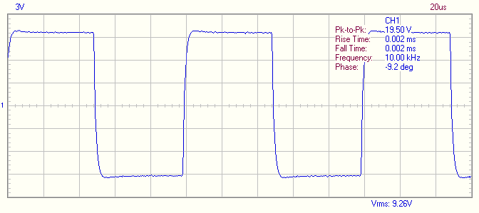

AB100 Class AB Power Amplifier
Only have plug n play, but here you go
Regards

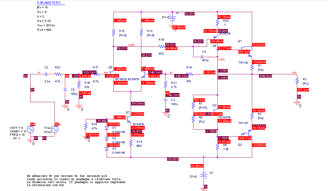

Hi guys, I'm pretty new in the audio diy but I'd like to get better, and I could really use a help from you all, please. I've been trying to build a class AB amp myself with TIP 142/147 Darlingtons, so I saw the AB100 and I found it great and not so different from mine.
Here is the schematic, I tried some simulations on Spice and it seems to work fine: but when I built it, I had (and still having) tons of problems. For instance, when I try it with no load it actually works pretty fine, but then I try a 15 Ohm resistive load or a 4 Ohm speaker and it starts ringing like there's no tomorrow (around 4-6 MHz). Ringing kinda decreases a little when I bias more the output stage (slightly higher values for R7), but nothing good anyway. Do you have any advice for me? Some changes to be made? Or would it be better to start over with a new schematic?
Thank you very much!
Giovanni
Layout, grounding and signal returns can be crucial on designs like this.
I don't see any Zobel network on the output.
It might be worth looking at adding a small (10pf or less) across R18 and see if that changes things.
Also add a small cap across the vbe multiplier (say 4.7uf or 10uf)
Using a resistor load (R5=1k5) is unusual.
Have you considered and rejected the usual options of Bootstrapped and Active (current sink)?
You have matched the collector load currents of the LTP.
But ignored the current injected by the VAS.
The LTP currents end up not being matched.
C4 (Miller compensation) is unusually large. With only 1.1mA available to charge it, slew rate will be severely curtailed.
Consider where local decoupling can be added to maintain performance at HF.
Thanks for your answers, first of all. Well, I didn't thought of a Zobel network actually, but I'll try. I imagine that I'll have to measure the series inductance of my speaker: given that I haven't got an impedance-meter, should I measure it manually with a sine wave at different frequencies or is there a simpler method?
Then I'll add a few caps where you told me and I'll tell you...just a few questions for AndrewT: can you provide an examples of what you call "Bootstrapped and Active (current sink)"? A resistive load was the simplest solution that came to my mind and no, I did not think of the usual solution (maybe I didn't even know...)! One more thing: what do you mean by VAS? Because if you mean the gain stage (Q8 with its R19) I thought I could neglect that base current...what should I do to match the currents correctly?
