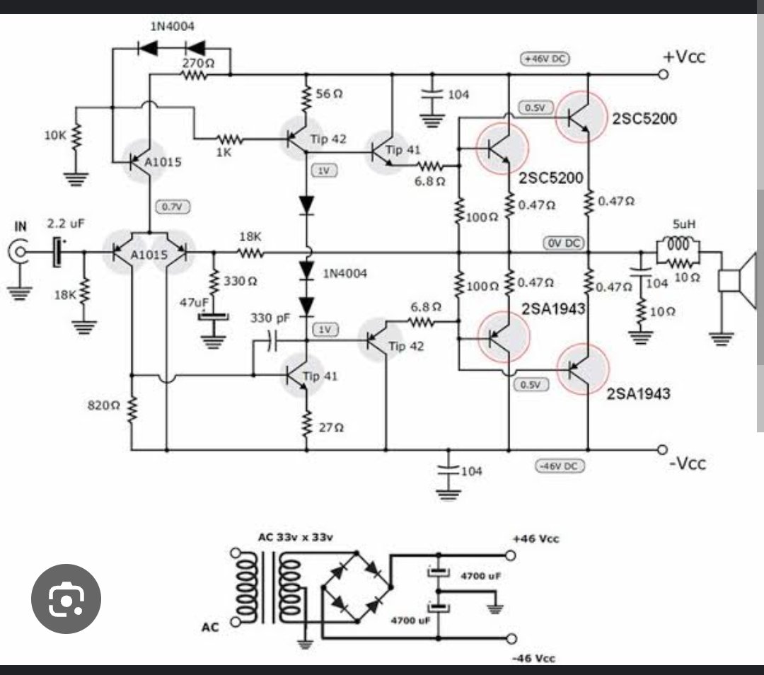

Hi i attachment a file. This is ab class amplifier. İ wonder this circut math analysis. İs there any body teaching this circuit analysis?

Start by breaking the circuit up into pieces.
You have two CCSes: One that feeds the differential pair at the input and one that feeds the bias spreader (three diodes in series) and VAS. There's the differential input stage and common emitter VAS (TIP41 with miller compensation, 330 pF). You then have an emitter follower driver feeding an emitter follower output stage with two devices in parallel per half. Now that you know which LEGO blocks are in the circuit, have a look at a textbook like Sedra/Smith "Microelectronic Circuits" and analyze the circuits.
I'm curious what you intend to get out of analyzing the circuit mathematically. You can certainly do that, but the math gets hairy pretty quickly. You'd get far more out of simulating the circuit.
