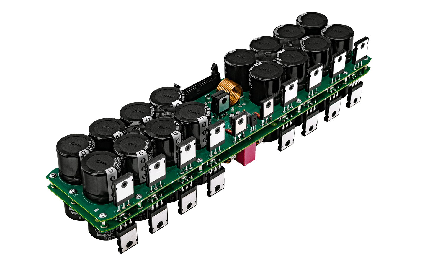

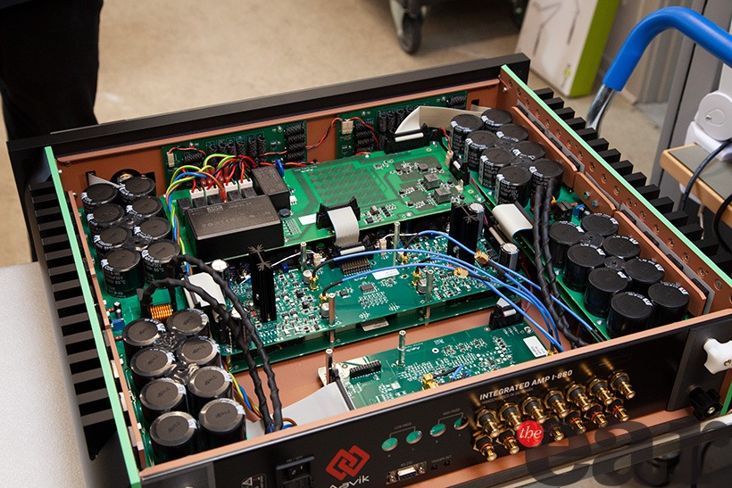

I have had a chance to attend PAF convention where I gave a listen to this amplifier by Audio Group Denmark, and in my opinion it sounded better then all others. Official website has few pictures of the inside and describes it as Class A, but only biased when needed. To me the board looks like Class AB, just overbiased. Wondering if it is possible to determine such things from the picture of PCB?

I like the fact that the power supply capacitors are placed so close to the output transistors.

I wonder if those are just decoupling capacitors? Seems like power supply is a separate unit… I might be mistaken thoughI like the fact that the power supply capacitors are placed so close to the output transistors
That is the power/calories available for the output transistors. I do not know if that amp has a separate PS PCB, though.
Nevertheless, in general, I like this approach specifically because of all the unknowns associated with a conventional design, where the power supply capacitor bank is located away from AMP PCB, and in particular....
... the wiring length, wiring type, wire diameter, capacitance used on the PS PCB (amount, type), PS PCB design (tracks geometry, thickness)
are simply placed outside of the equation that has to ensure a uniform, low, broad frequency spectrum.... power supply/rails' impedance... available right where it is needed.

I see the 2X SIP connector. That looks like just a output stage. Input stage connects with a flat cable.Wondering if it is possible to determine such things from the picture of PCB?
Vbe present means it is a class AB. Connector could also be for the protection circuit.
OS
Non-switching class AB (at best). Technically , it is class A - never switches. I've designed these , could not tell the difference from a quality AB EF3.Aavik have designed a circuitry that constantly keeps the bias spread 0,63 V above the required current, no matter where it is in the cycle. So, no matter how much current the power amp requires to perform, it always stays in Class A up to an impressive 2×200 W into 8 ohms, while at the same time not consuming unnecessary power.
"Real" (true) class A will typically use MOSFET's and have huge heatsinks. 50W class A will have the same thermal solution as a 250W AB.
OS
Spot on - Aavic 880 IS a OPS/separate IPS non-switching "fancy" amp ! Such a small return for the perverse complication of the circuit-layout.
