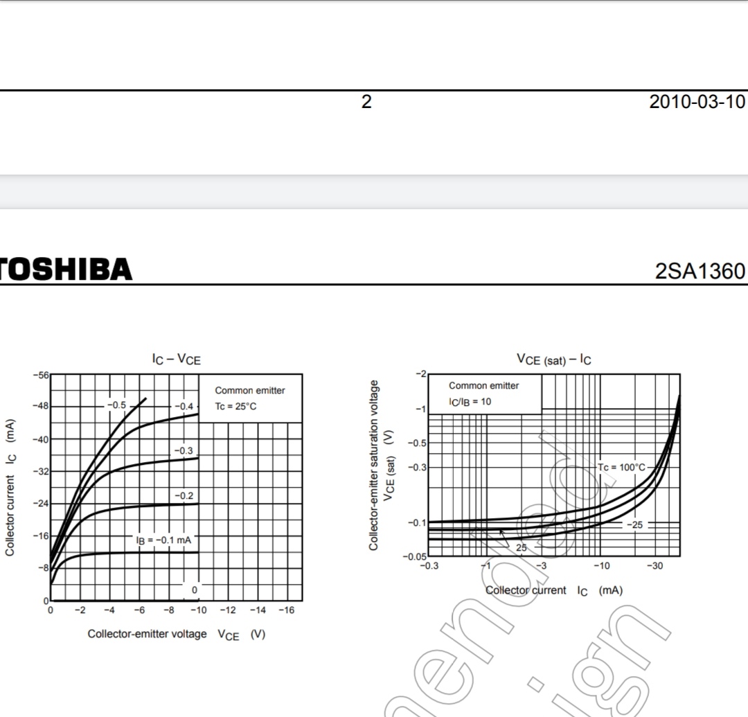

It appears that Toshiba underrated their device by a massive margin. The attached is from 2SA1360 datasheet, doesn't look that fantastic. Comparing with the curve tracer readings of the same device shown in the thread, if genuine and accurate, Toshiba's datashheet seems to be referring to a wrong part.
I am aware of these graphs and, from my experience, try to confirm what I measure. My whole professional career I've been measuring "invisible" quantities. I am a chemist.
I have done these measurements side-by-side and I have verified wiring. If there is some source of errors they should reflect similarly (not, equally) on every measurement.
But, as sajti has stated, this "shortcoming" can be avoided by clever selection of operating parameters. Unfortunately, just in the design stage.
I will investigate this subject further.
