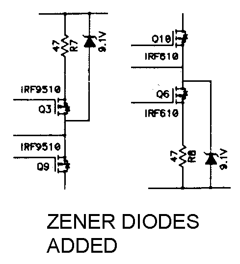

In case you were not aware -
In the PC artwork of the original A75 boards
in Audio Amateur, there are three resistors
mis-labeled. The schematic is correct.
R22 on the PCB is R24 on the schematic
R26 on the PCB is R81 on the schematic
R24 on the PCB is R26 on the schematic
In addition to this, it is worth noting that
a modification was made in improve the reliability
of the front end when the amp is overdriven. Two
Zener diodes are added as seen in the diagram:
Thanks Nelson.
I just only follow the document from DIYPass provided. Not sure there will have same problem to Audio Amateur.
Indeed, I found the mistake label on PCB, but you must aware it when stuffing components. Anyway I will check it again with respect to your reminding.
I think my circuit still have some problem. Perhaps due to above wrong things was be ignored. An unusual matter report, I touch the FETs feel their temperature very high. ( about 45-50 degree). Especially which happen in Q3,Q6,Q9,Q10 the folded cascode part.
Add two zeners into the circuit is wroth to do.
