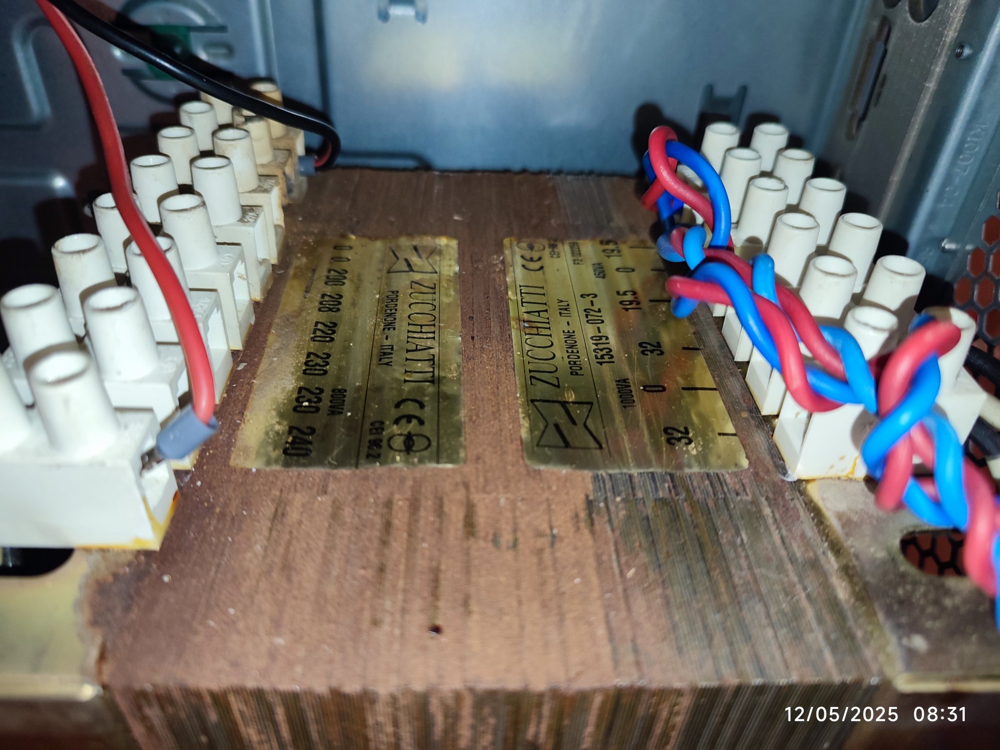

Also, take a photo of your transformer and share it with us here.
Hello! Thanks for your time! I guess they have used this kind of terminals because it is time-saving if they test them...plug and play and they have the Q.C. sticker on the board, so the boards should be tested...🙂
This is my transformer. I have always liked toroidals. Maybe I will upgrade it...it is supposed to be better. Does someone tested the difference in sound quality between toroidal and this kind?

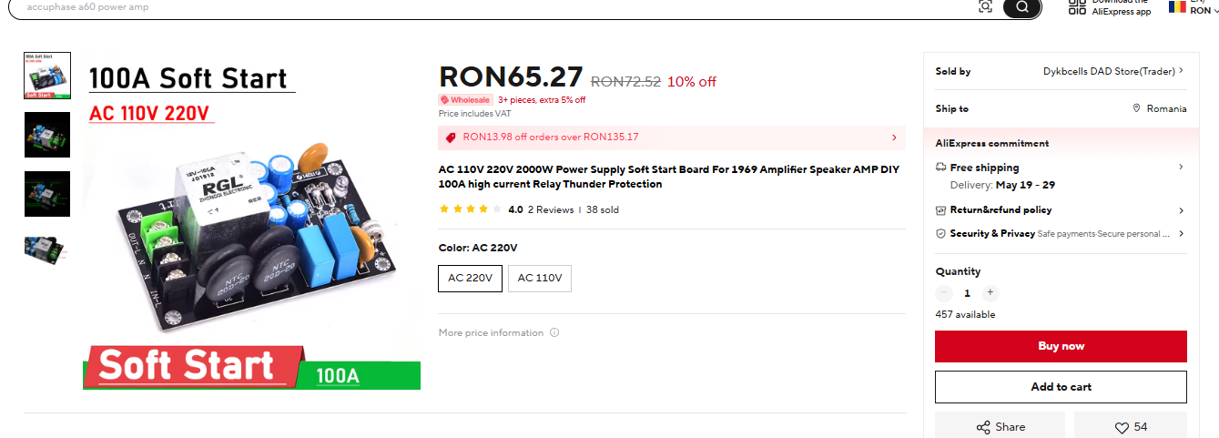

It is powered on by this softstart...

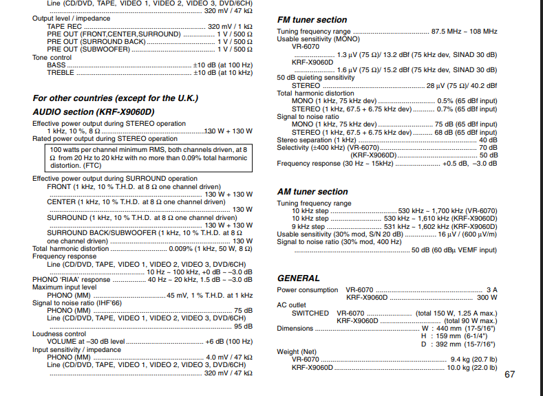

I have used this transformer to power a TDA7293(perhaps fake one-because of the price...) based board and it sound like my KENWOOD KRF-X9060D
amplifier. I did not perform extensive comparisons...just left channel Kenwood, right channel TDA7293 board...powered by the below transformer 20-0-20 did not hear difference at low power..This transformer makes some noise...do toroidals makes this kind of noise..or are they silent?

Just remove them carefully and provide a photo or schematics of yout transformer.

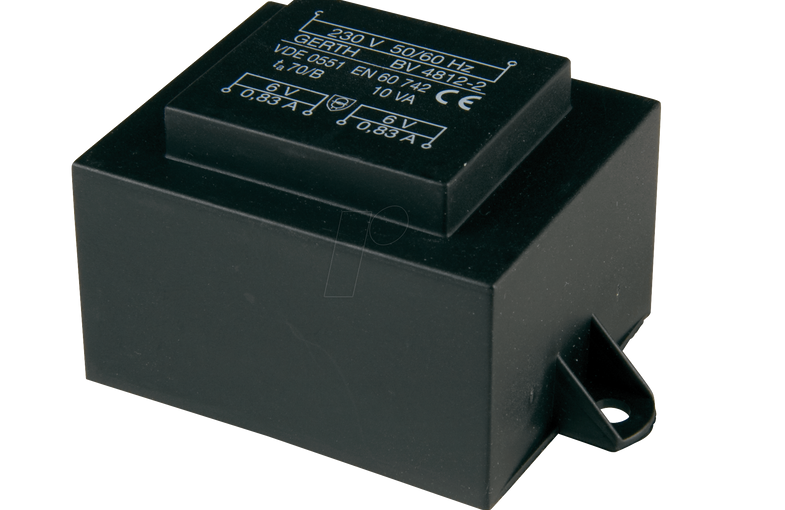

You will need additional transformer for on-board speaker protection 230VAC to 2X12VAC. 10 VA should be enough. Look at the attached data sheet.

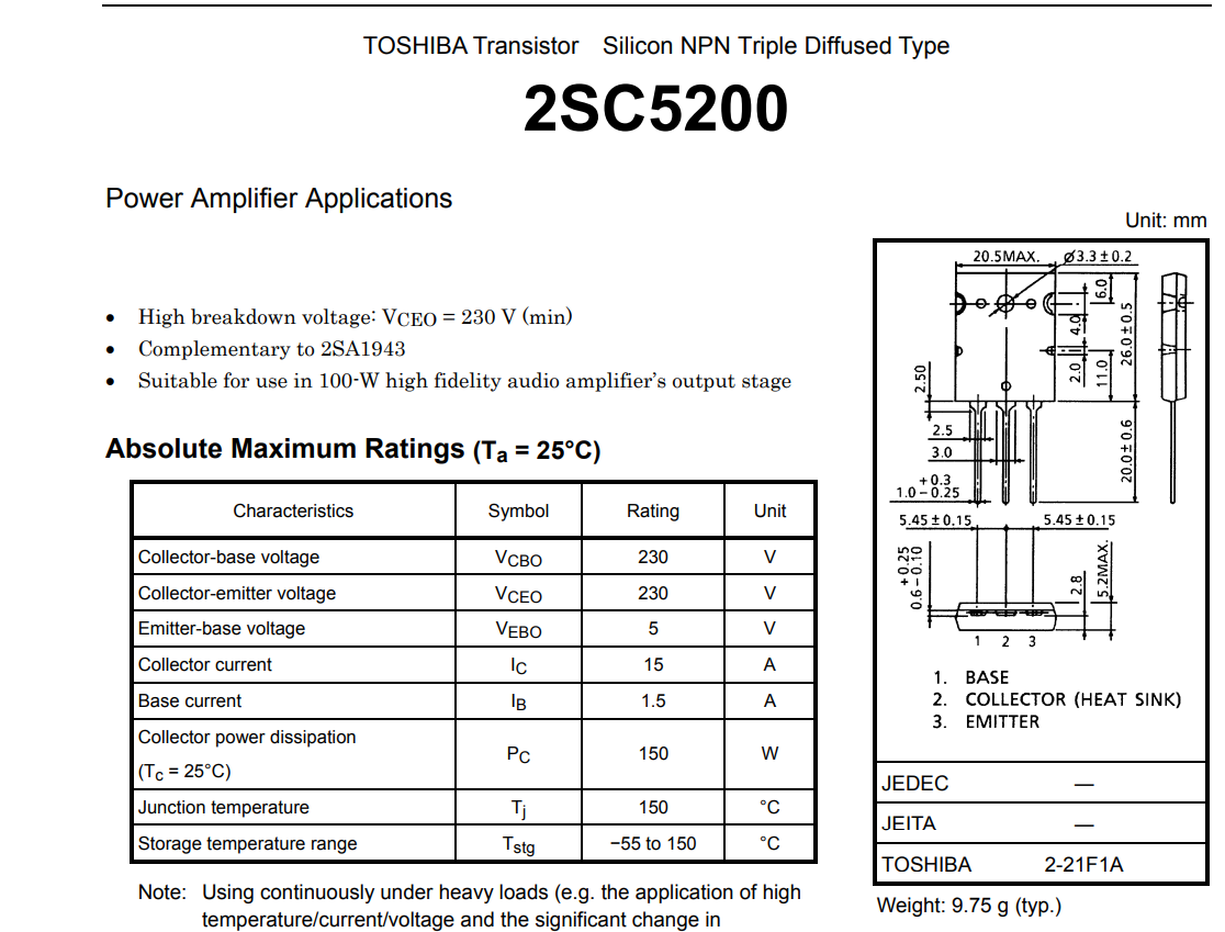

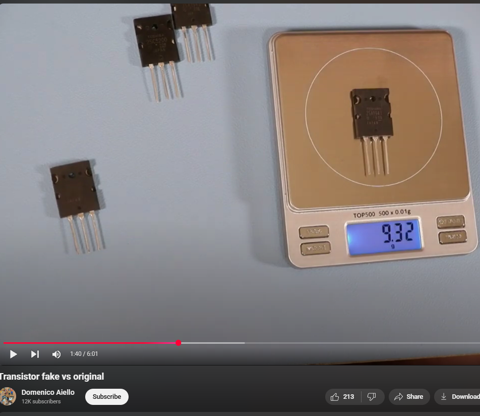

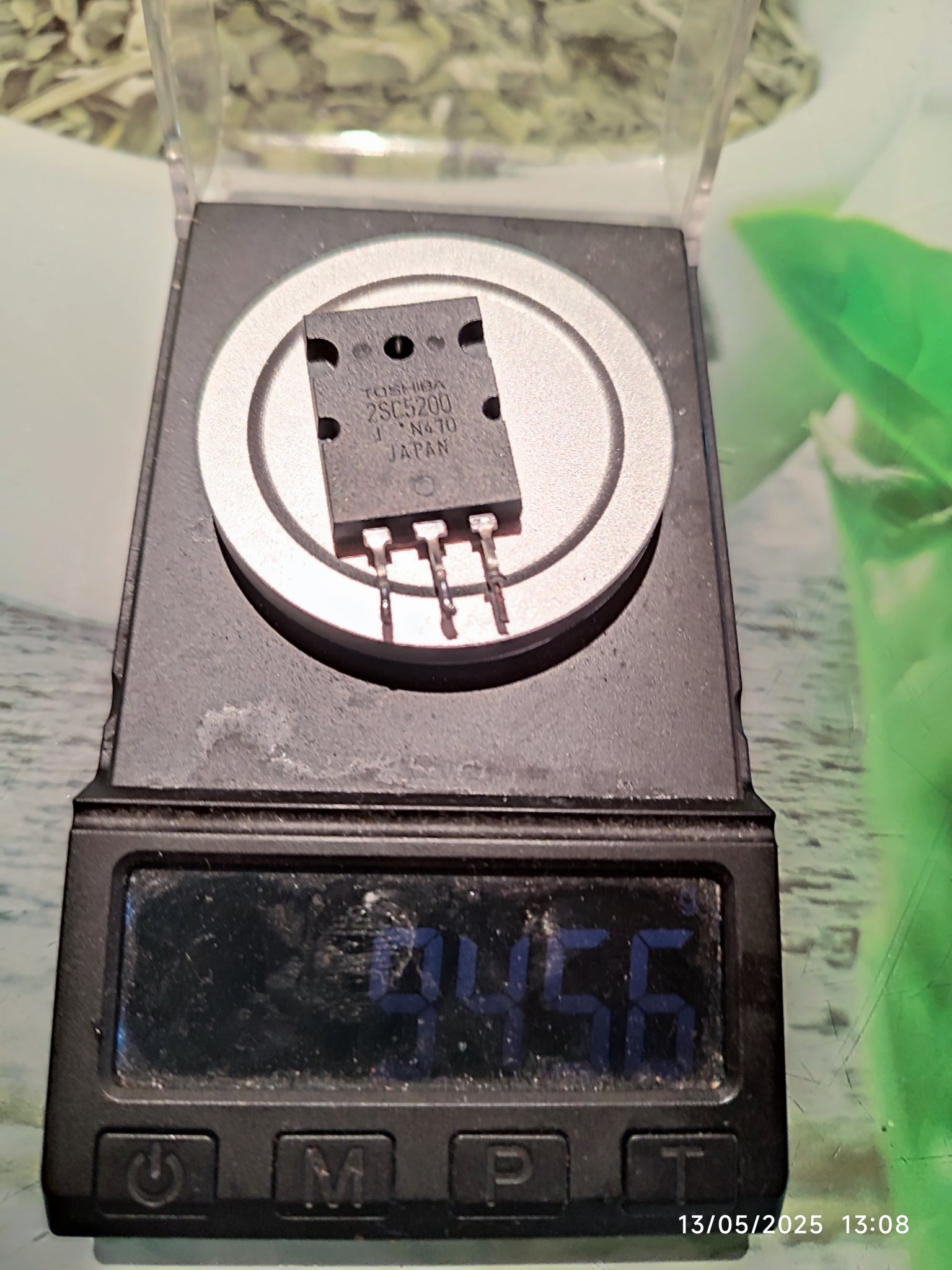

I have measured the capacitance between base and emitter of the desoldered perhaps fake Toshiba 2sc5200 and the result is 6.16 nF. Can this be used without catching our house on fire?🙂 Or shall I return the product?
