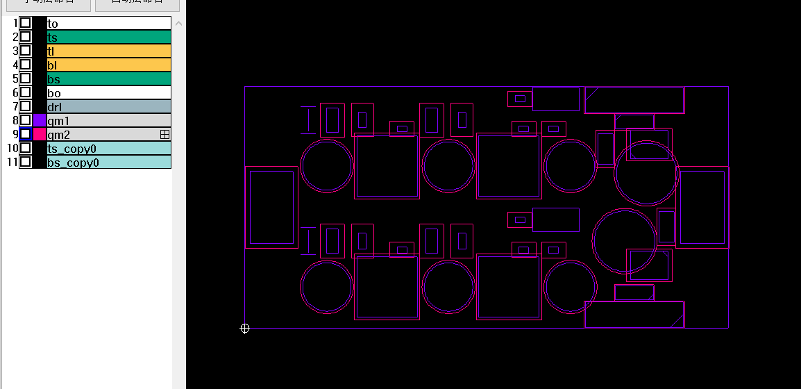

JCLPCB is complaining about a layer:
"As shown below,the outline layer are too mess ,can we ignore the intenal lines inside the boarder of outline layer ?"
As I'm not entirely sure what they are on about, maybe they are referring to the two top and bottom boxes on the right side touching the edge and is cut off in their picture? If you agree I think it's okay to approve their suggestion.
Jim
Jim
Hello Jim,
Yes they can.can we ignore the intenal lines inside the boarder of outline layer ?"
Their software sees the places where the components are placed as cuttings and is not that we want.As I'm not entirely sure what they are on about, maybe they are referring to the two top and bottom boxes on the right side touching the edge and is cut off in their picture?
