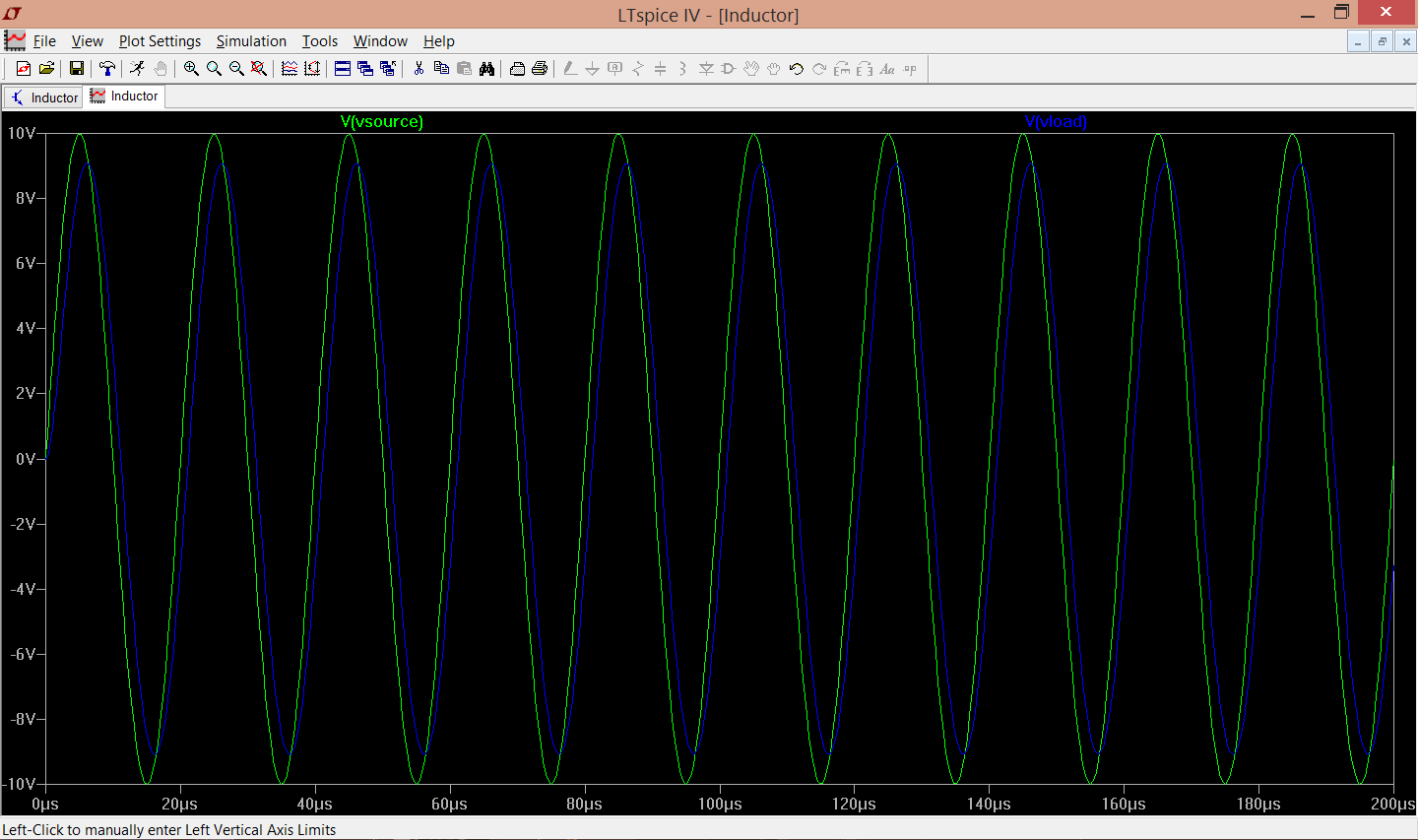

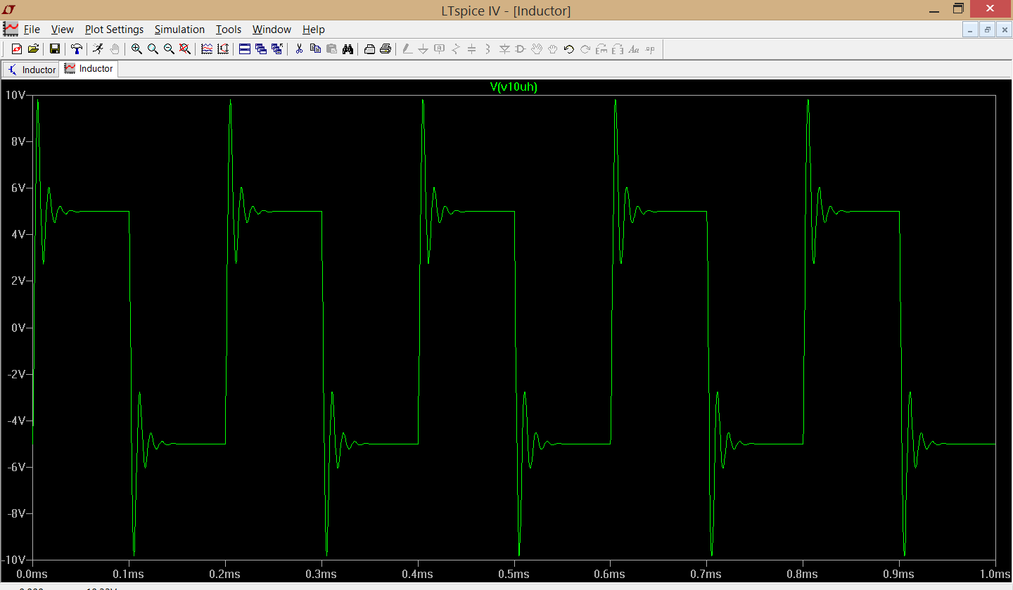

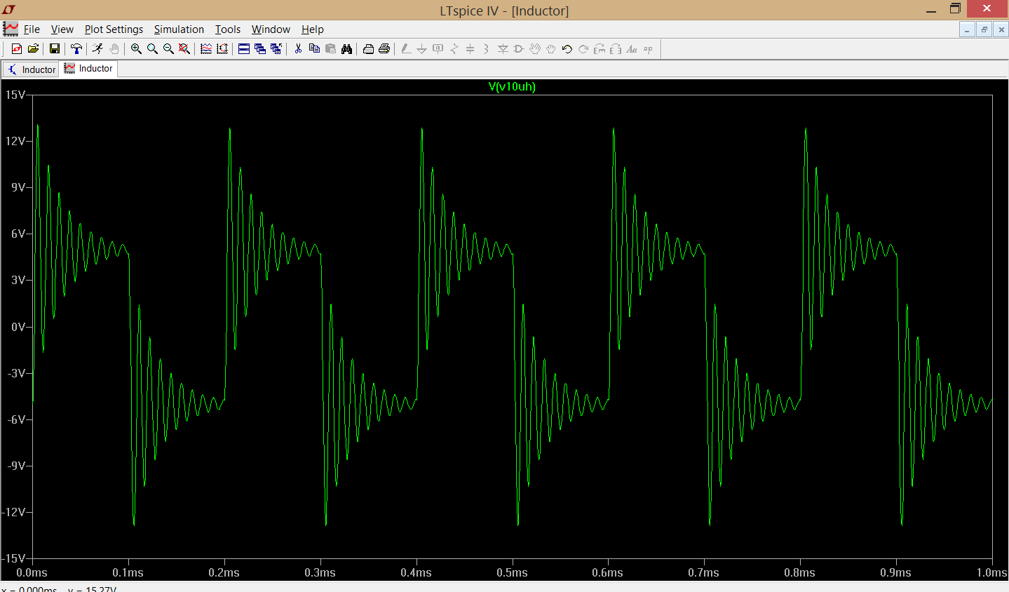

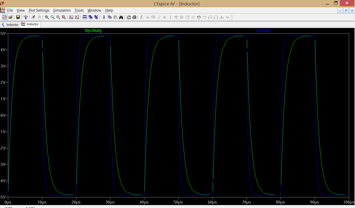

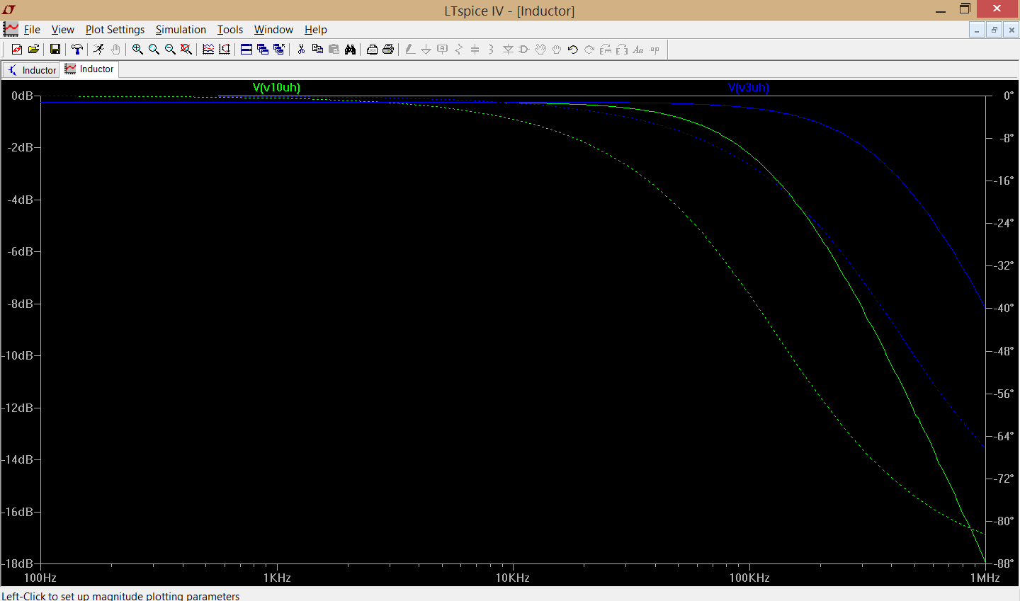

Here is your set up and the response with a 10uh and a 3uh coil. And squarewave of 50kHz into 8 ohms.
Also, here is the response at 5kHz with a squarewave using the 3uh value and when the amp is loaded capacitively. Look how the parallel resistor damps the ringing (last picture).

So 10uH is still a very high value? Sorry in the first response graph I can see solid lines and dotted lines for both 3uH(blue) and 10uH(green) inductors. What does dotted line signify? the solid line case, I can see attenuation is less than 0.2dB at 20Khz?
Its phase. This shows the voltage source and the voltage across the load at 50kHz.
Around 1V attenuation at 50Khz? I am happy to barely meet 20Khz as STK chip as such is not an "Audiophile" component. I am getting ready to solder the chip and do the actual measurement on a 20Khz sine-wave through the network.
