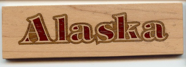

I see you already found a solution but I was going to recommend laser engraving the speakers and then either placing laser cut inlays or something similar into it. This is the type of equipment that I deal with, here is an example of something pretty complex that one of our customers did.
