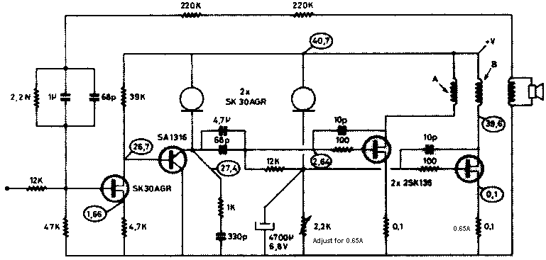

I was looking at this schematic of Pierre Johannet published on "L'Audiophile" and called "Super Némésis Compensé", seen on this French site:
https://www.bonavolta.ch/hobby/fr/audio/2sk135se.htm#2SK135 Single-Ended 3
"To improve the bass response and use a transformer without an air gap (larger primary inductance), it uses a second primary winding to avoid saturation of the magnetic core. This primary is powered (without any signal) by a second 2SK135, the current passing in an opposite direction cancels the magnetic field of the first primary."
I was thinking about a compromise to avoid any extra power consumption: use a custom dedicated winding on the OPT to supply the driver of the SE power tube, then helping to avoid core saturation (air gap still needed).

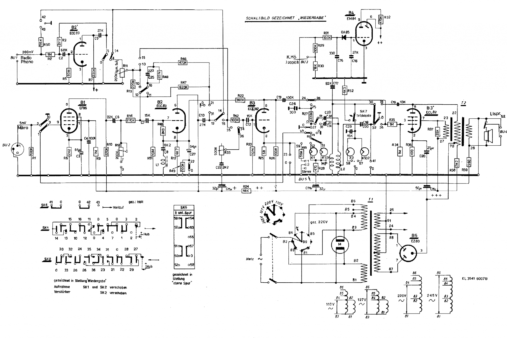

Searching for possible previous examples of this idea, I've then found Philips EL3541 amp with a similar approach (look point 70):

I dont think this arrangement is intended to undo/minimize core saturation. As far as I know its function, together with R38, is to lower power supply hum. The amount of windings between point 70 and the bottom of the primary is very low.

BTW, I don't see the point of the Philips circuit in regards to OPT core saturation...? Isn't it just an ultra linear connection?

The OPT has an ultra linear winding labelled 23-27 but TS meant the part of the primary between point 70 and R38. See my post #2.BTW, I don't see the point of the Philips circuit in regards to OPT core saturation...? Isn't it just an ultra linear connection?

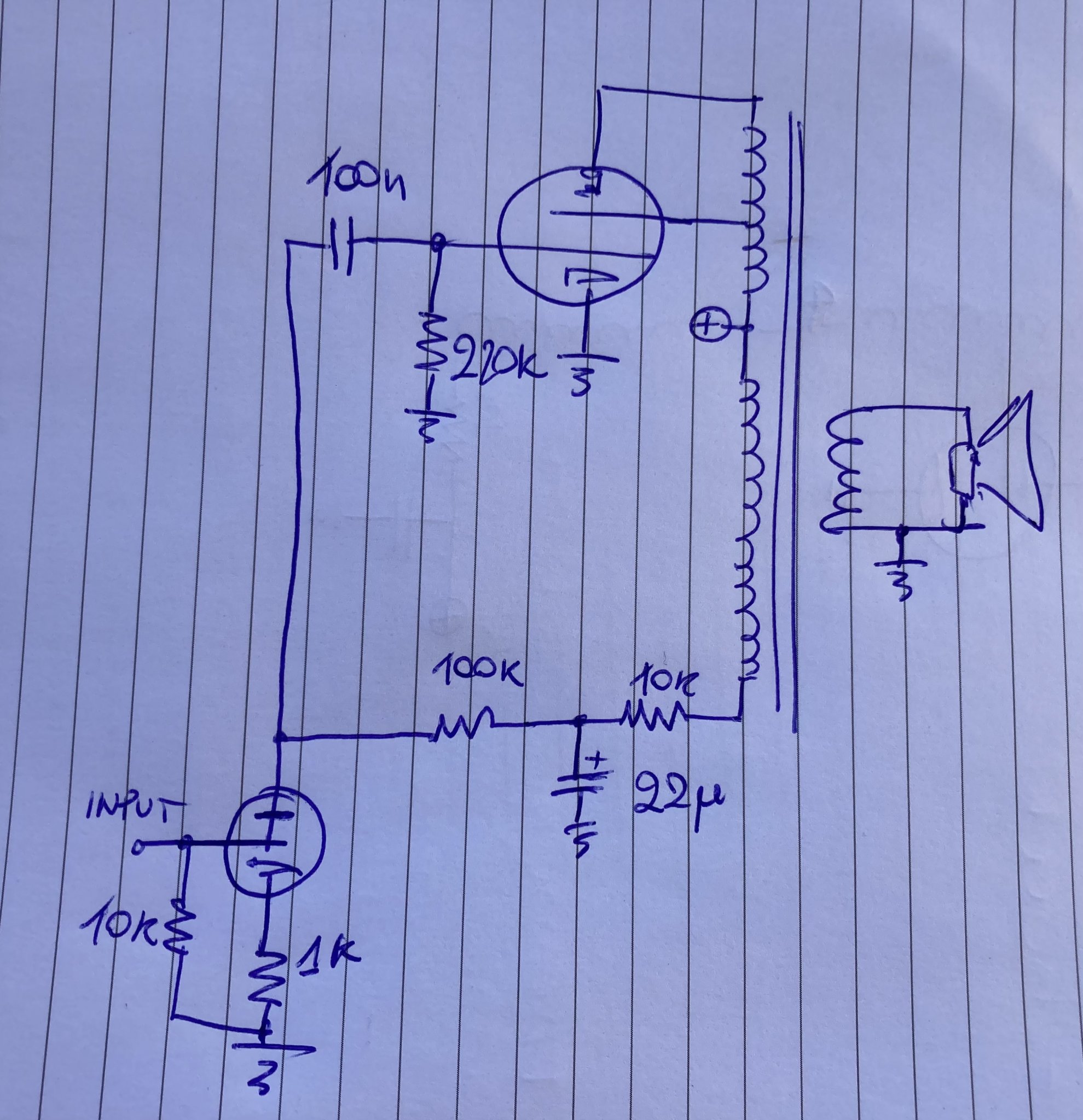

I’m in the middle of a field in countryside, so please forgive my sketch on “cheese paper” as we say in Italy. This is the basic idea, but I will search other threads you mentioned that already talked about this topic. I'm very interested.
You realize thats a 1:3 step up relative to the output tubes swing? The signal level at the 10kohm resistor will be quite large, and the 10kohm will look like 10k/9ohms to the primary. And you are placing quite a burden on the transformer winder, poor fella. Good OPT are a work of art, interleaving windings and separating windings and all the details to get the lowest leakeage inductance and interwinding capacitance etc.
I think the mentioned idea of just using a properly dimensioned core is a simpler and better solution.
The notion of 'better bass' b/c the other winding is cancelling the core sat is b/c they are using a too small ( no gap) core, and the remedy in that case was that trick. Using a proper core to begin with does the same for bass.
