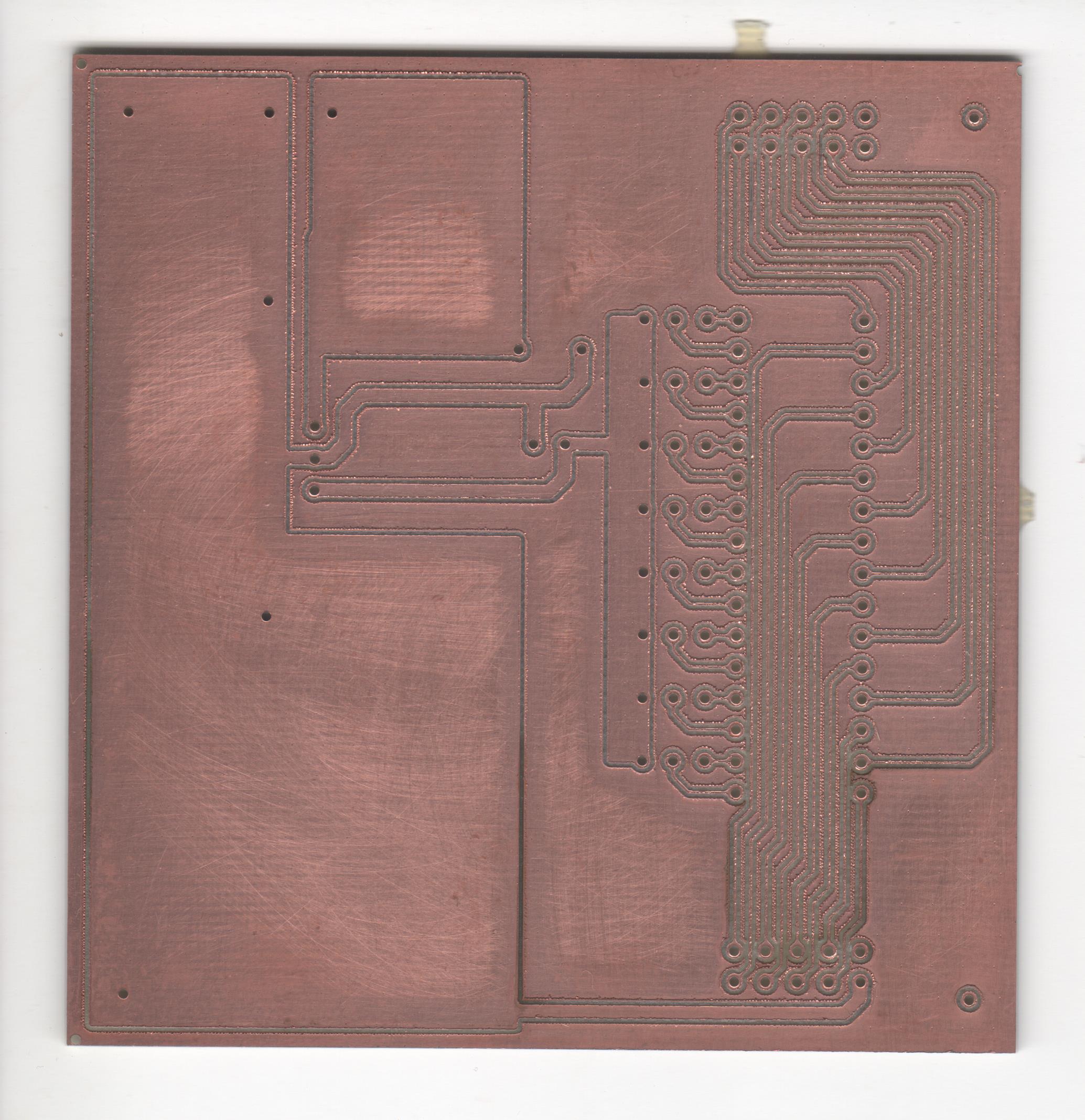

Be very wary, I purchased two of these produced using a home CNC router. On the surface it looks OK and all the tracks are insulated from each other and the holes all line up and are the correct size.
PROBLEM, the CNC process almost invariably leaves behind a lot of surplus copper.
This was just a simple DATA amplifier. On the breadboard the design works flawlessly and the correct PCB works perfectly too.
This cheaply produced PCB made a perfect HF oscillator. The capacitance of the spare copper obviously made some pretty nice capacitors which ruined the overall design.

I wouldn't necessarily call it cheaply produced (you're not complaining about shorted or broken traces), but rather, cheaply "designed." The problem appears to be not just the surplus copper, but what circuit nodes they're connected to. If "senstitive" nodes could be identified (by the person who designed the circuit or who is knowledgeable about it), the routing software could perhaps be modified to cut off the excess copper of such nodes, and add holes for jumper connections between the excess copper and nearby grounds. This would make it more like a conventional board with ground fill. Can you ask the maker if there's a way to specify this? If they respond that "it's electrically correct" then you know not to use them again...
This problem is similar to a pcb layout person or autorouting software making a board form a switching regulator schematic with no knowledge of where the high-speed/high current loops are and what to do with them, or really any knowledge of electronics.
The CNC routing process does not leave excess copper if the tools are in good condition (solid carbide only!) abd the machine is properly set up. We use LPKF CNC routers for prototype production at work all the time, and the output is pretty satisfactory, only sometimes requiring cleanup.
The excess copper here is the large copper areas, nothing to do with the cutter condition. Theses are unavoidable in the way these cutters do a generic PCB, they work by cutting a path of the clearance round any signals, so simplifying the CNC router path and minimising the time taken to produce a PCB. To clear polygon areas involve much more post processing, then machining time increases as does tool wear. So either tie the copper to the GND/0V signal for digital boards or get etched PCBs where these areas of copper are not desired.

This is an LPKF board and they can be made so that this doesn't happen. Having spent many hours with the system I would not let something like this go out. Tool sharpness and tool height alone can fix this problem. Looks like someone needs to spend more time with the machine. You can also specify that any area of copper be removed so I would create a wider "isolation" around tracks. This is a function of the LPKF processing software and again someone doesn't know how to set that up or doesn't care.
It may have been a crude CNC setup rather than an LPKF or similar. We use a pair of LPKF machines at my work place for prototyping. Even they have problems if the tools are not adjusted properly and replaced periodically. Having said that, I wouldn't send out a board like that, either.
There are just far too many ground planes linked by tracks that are also far too thin.
It would need link holes to another ground plane on the component side with a reduction in the values of any decoupling capacitors if it is running at high frequency.
