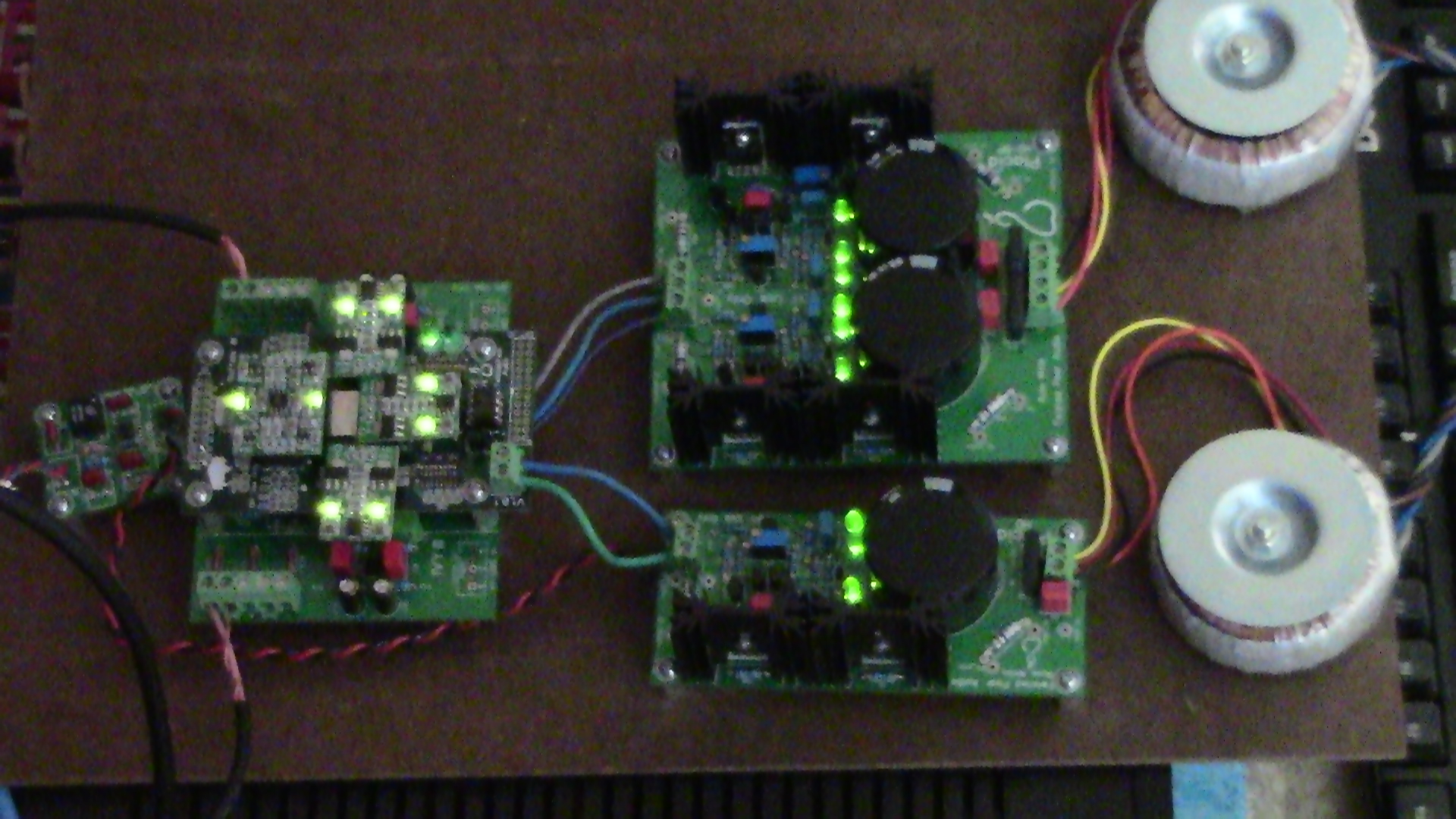

It sounds like things may not have been wired correctly from the transformer? Some pics of the power supply wiring could help narrow things down. 🙂
You should throw it out and either buy latest version or use another design dual supply.

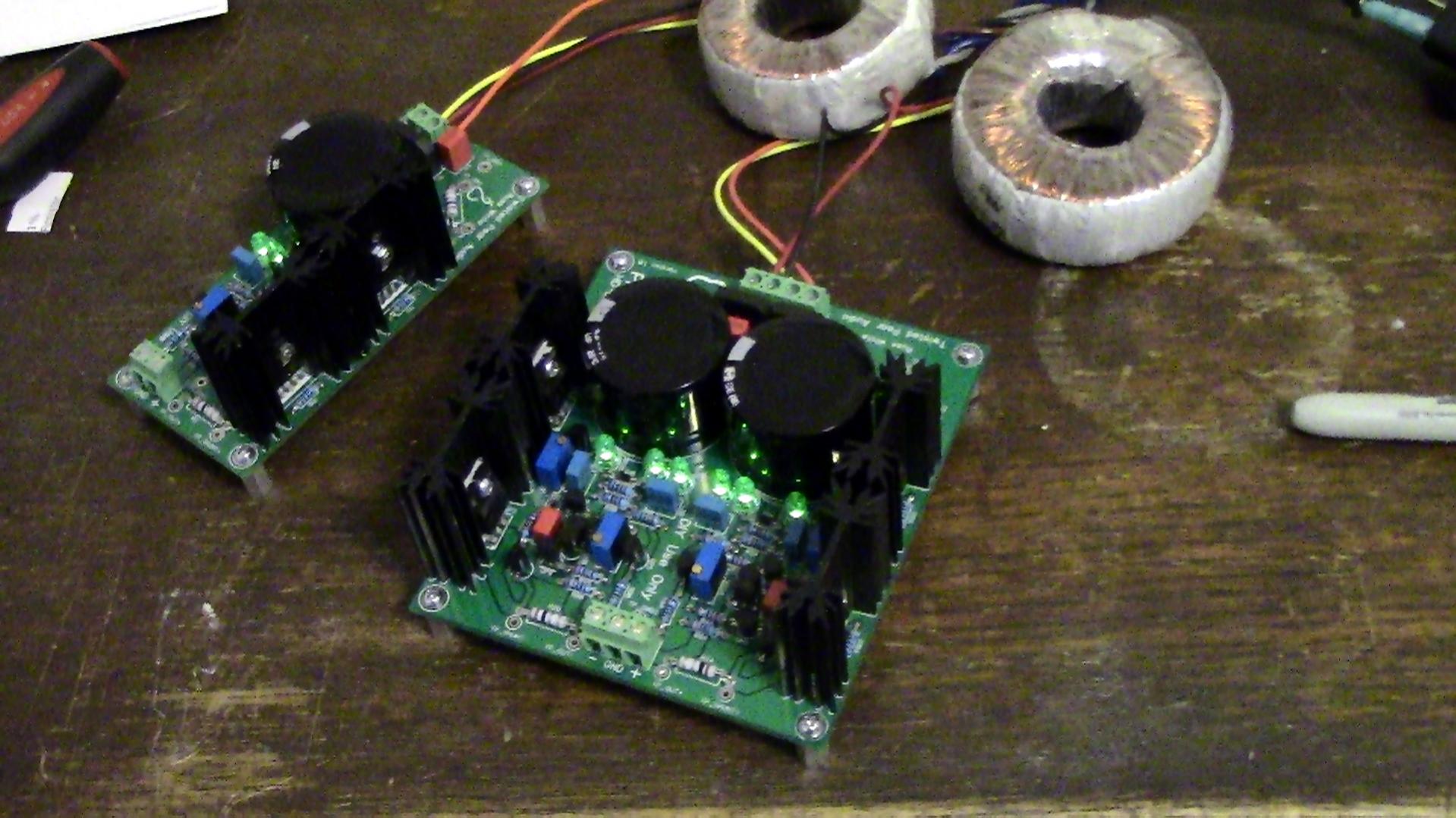

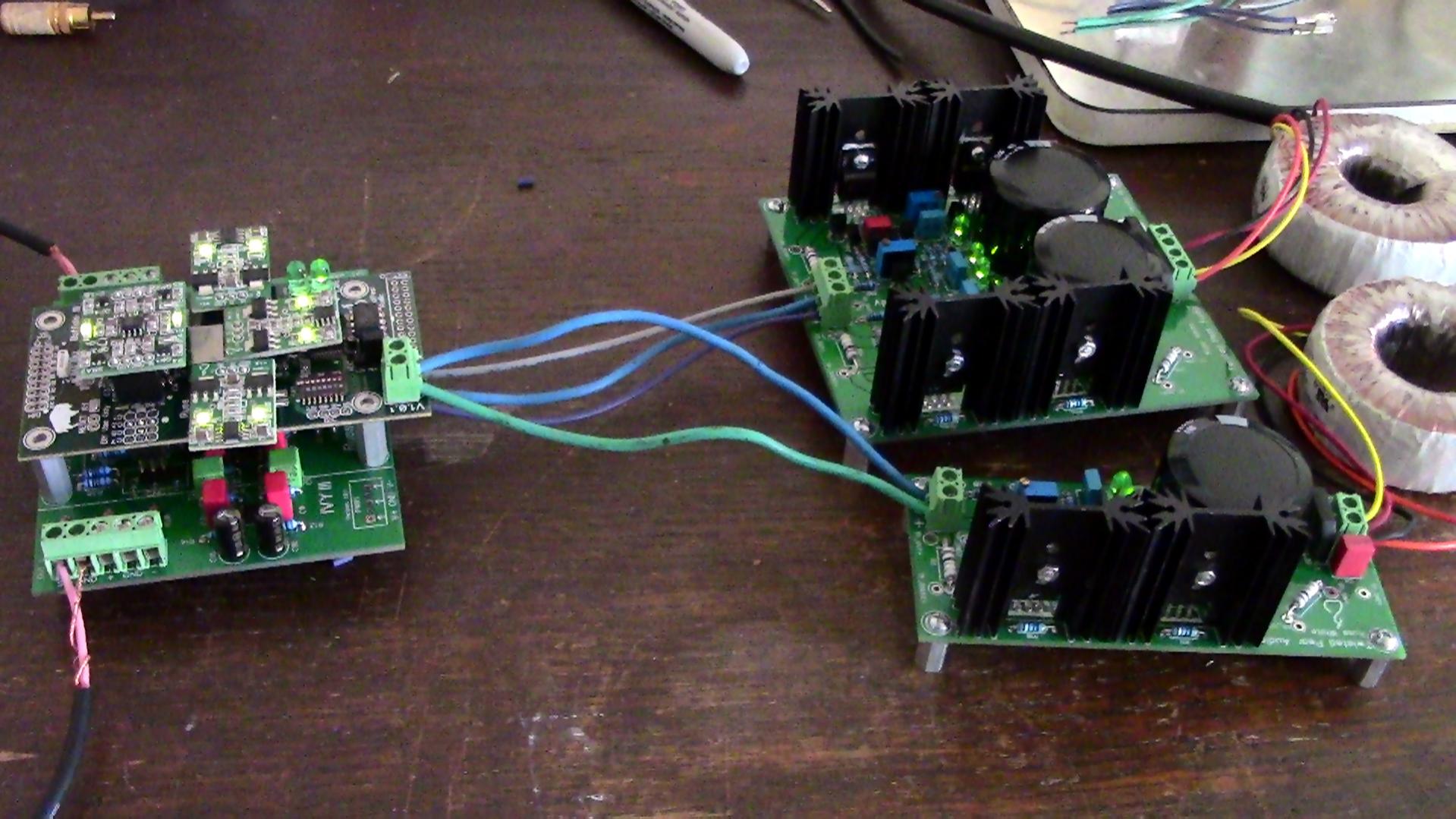

😱 Was I penny wise, dollar dumb buying this kit used? 😱 As I mentioned, I bought this kit on Swap meet, here on diyAudio in 2014. All the kit parts were still sealed, although I was missing the terminal blocks on the SPDIF kit, and was missing half the risers on the three tridents. I Ended up soldering the tridents directly to the lower riser. I hope that is okay. 😱 I also do not know if I have the new firmware chip or not on the DAC board. The person I bought this from had it for awhile also. The number on the chip is: TTINY85 20PU I am guessing this was one of the first Buffalo III boards.
I think you did fine. 🙂 Lets just try to sort out the power supply. What transformers do you have and how did you wire them?

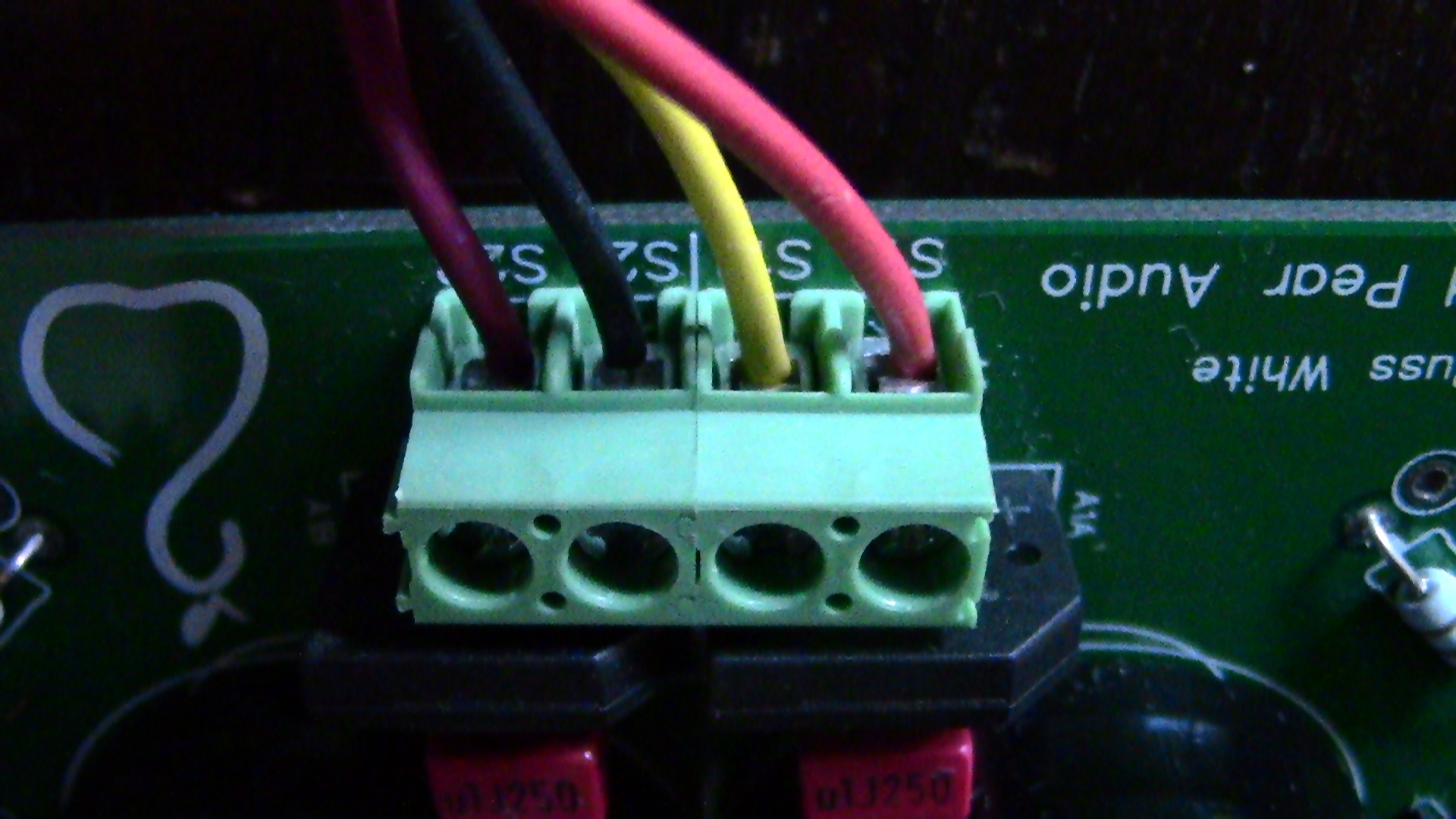

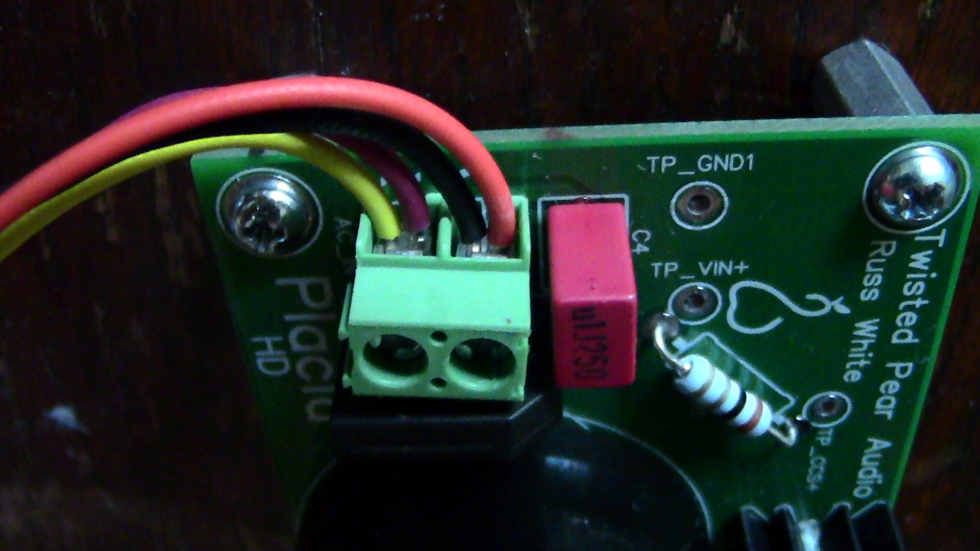

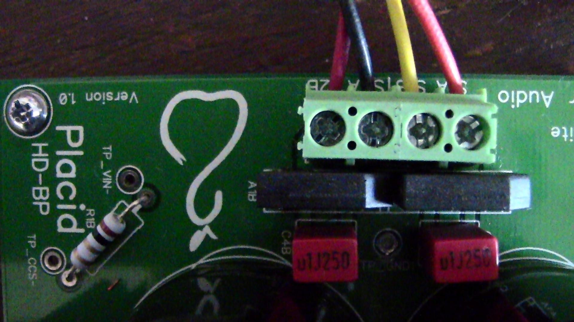

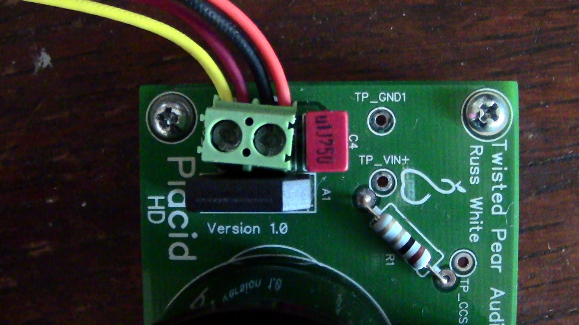

Here are the wiring photos from the transformers. As I understood from the manual, is red and yellow are the "live" wires from the secondaries and the brown and gray are the "live" wires on the primary. The Placid BP had S1A, S1B, S2A, and S2B. Yellow is in S1B and Red is in S2B, these could indeed to be backwards. Should Yellow be in S1A and Red is S2A?

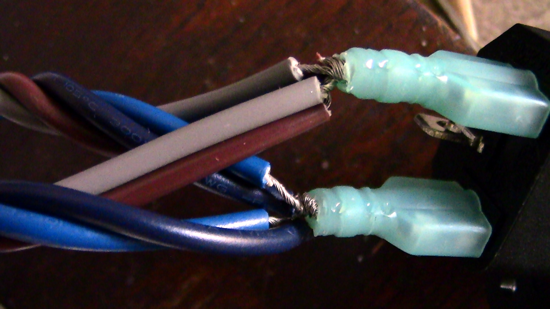

I cut a little much off on one of the blue primary wires, as You can see in the photo. I did not want to cut the wires down to size until I have the chassis. So this will be redone for the final build.

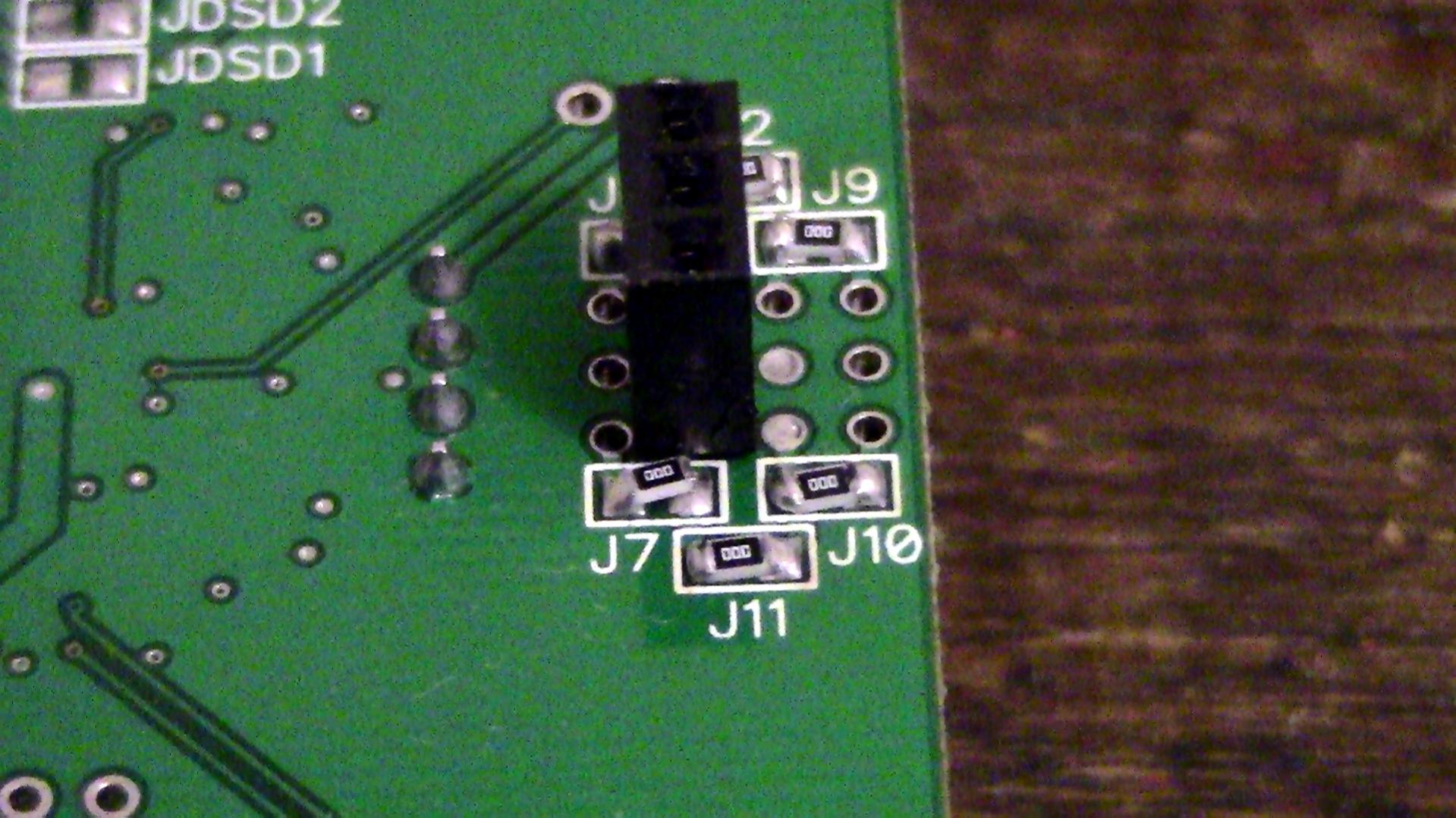

Here was the cold solder joint I found on J7 on the DAC board. Would this cause the rectifier to hiss and smoke?
As I mentioned in post #9, I had both supplies running fine for three hours, at full power, bypassing the bulb in the bulb tester. This was without a load, however. The issues came up when I hooked up the loads. Everything seemed okay thru the bulb tester, but I should have checked those outputs on IVY also. It was when I bypassed the bulb when things went haywire...
There is a difference between the "Placid" and the "Placid - HD" two different circuits. 🙂
New placid HD's use a completely new circuit with a precision voltage reference - you would need new parts.
The placid HDs (version 1) you have right now should serve you well as long as they have not been damaged 🙂
The transformer wiring looks good - but the solder joint on one leg of R1 looks suspect.
I would double check them all - then test the supplies independently. If you have a suitable dummy load (something like a 1-2W 50R resistor will work well for 5V 100ma) even better!
No.
The only thing I can think of that would have cause that would be a short right after the rectifier.

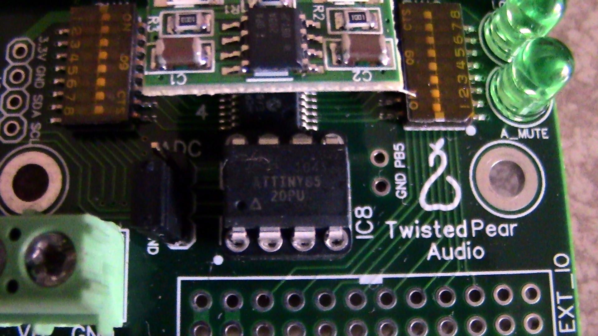

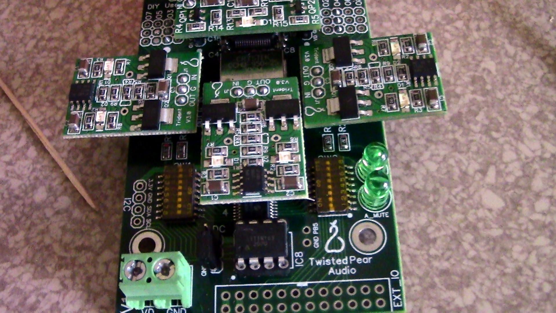

As it turns out, my problem was flux residue. Russ gave me the clue:
Quite a bit had wicked to the top side of all the boards into some impossible to reach areas. A though cleaning with brushes and tooth picks was not good enough. Flux is a lot like grease, it spreads and smears, causing Mega ohm connections between terminals where there should not be. Part of this was caused by my technique, and part by the flux I used. I will go into that at a later date in greater detail when I have more time. How I solved the problem was, first brushing generous amounts of alcohol on the boards, getting in every nook and cranny. That was immediately followed by a raise with hot water. I used the spritzer on my kitchen sink at 1.6 gallons per minute to "power wash" the boards. 😱 That was followed by a second cleaning with CJ Flux Remover, and a second "power wash" raising. Then I used a hair dryer to dry the boards as much as I could. Finally, the boards where placed in a preheated 170 degree oven. The turned the oven off, as soon as I inserted the boards, and left then to dry overnight. The next day, I probed the boards and did not find any more Mega Ohm readings.
I at listening to music now, so this must have worked! 🙂
