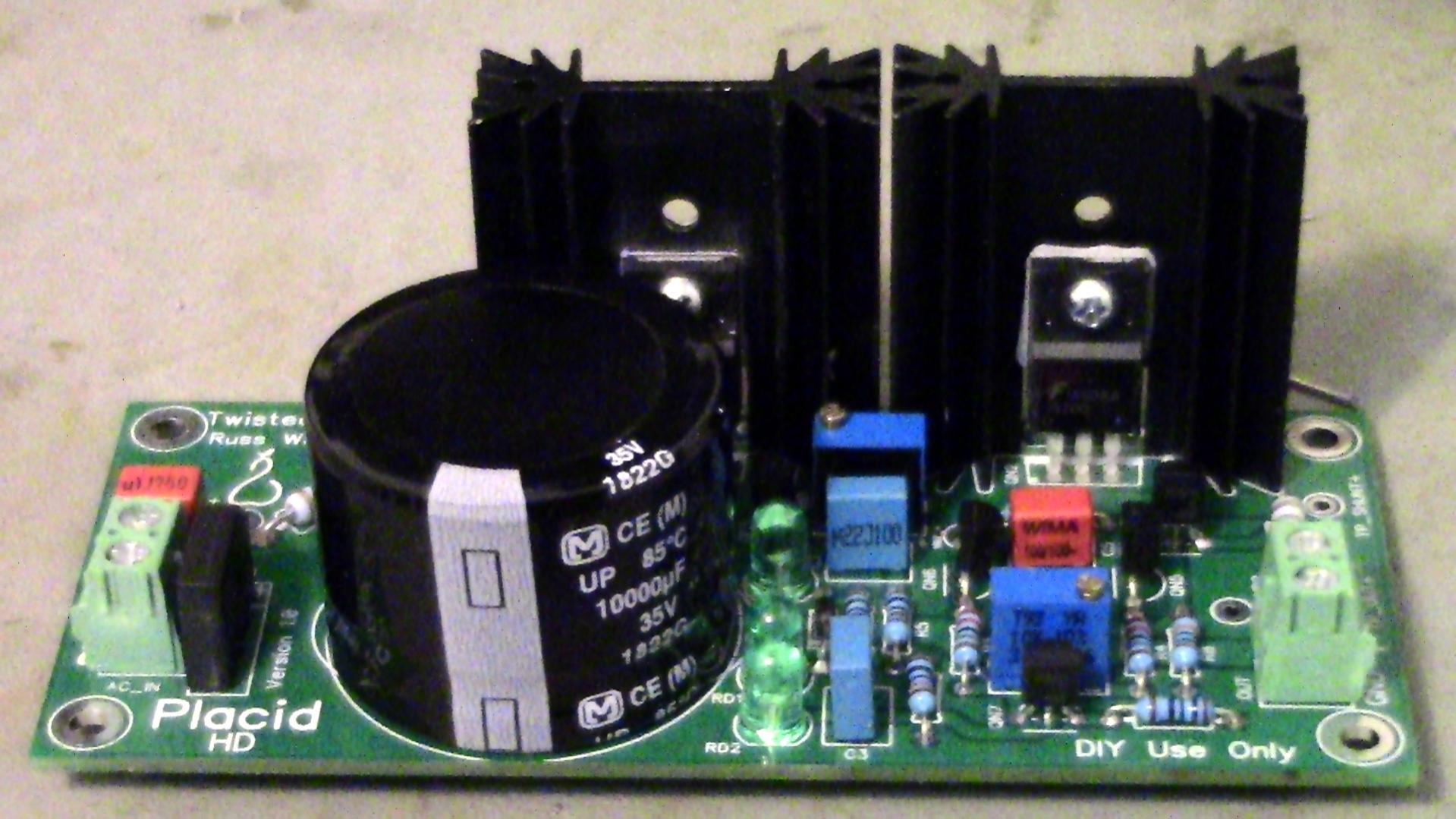

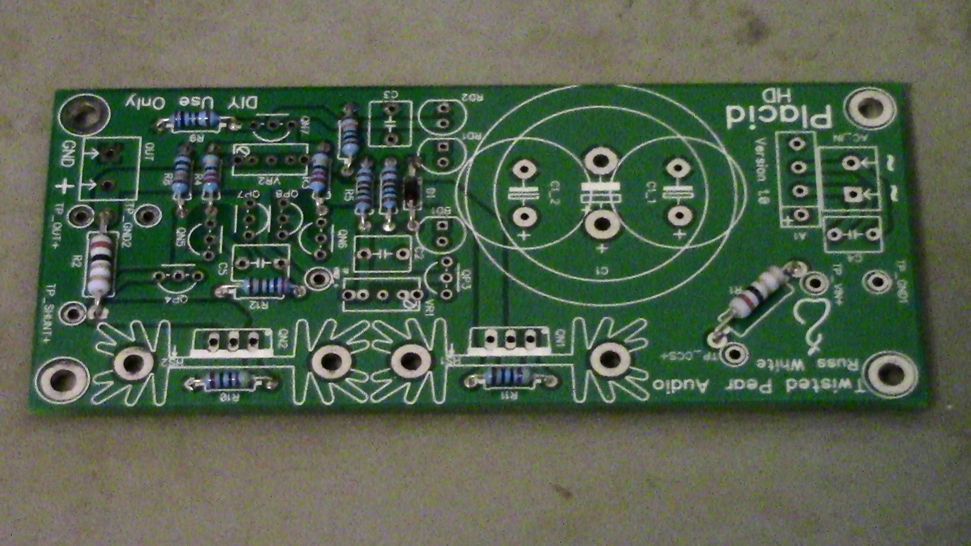

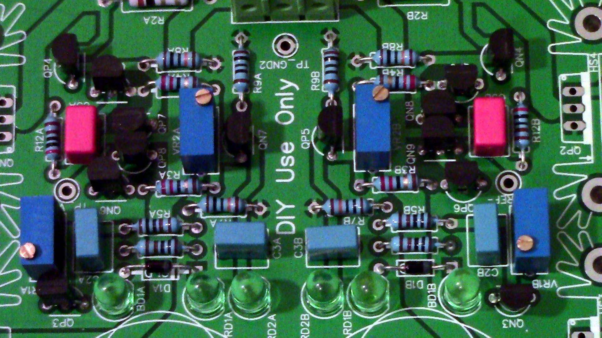

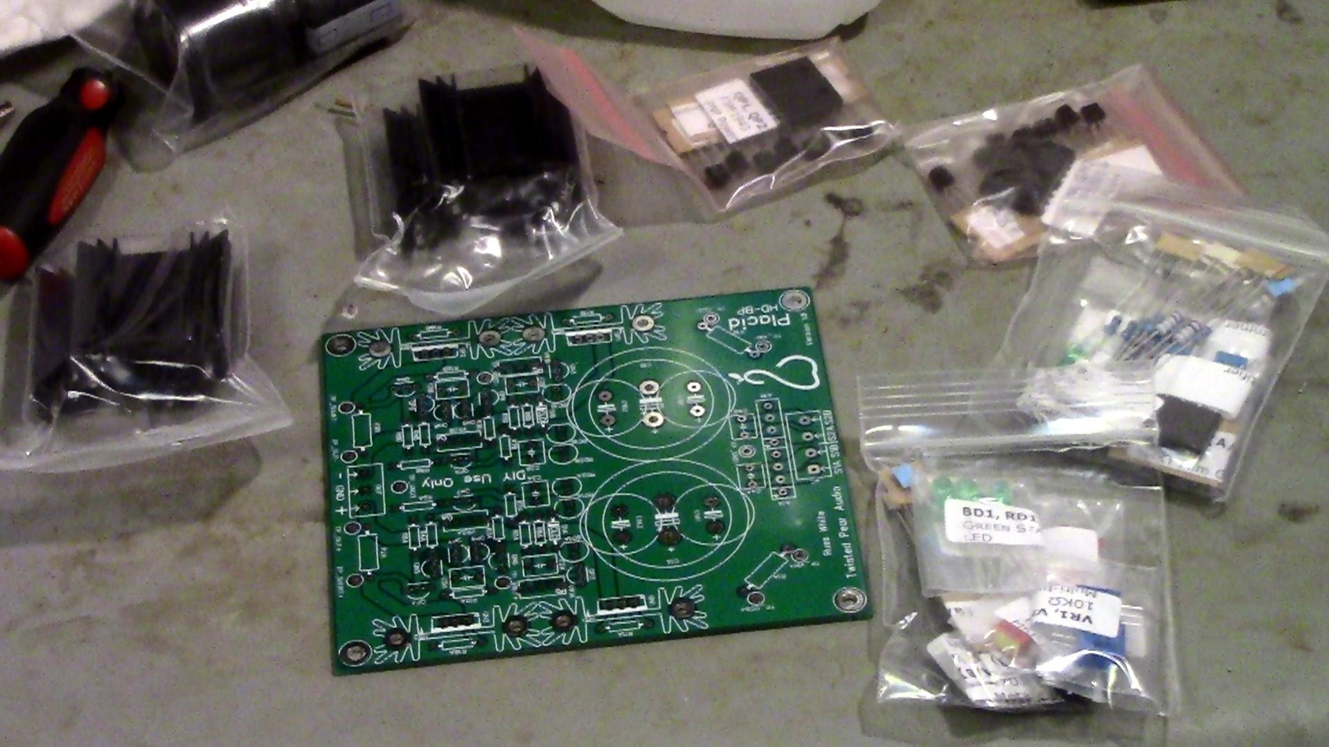

Starting the Placid HD v 1.0
You know how these things go, You order this stuff, then You get it, get overwhelmed, and wonder what You get yourself into. 😱
I decided to start simple, with the Placid HD:
I have the original version, so it is a little different then the new boards.
What I can say, Russ, Brain and Leon, have done a great job designing, packing and presenting these kits. All the parts are clearly labeled and the boards clearly marked. It reminds me of paint by numbers. Find the part, find the part number on the board and solder it in, and away we go.

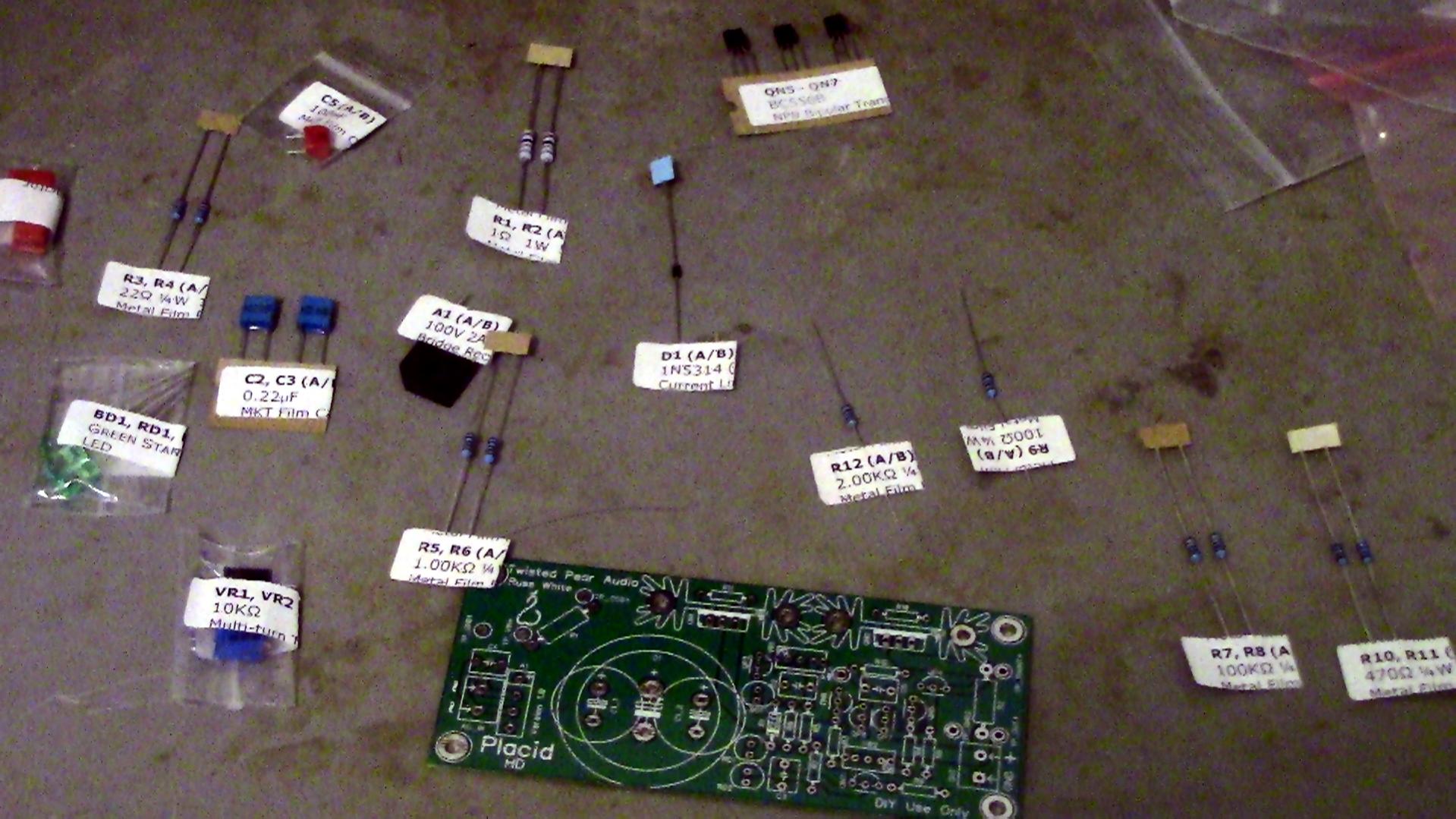

As suggested in the manual, I started with the resistors, as they are the lowest components. It took awhile to get the technique right to bend the wires on the resistors so they were "perfectly" centered in their "rectangles" on the board. Once bent, I would thread the resistors thru, dab on some flux (using a toothpick), solder, then clip the excess wires off.

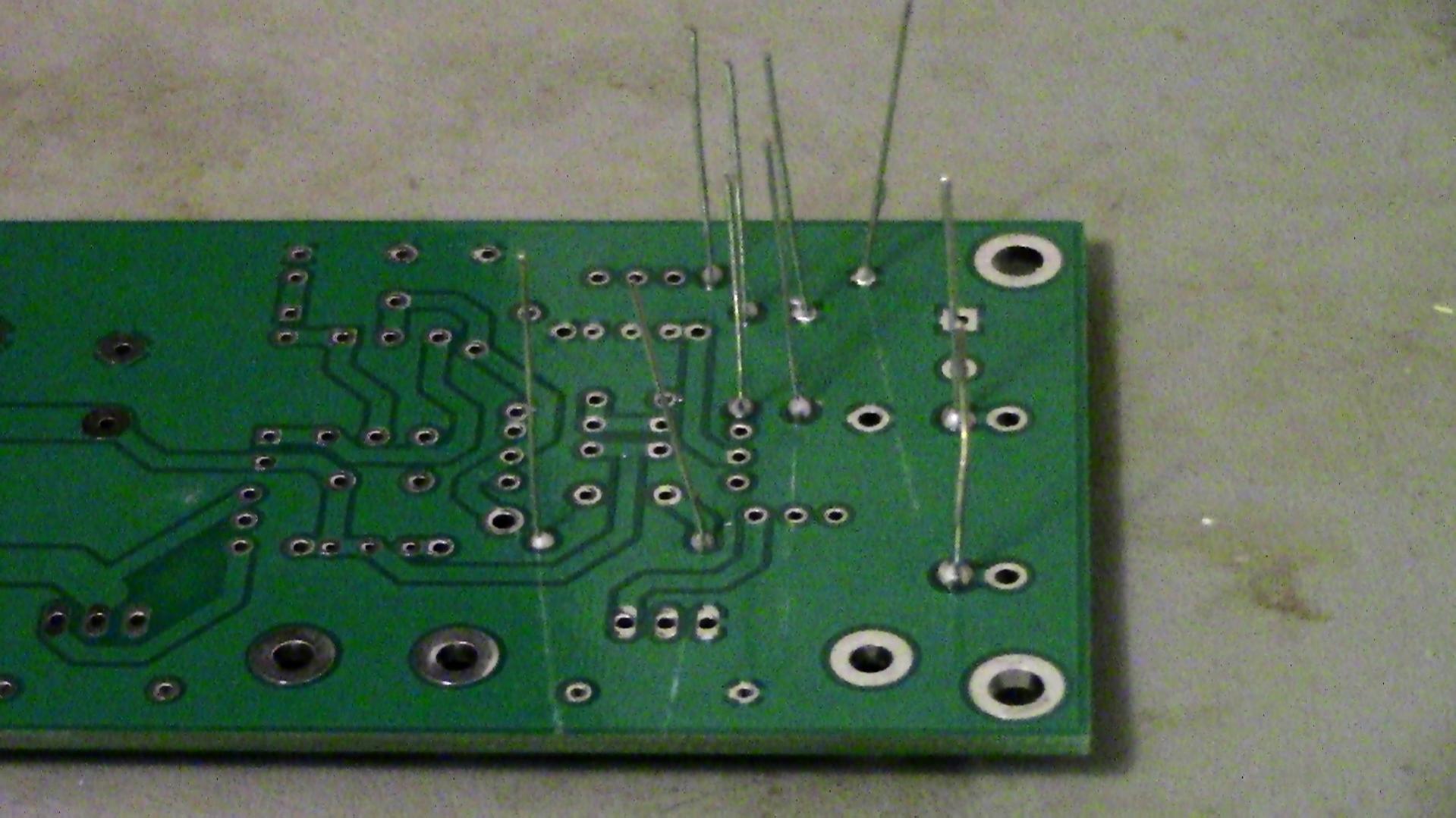

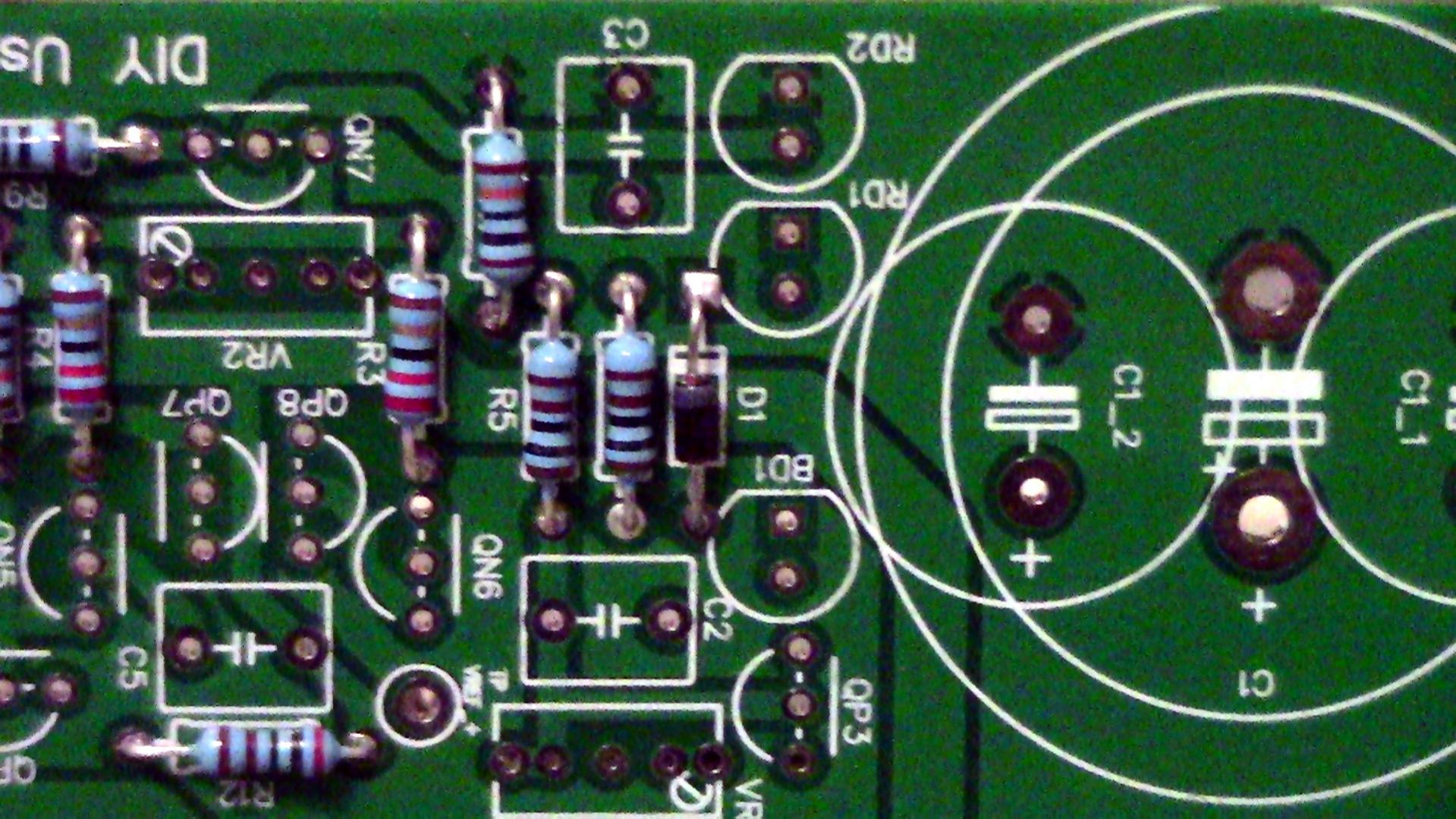

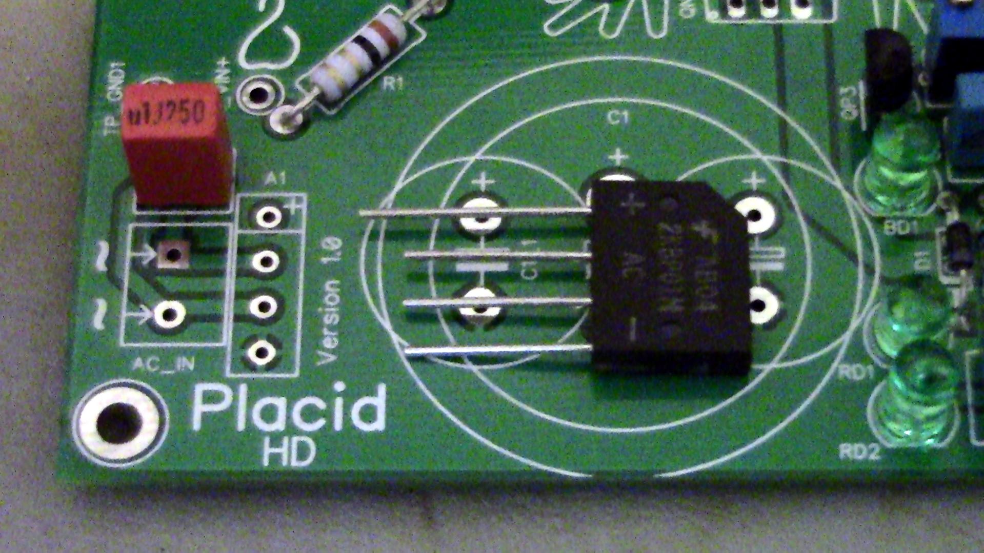

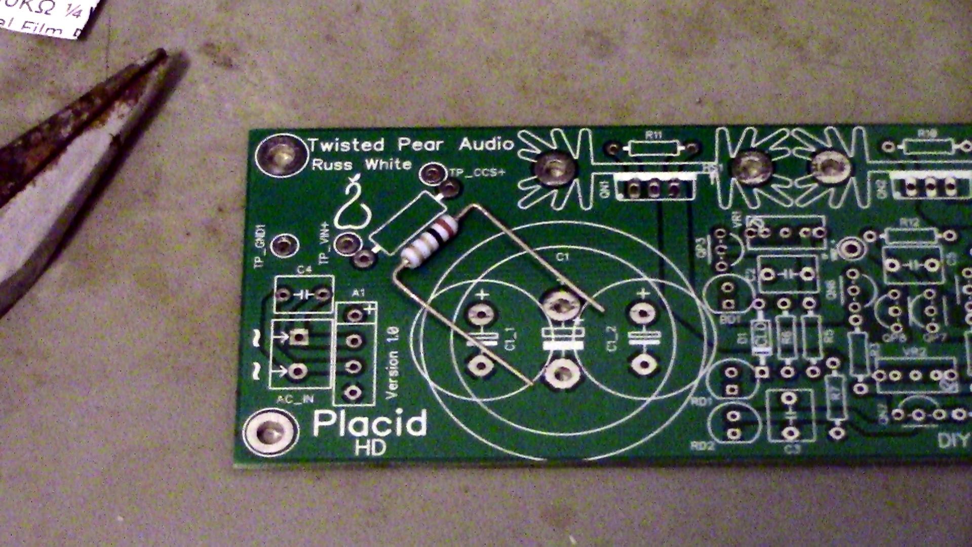

polarity or not

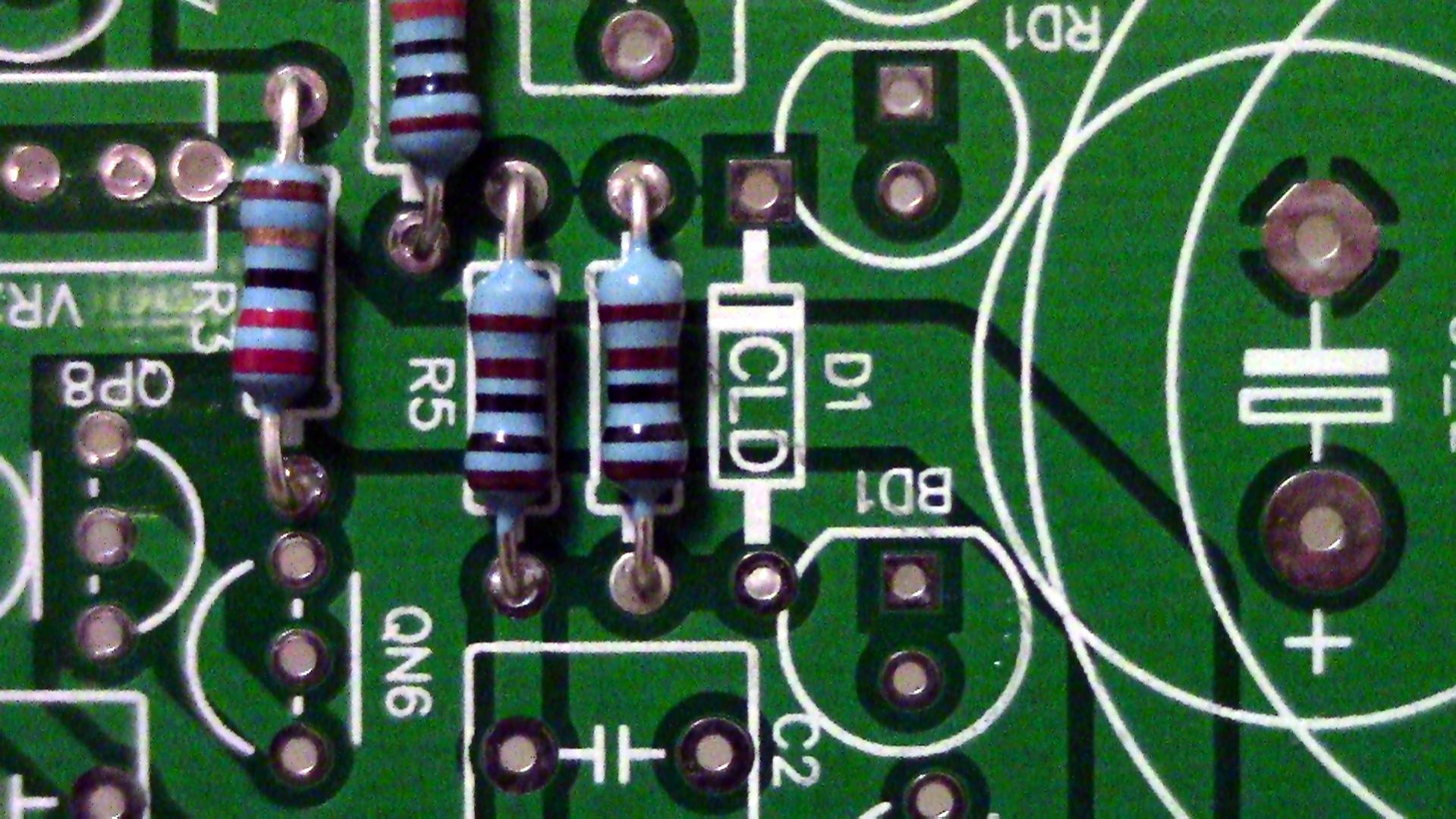

Resistors are pretty straight forward, they can not be installed backwards. But I knew diodes had to go in one way. Thankfully, the board is marked with a band in the diode rectangle, echoing the band on the diode itself. It is so simple, one could miss it. I am farsighted, so I need to be even more observant, even with reading glasses.
directions...

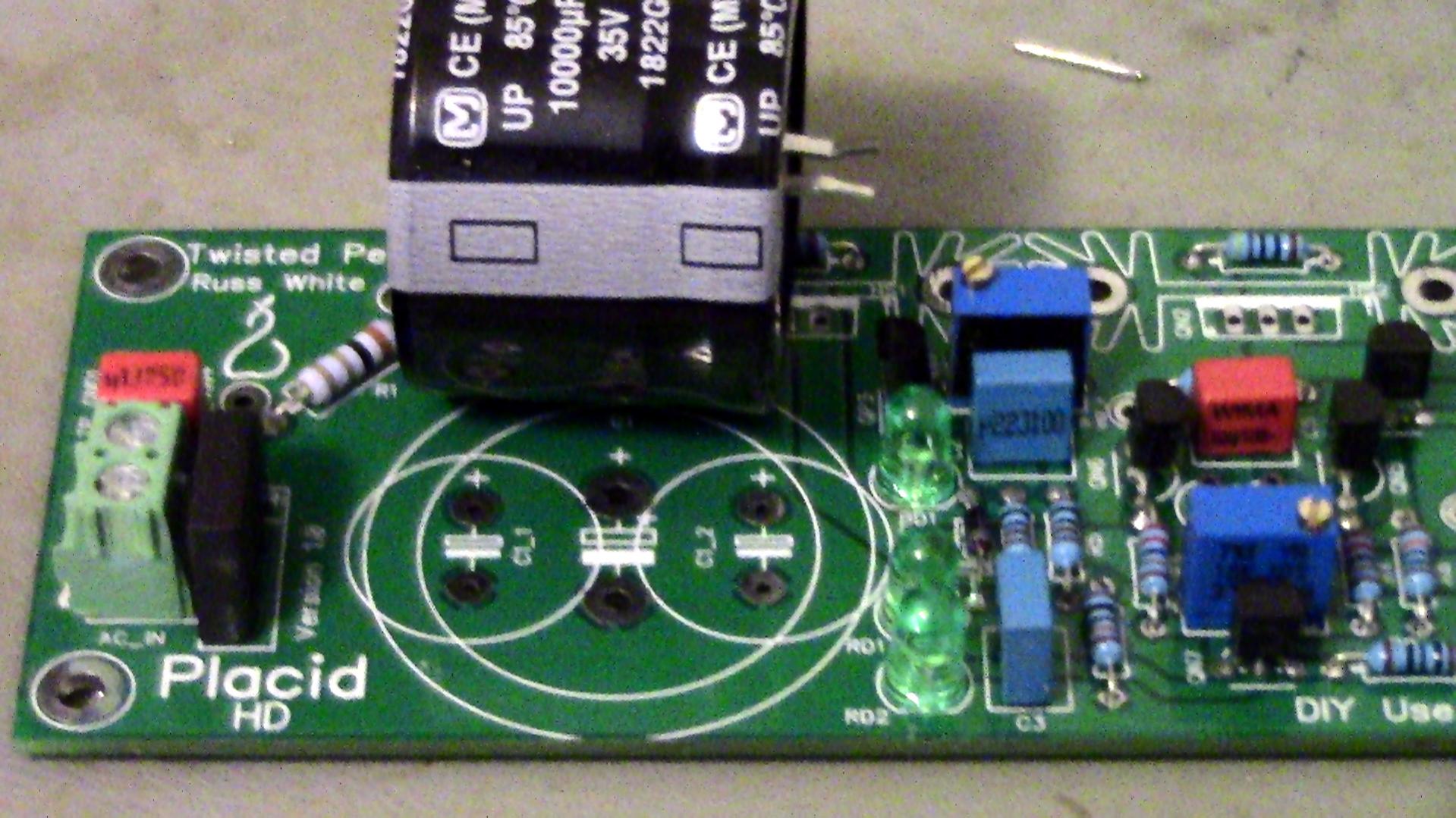

Next up were the small caps. These were not polarized.
But the variable resisters (VR) needed to go in a certain way to work right for adjustments. Once again, a close look at the board revealed the answer: There is a tiny circle symbol echoing the screw location in the VR rectangles.

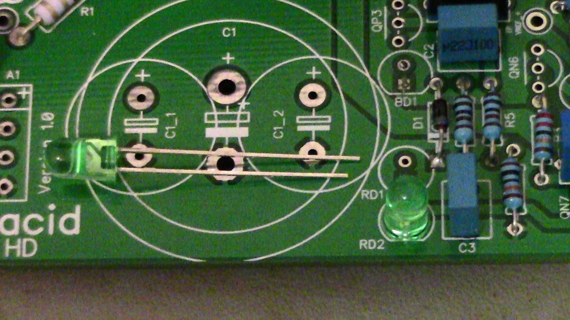

The LEDs took me awhile to figure out. I soldered the first one backwards in fact. The board has a circle with a flat bottom to dictate polarity, the flat part being the negative side. I could not see the flat part in the LED itself, it was pretty subtle. A google search reminded me, that the long wire is the positive side, so I want with that. Thankfully, I do not think the newer boards have the LEDs. 😉
After that, he Rectifier seemed pretty easy, with the big "plus" sign stamped on the side...
Almost done apart from thermo coupling...

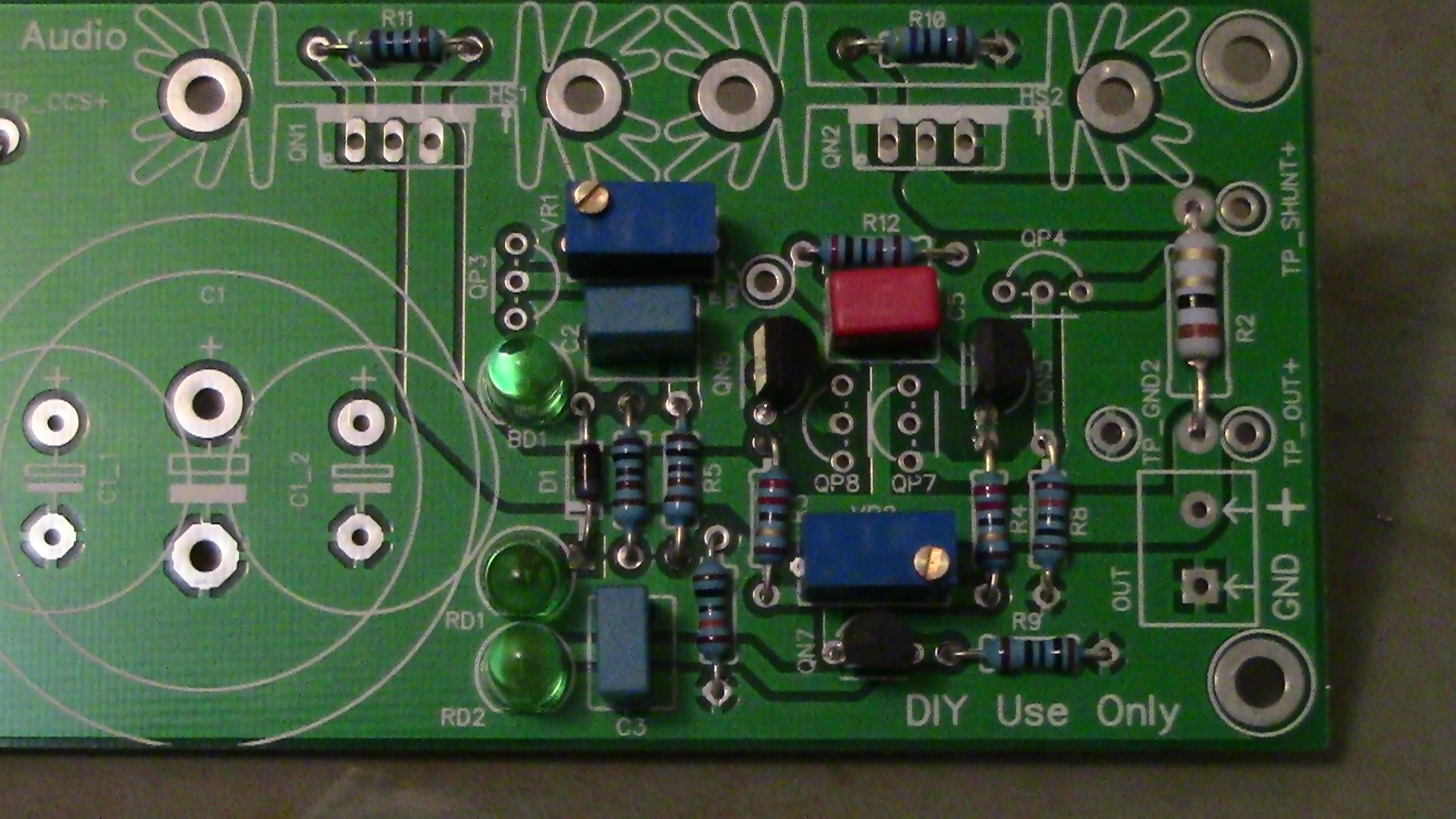

Likewise, the big cap was clearly marked, with the minus symbol banded down one side...

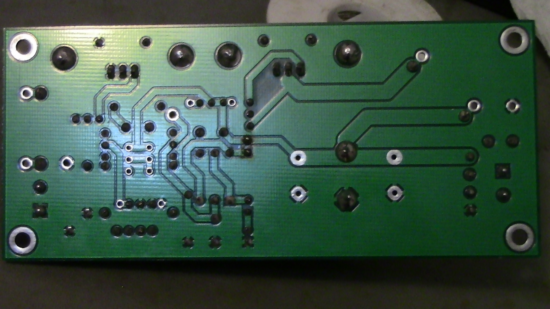

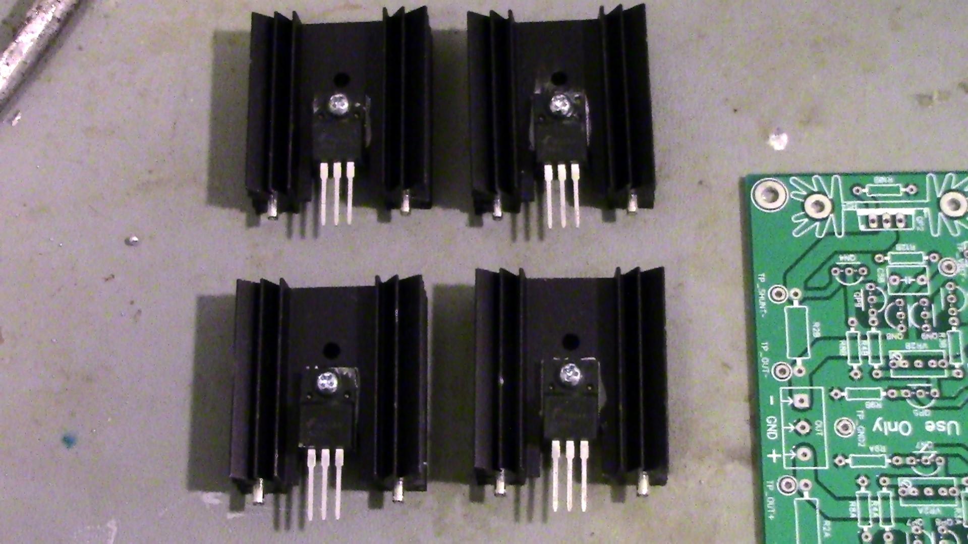

After that, I thermo pasted the regulators to their heatsinks. I felt right at home soldering the heatsinks to the board, that is more of the size of solder bead I am used to doing, when assembling glass work. 😉
I used alcohol to clean the flux off the board. I used both a cotton rag and a tooth brush to get it all. It is pretty tricky, due to the "catchy" nature of the solder beads and clipped wires. Patience is a virtue here.

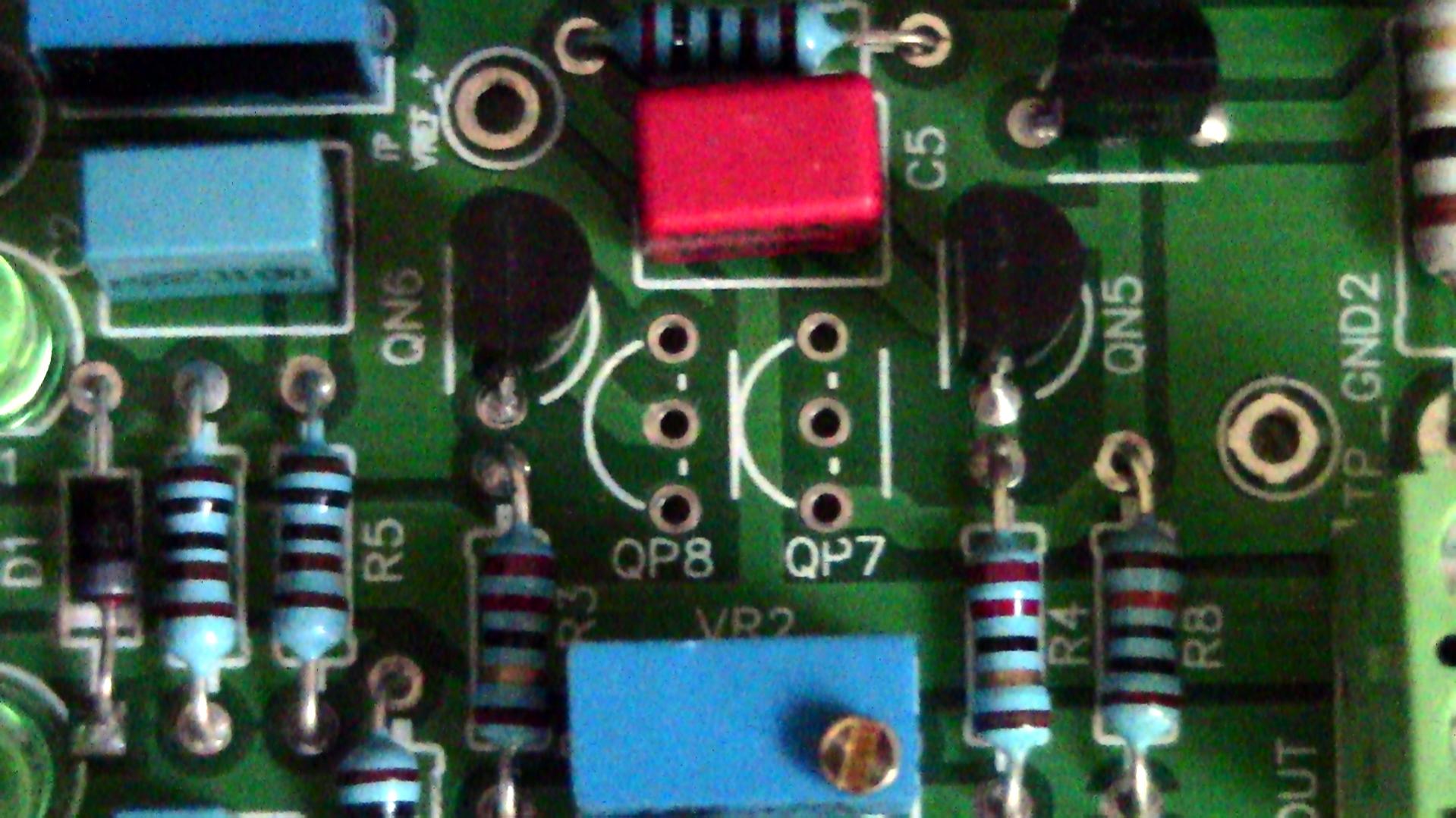

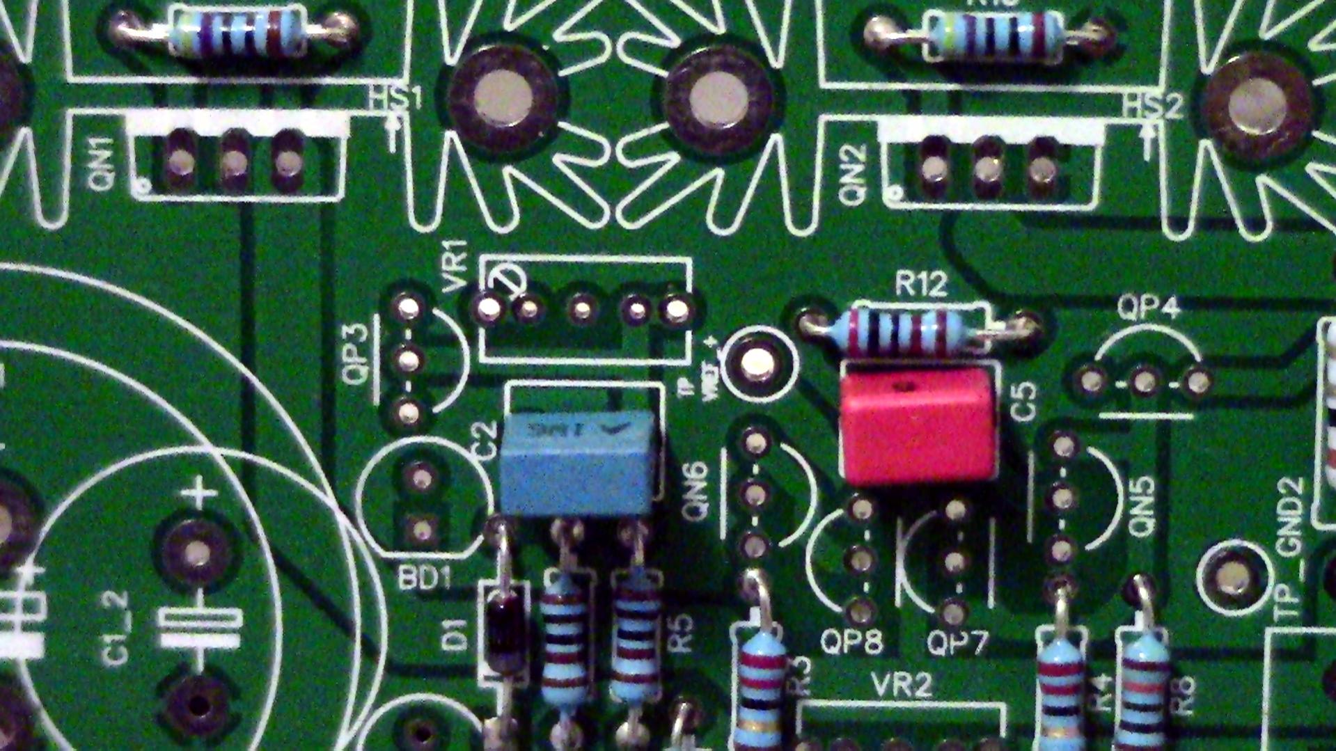

The Placid is almost done, it is missing one thing:
Based on the instructions, transistors QP 7 and QP 8 need to be "thermo coupled". There was a picture of that, but I could not tell what was really going on.
Are the transistors just physically touching? Or are they thermo pasted together and wrapped around with tape? Or are they bonded together (not needing thermo paste)?
Once I know what proper "thermo coupling" is, I will install the transistor pair in, and have the DAC Placid done. 🙂
Allen
QP7 and QP8 are both facing "same way", flat side of the transistor points the same way. This way it's not quite possible to do a good thermo coupling.
Don't bother, it will do just fine without thermo coupling. Just bring the two transistors close to each other - or do as I did, mount them nicely and forget about the thermo aspect.
A closer look...
Thanks avr300, I am glad You caught that too! 😱
I took a closer look this morning, with a fresh eye, and realized they are indeed the same way.
Getting version manuals mixed up. 😱
Glad I did not have these thermo coupled ahead of time. 😉

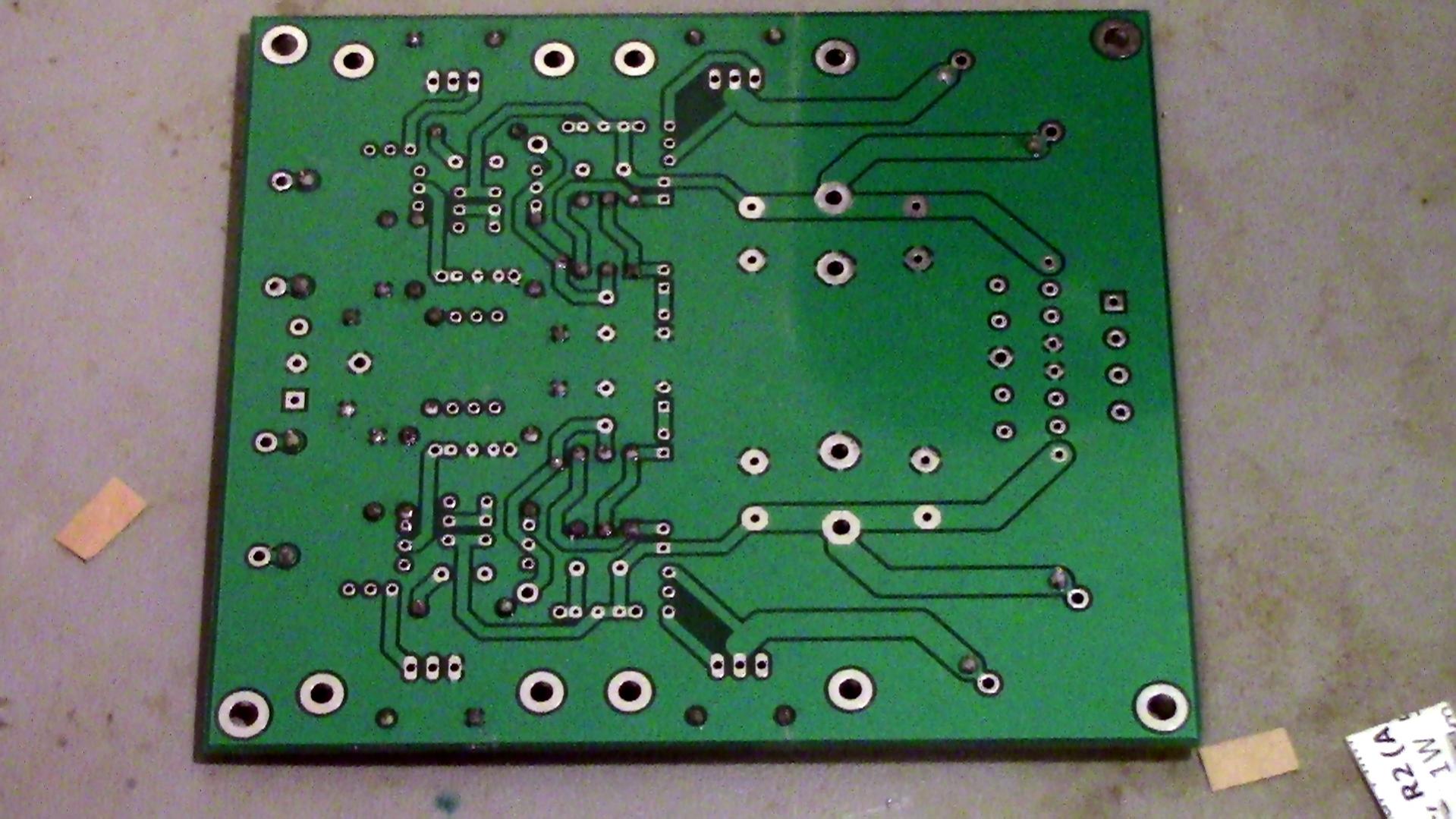

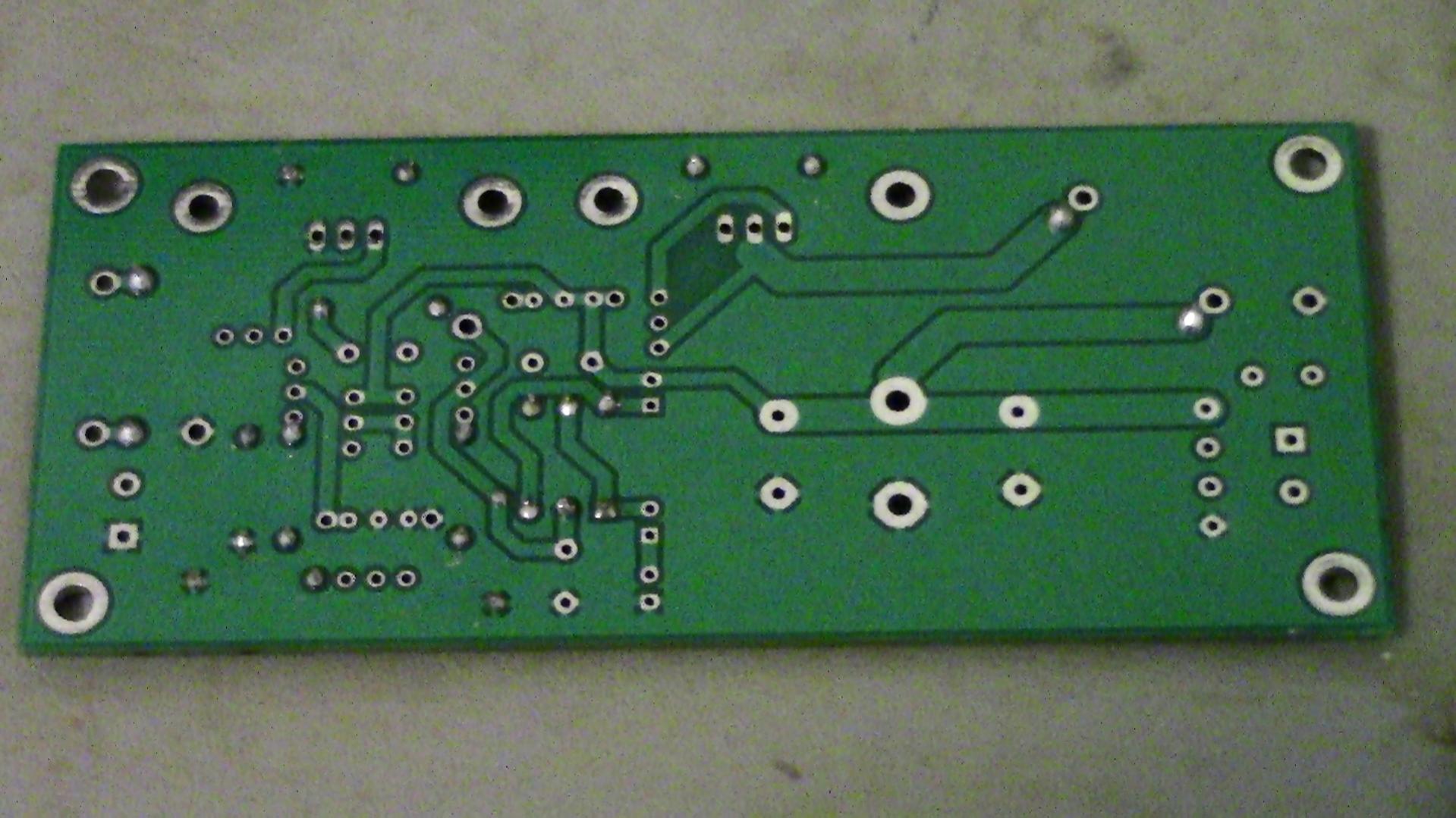

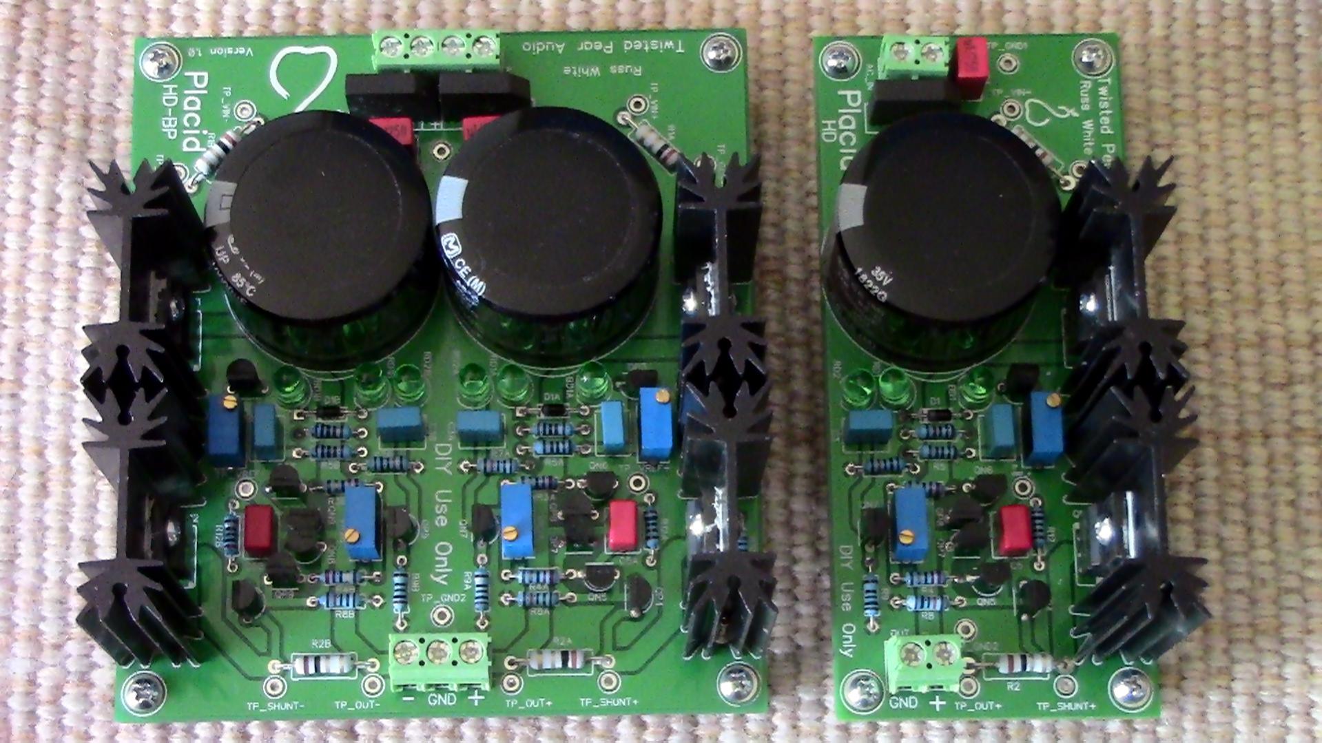

Lets rewind a bit...
Yikes, no responses, a little unsettling...
I do feel a little better today, but still not sure where I am at with this DAC build.
I will at least post the photos of the build so far, at the very least, maybe someone will learn what NOT to do...

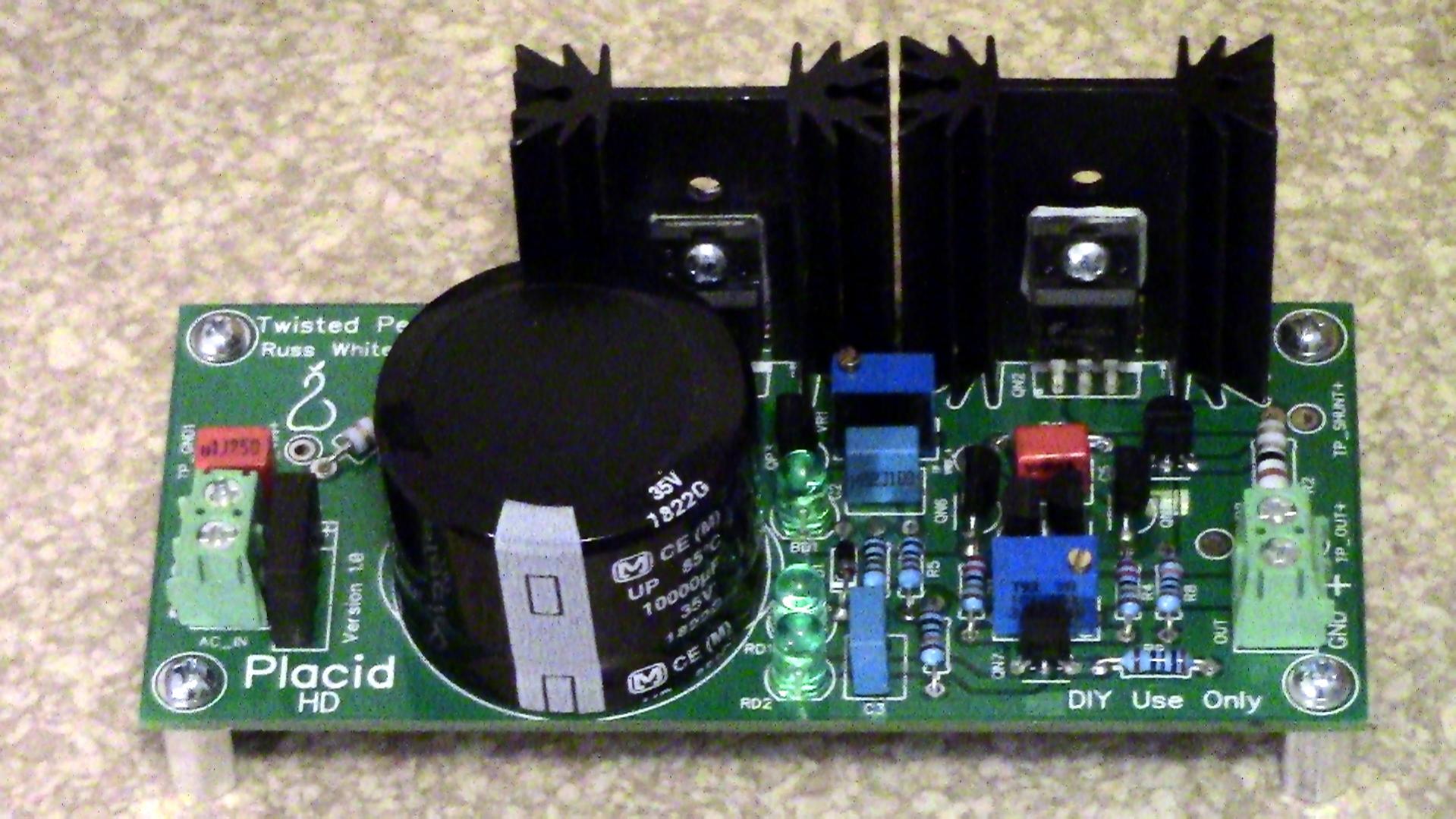

Here is the completed Placid HD.

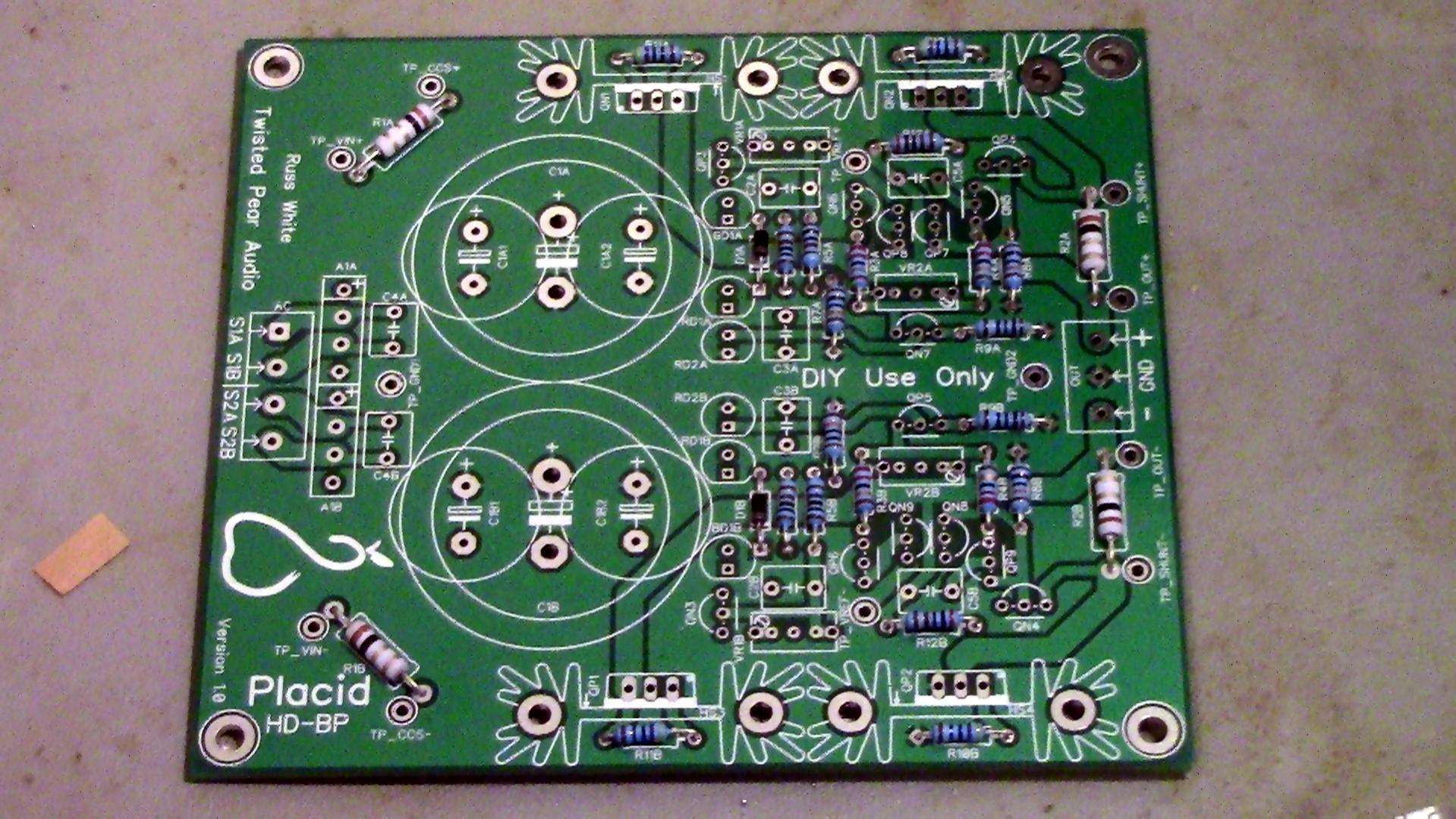

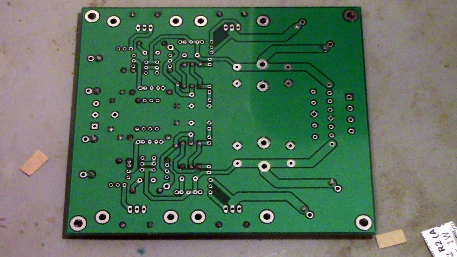

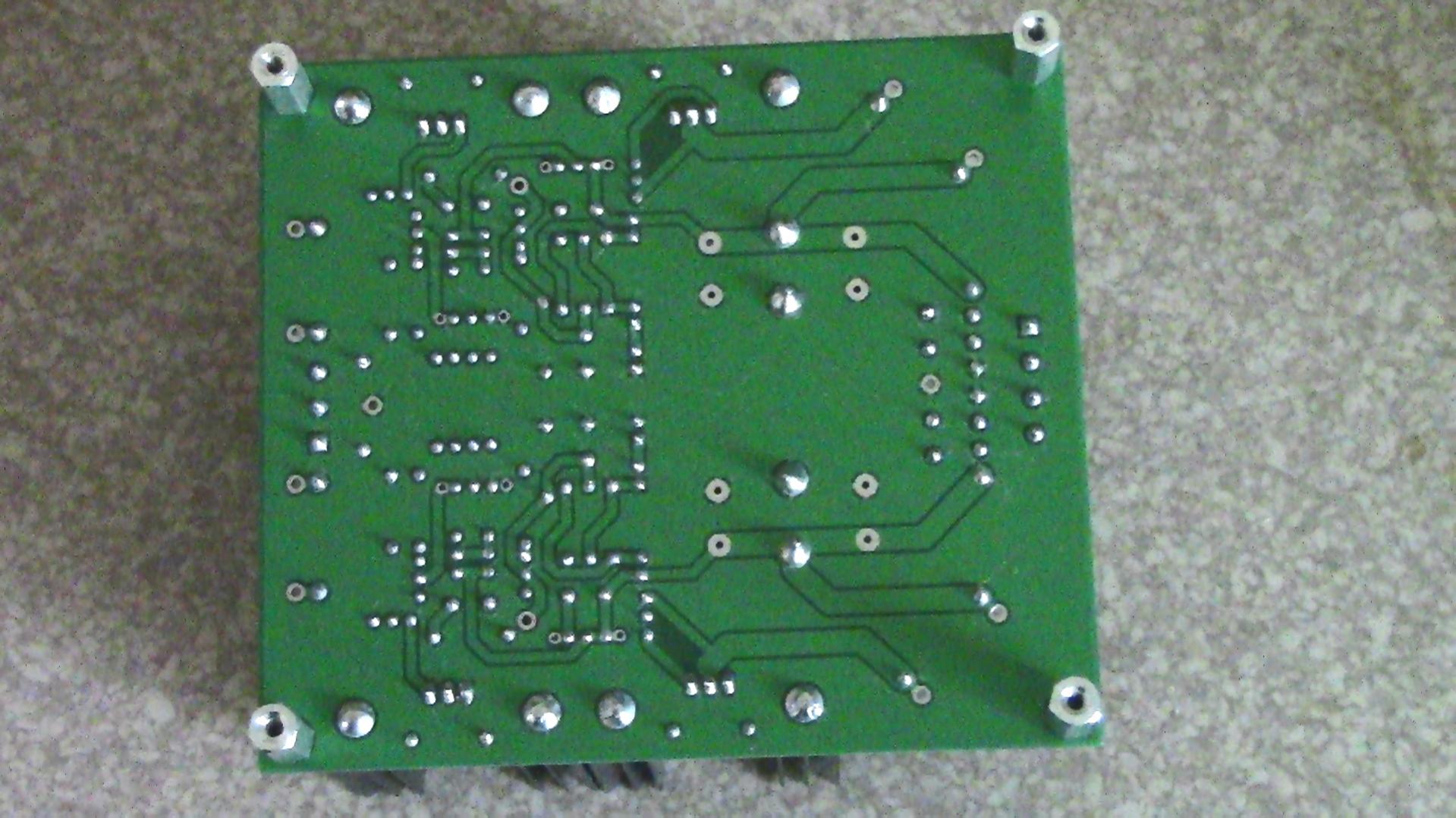

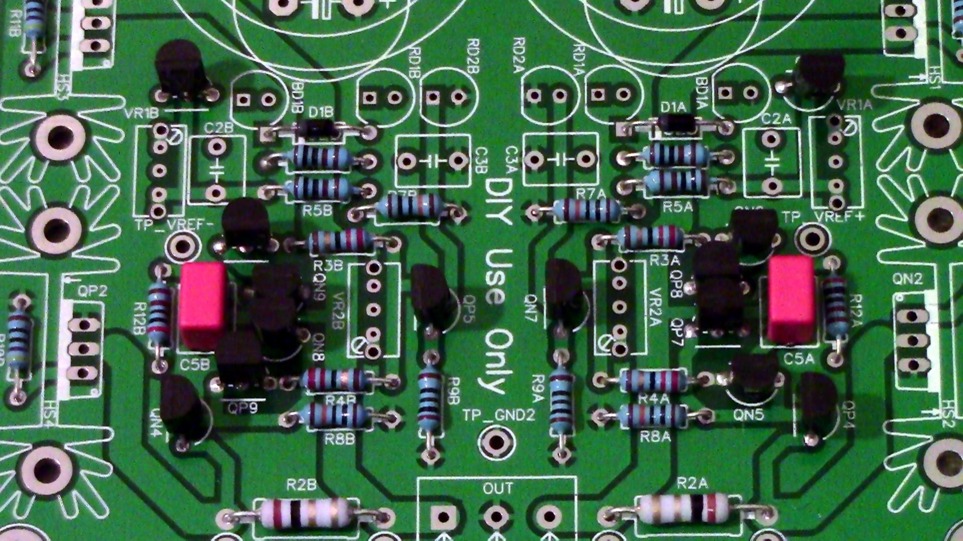

The Placid HD BP build: mounting transistors
The Placid BP is very similar to the regular Placid, just twice as many parts. Also, it is important to note, because the BP is a Bi-polar supply, it has a different transistor configuration on each side. As I mount the heatsinked transistors to their heatsinks first, before I solder, I relabeled the transistors to be sure I could identify them later...
Placid BP resistors.
Like with the Placid, I started with the resistors. This was pretty straight forward, just more of them. After I cut all the leads off, I cleaned the board...
Lower to higher

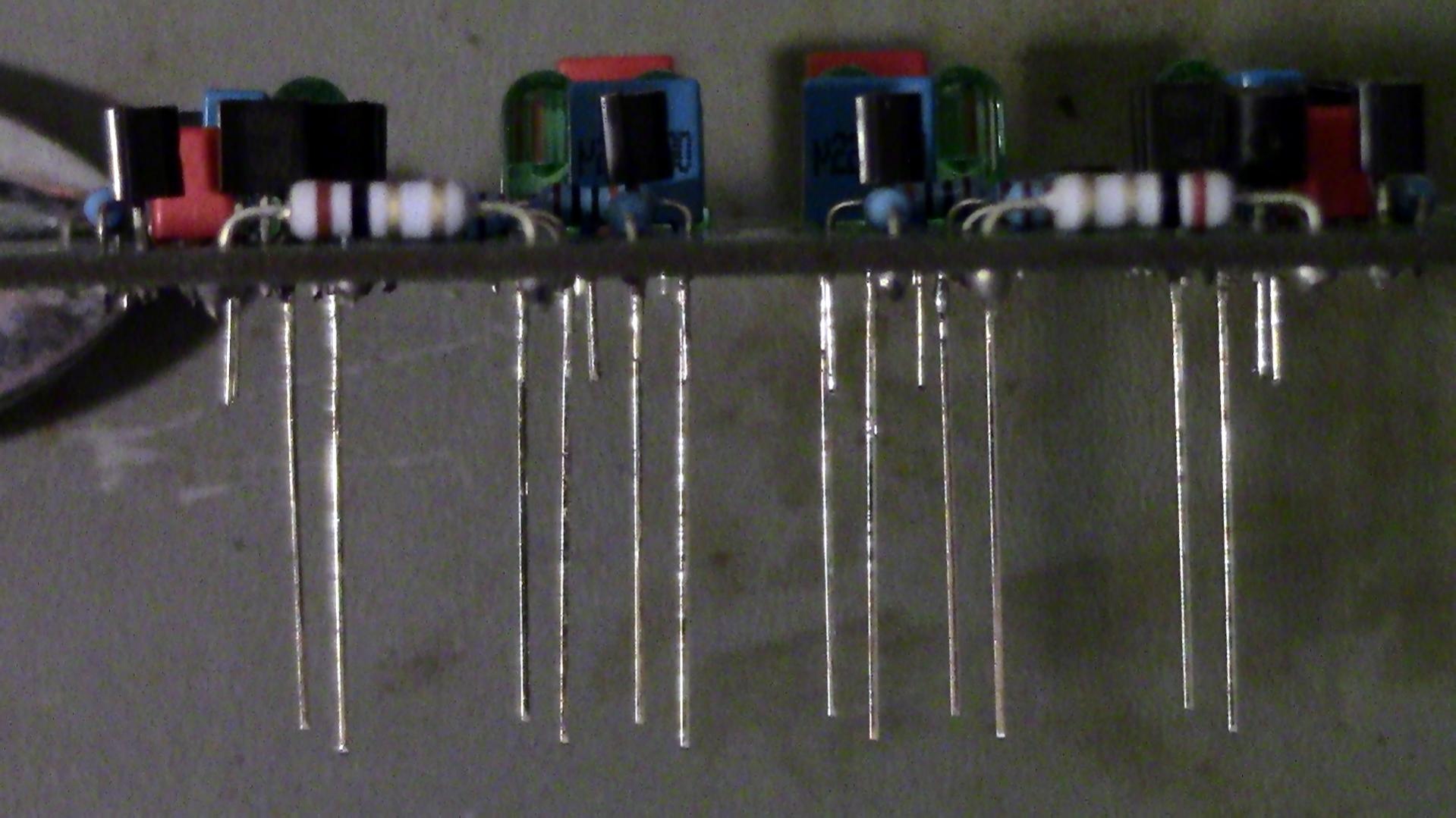

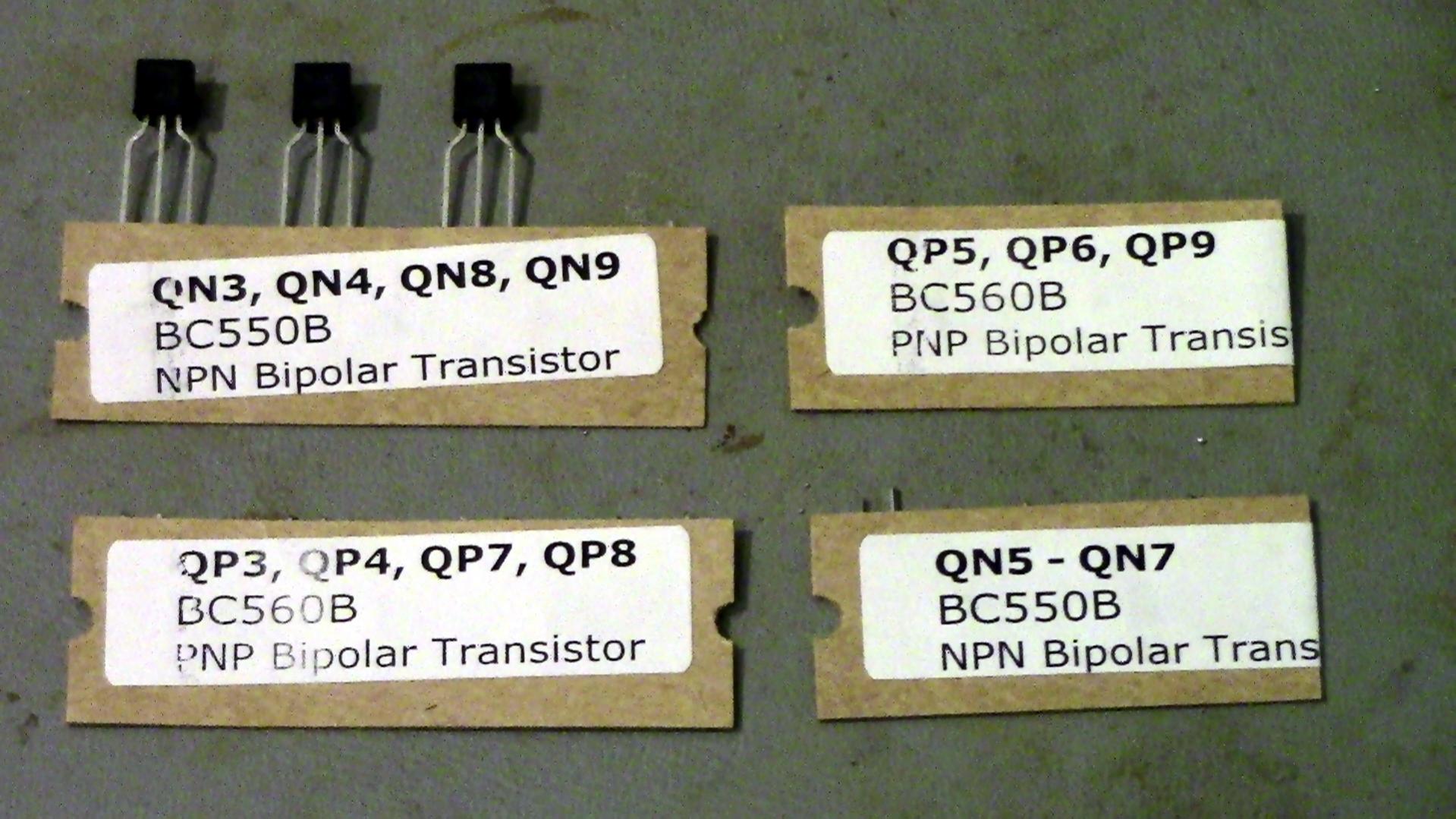

After building the regular Placid, I did realize that installing the small transistors after some of the taller Caps and Variable resistors, made it a little tricky to install the transistors. So this time around, I installed the short Caps first, followed by the small transistors, then the LEDs, followed by the higher Caps and Variable resistors. This had a much better flow to it, inregards to holding the parts in place while soldering.
I took special note of the Transistor types: NPN or PNP, as they are opposite on each side.
Also, all the LEDs are installed the same direction across the board.
With a symmetrical looking design like this, I had to be really mindful of when each side is a "mirror" of the other or an exact copy. The board and parts are very well labeled, just have to watch the mind tricks. 🙂

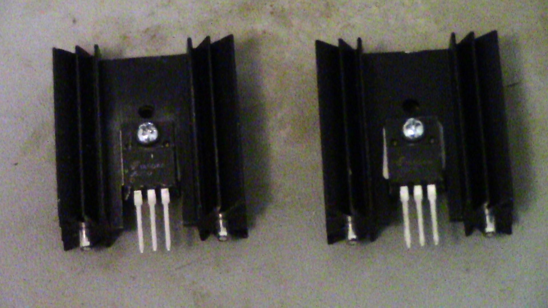

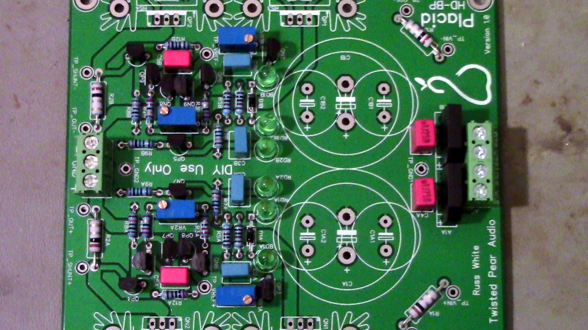

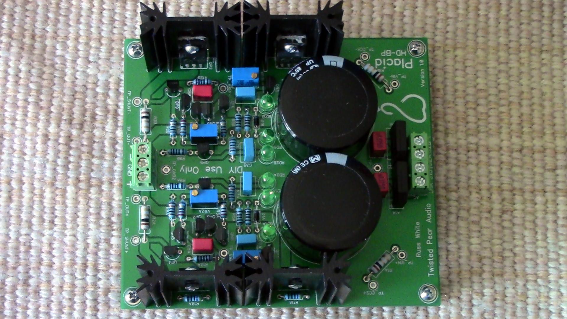

Now the big stuff
This was my favorite part, soldering the big stuff. Got the terminal blocks, big Caps, and heatsinked transistors in place and soldered.
Again, I had to make sure I had the right transistors in the right place, one side is NPN and the other PNP. The Caps, on the other hand were installed facing the same way. The polarities are clearly marked on the board.
I cleaned this again with alcohol and installed the standoffs.

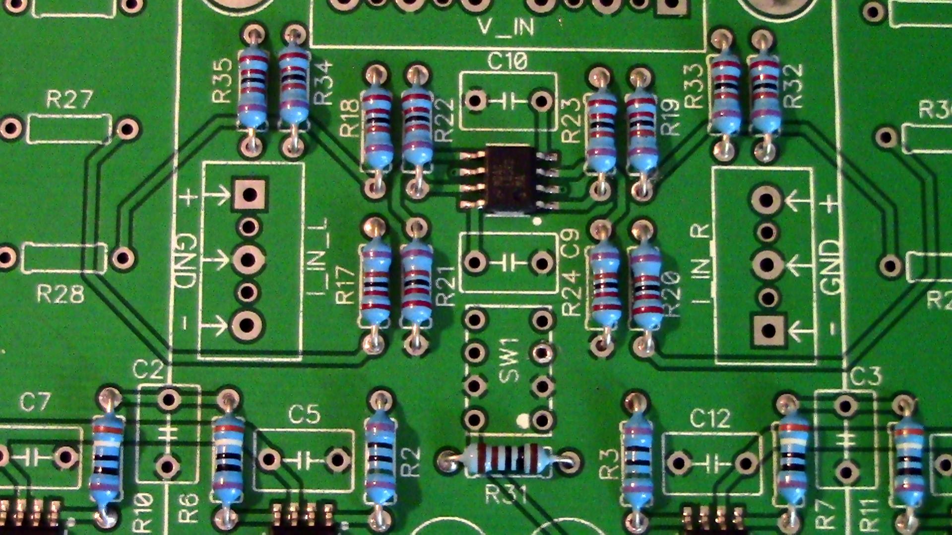

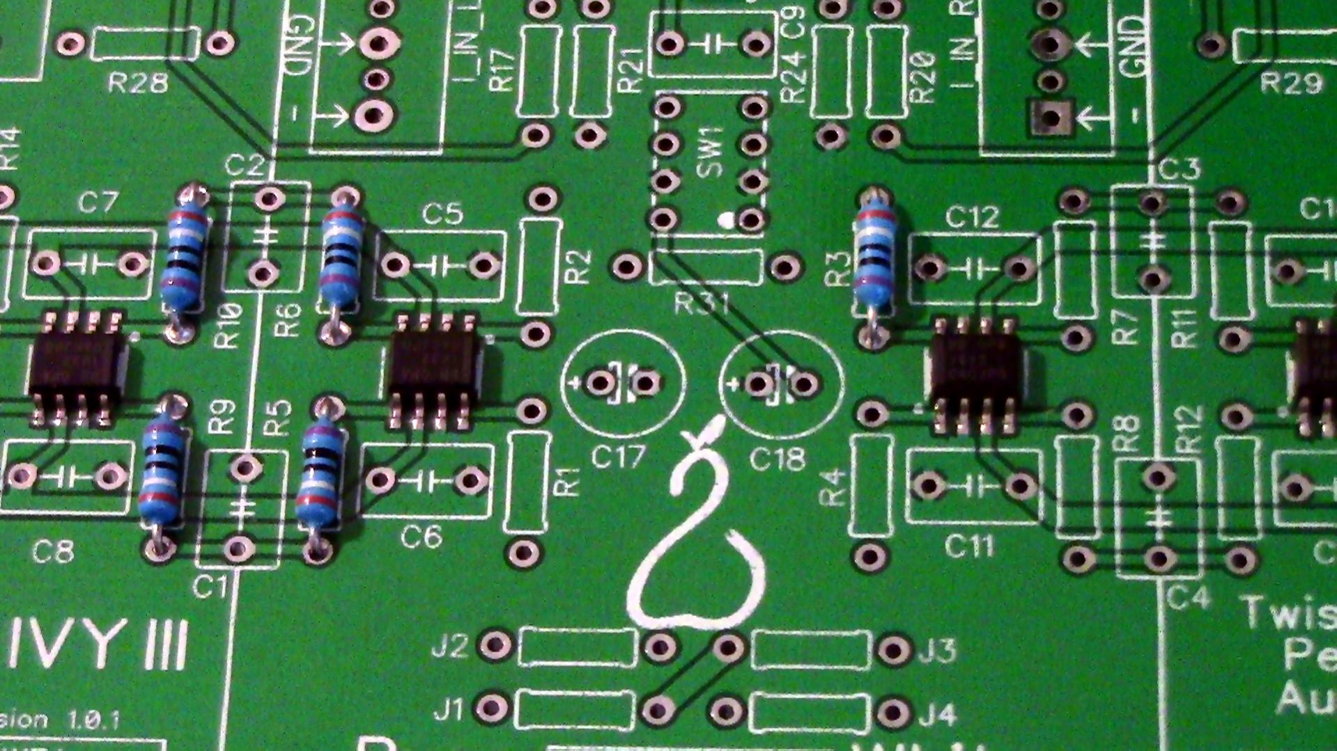

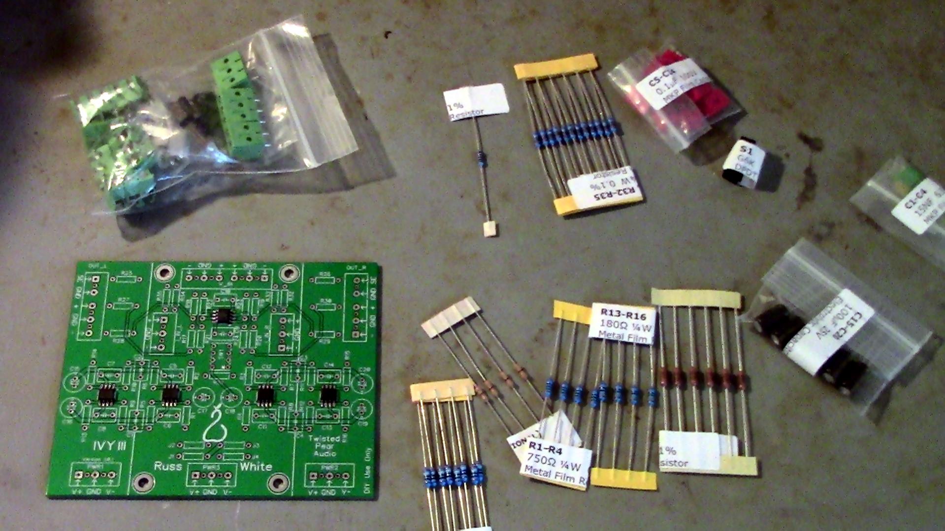

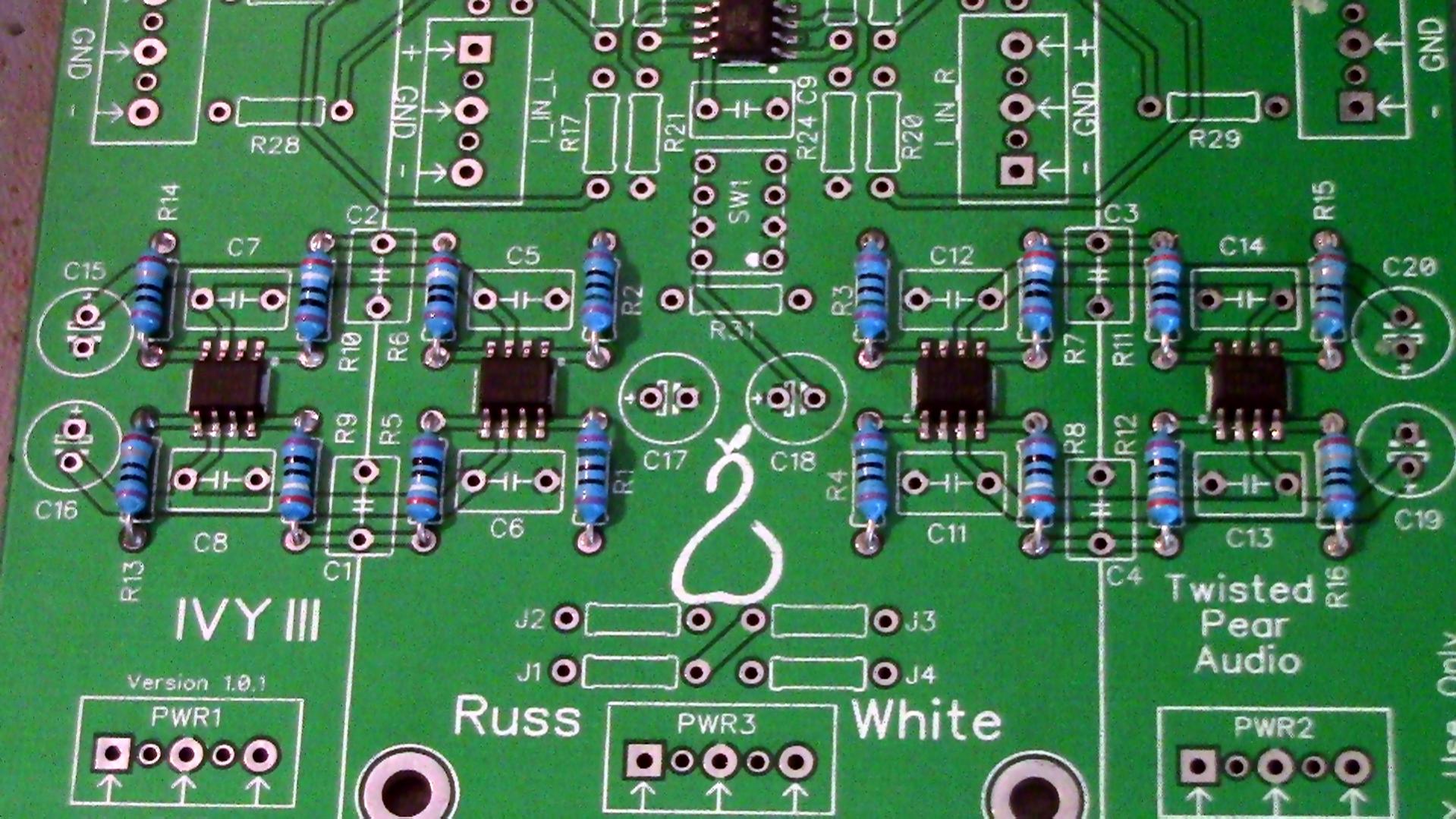

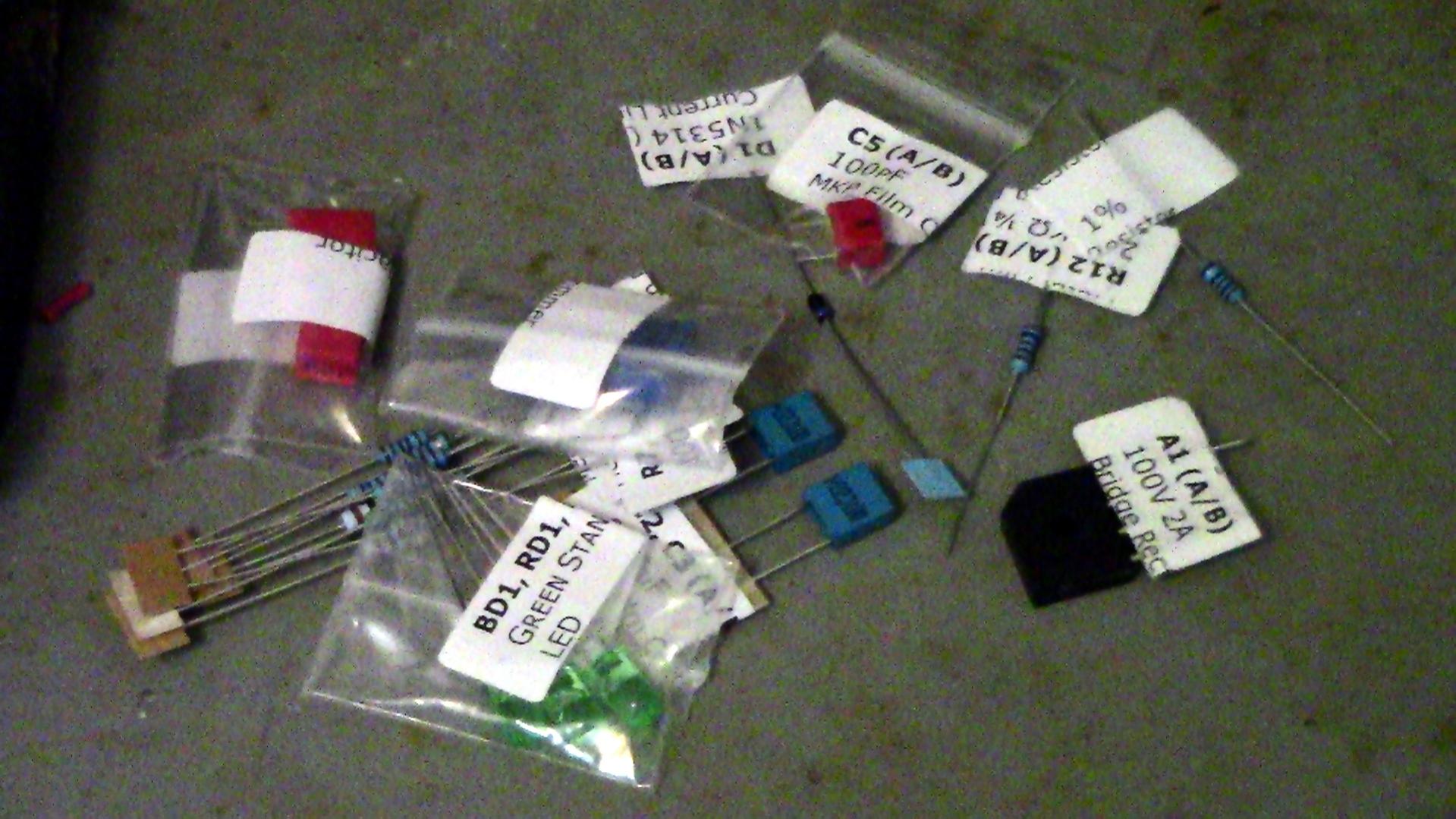

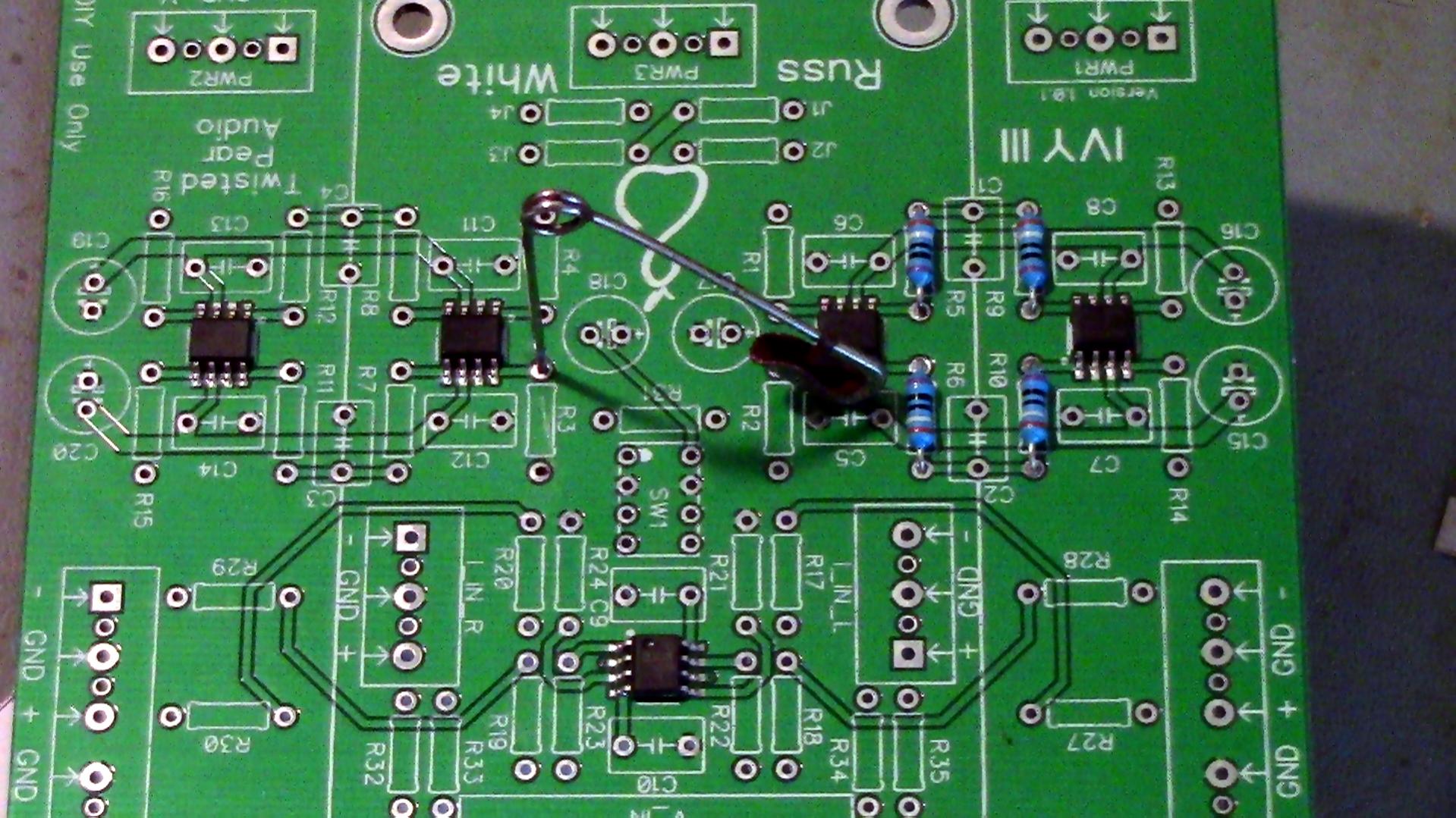

IVY III: kit and templates
IVY III is not really hard to assemble, but there are a lot of different resistors, so keeping track of these is the main thing. In the manual, there is a nice color coded guide to help give a visual layout of the different resistor positions.
As there where so many resistors, I created a little bending guide, so I could get the resistors better centered.
Lots of resistors
Even with the visuals, at first, when the board is blank, it is easy to solder a resistor in the wrong place (1st photo). My mind can play tricks with systematical patterns like this...
After un-soldering the resistor, the hole was filled with solder. As I do not have any wick, I heat the solder up and push it thru with a large safety pin. The solder does not adhere to the pin, so this works well. Also, the pin does not go completely thru the hole, so it does not poke my fingers either. 🙂
As the board gets populated, it gets easier to place the resistors in the right spot.
Also, this time around, I wanted to arrange the bands on the resistors into a symmetrical pattern. It is almost perfect, except for two pair on each side. 😱 Can You see which pairs? No biggie, as the pattern is still symmetrical anyway...
Sorry you had trouble with the Placid. Version 1 has design defect. You should throw it out and either buy latest version or use another design dual supply.
My first placid BP v1 failed completely, made a weird noise every couple seconds. Some kind of oscillation my tech couldn't figure it out.
I had another v1 kit on hand so I just chucked the old one and built a new one. It lasted a few months, then it's voltage was all over the place. I kept a voltmeter connected to it all the time, I checked it every couple hours, it would change sometimes dramatically every hour.
I searched for solutions, finally found some reference to design issue on their own forum. I made my own simple dual supply with Belleson regulators.
A couple years ago I built a Buffalo2 for a friend using newest Legato and newest Placid, it works very well and is stable.
Good luck
Rich
Good luck
Rich
