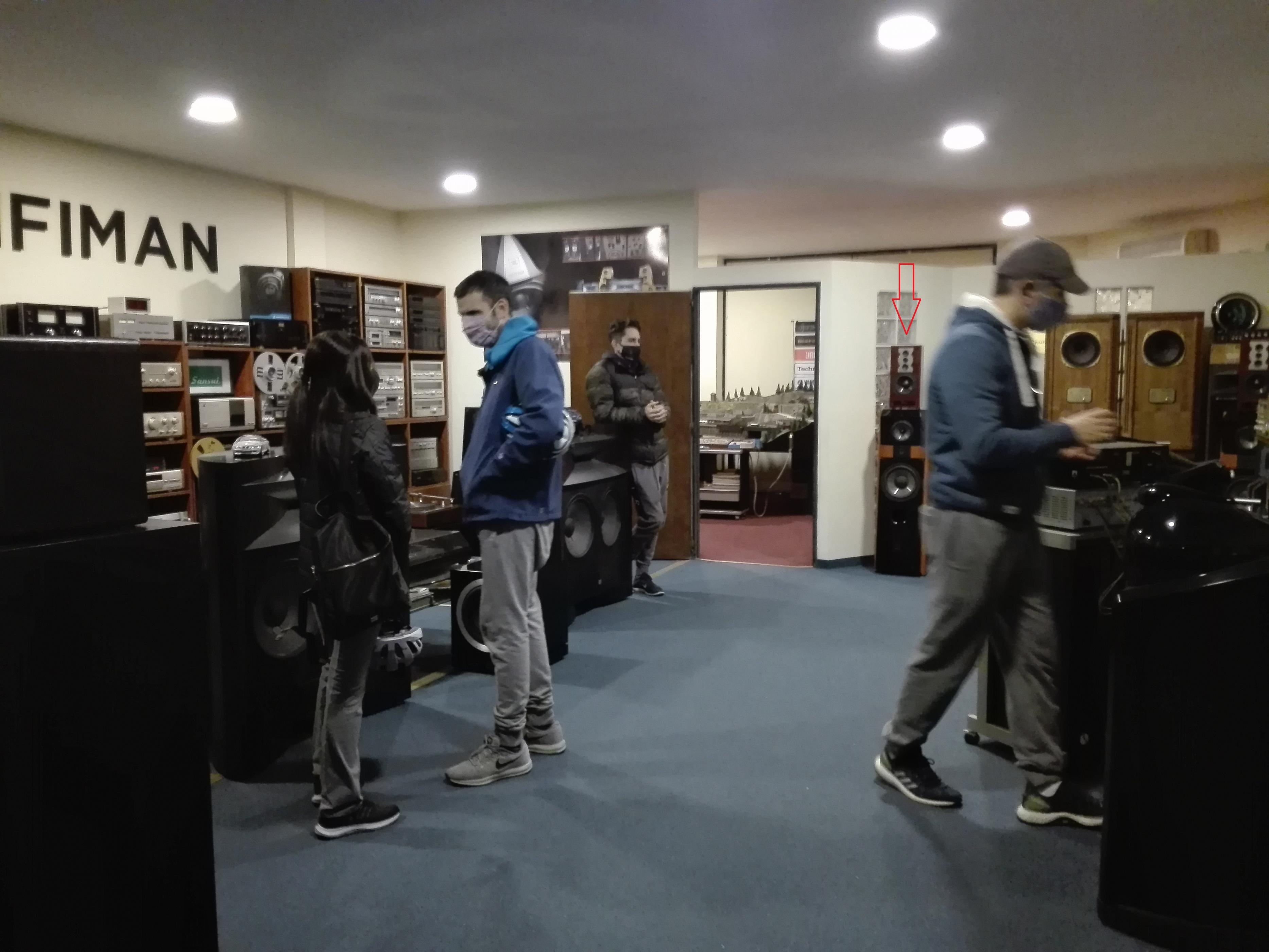

A visit to gratify the eyes and ears !
jjasniew say
" OK, maybe I could drive the 18" assists with it, but, what a waste of a gorgeous amp like that for a <100Hz job."
Well, I didn't ask the price of the mammoths, (for what?) But surely the class D amplifiers that guys use for PA will do their homework and maybe better if they have DSP, in fact I feed two 18 "subwoofers with Bheringer NX3000D , and I have saved some good money ........😉
Is it the same to travel in a Rolls Royce as in a VW "beetle"? The two fulfill their task fully, they transfer you from one place to another, but there are people who can pay some extras while the trip lasts .....
This video was recorded by me 😱 , it is easy to perceive that the microphone of the smartphone is saturated when I approach the right sector, it can be clearly distortion.
As always, appreciating the real sound recording audio with YT is impossible, but in this case it is worse from what I tell you, I assure you that they sound very, very good!
On the next visit I will use a tripod located in the sweet spot !

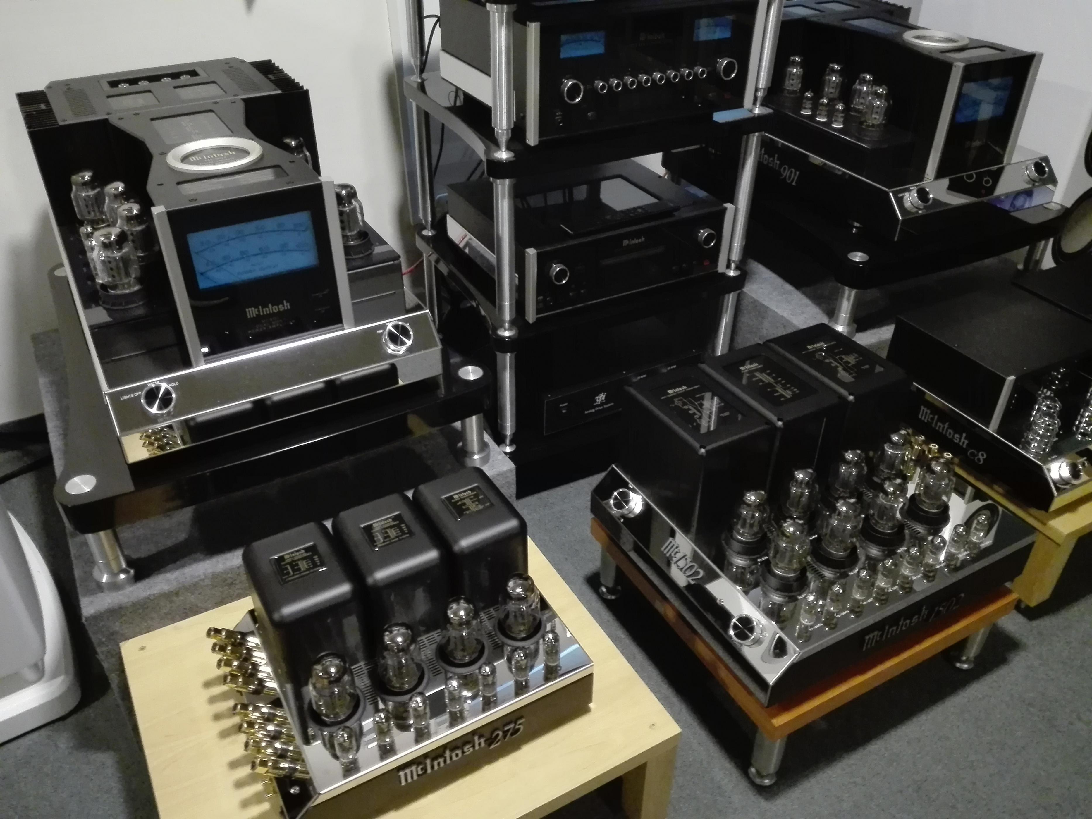

MC 275
Power Output per Channel
75W @ 4, 8 or 16 Ohms
According to the opinions of many people about MC Intosh, their "secret" was the development of the "special" transformers that they use, even in the SS amplifiers.
Many years ago it occurred to me to make a "clone" of Mk 275, and when I studied the circuit and made consultations with very expert local winders, (who are no longer around) they told me that they couldn't do it. However, I had an EI transformer built to order with iron sheets / grain oriented, two taps, etc. But they got there.
Silvio gave me their names, but I forgot them, surely someone from the forum can refresh my memory.
And they must have something exclusive, because a conventional output transformer does not deliver the same power with different loads .......
The MC Intosh solution is called "Autoformer"

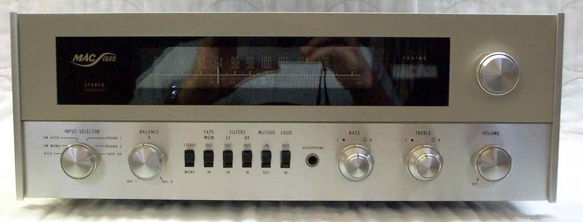

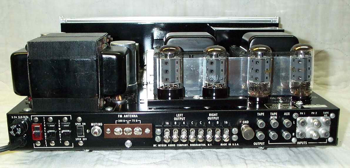

The MC1500 has the same output transformer "type" as the MC275, the one with the cathode windings. I've seen articles where you can change the output tubes and get more power, but I'm not going to molest the unit to do that. I think the output tubes are along the lines of 7591, but more power is achieved than would be usual via the transformer design. It's fine by me as-is ;')
I see you have an output transformer with windings for 4-8-16 Ohms. If they are the famous "autoformers" the power delivered in any connection should be the same, as the specs of the Mc275.
Yes, the tubes output are 7591, not KT 88 as I thought.
